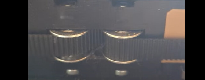

My belt idler pulleys are a bit noisy. Is this normal? Seems to mainly happen on deceleration.
Video:
For squeaky idler noises… That seems normal to me. Previously had couple of squeaky Idlers that was easily resolved with a quick drop/spray of food grade superlube, which I also use on the EMT where bearings contact. Since then, I preemptively give the Idlers a quick spray after initial assembly.

Have the squeaks always been there, or developed over time? Noticed some debris resting on the Y axis idlers that are squeaking…
If this is a common situation for people, maybe a simple dust deflector/guard/fenders would help reduce how frequently the idlers need cleaning and lubing.
I had the same problem that you have, but it was more than a little rattling when the teeth would grind the top of the idler. I think the belts should be seated 0.5mm lower in the belt holders, but could never verify. :smiley:
I actually messed that up: the idlers need to be higher or the belts lower. It was just on Y-max on mine though.

I didn’t, you can’t. The belt holders would have needed to be lower.
Your saying the belt holders mounted to the table are the wrong height correct? Not the idlers/motor alignment in the YZ plate. If it was the later then moving the gear on the motor would fix the misalignment so my assumption in the first part :slight_smile:
