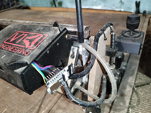

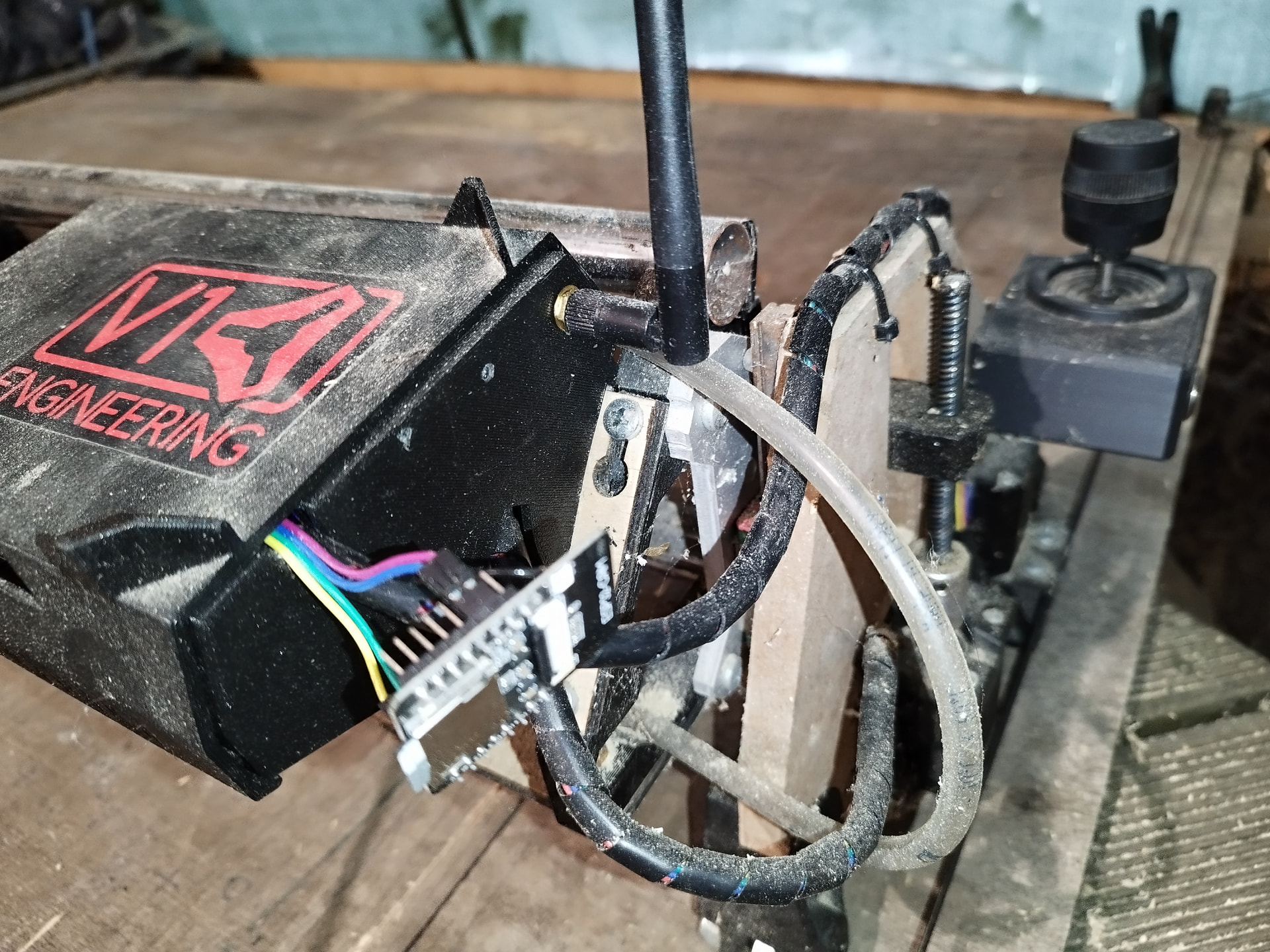

I replaced my LowRider 3 TFT with an ESP32-CAM web pendant
My LowRider 3 TFT display stopped cooperating, and since I had an ESP32-CAM module lying around, I decided to see if I could replace the TFT with a small web-based controller instead.
The basic idea was simple: the ESP32 talks to the SKR Pro / Marlin controller over serial, and at the same time serves a mobile-friendly web UI from its SD card. So instead of using the TFT, I can control the CNC from a phone browser.
After a couple of days of tinkering, the first working version is now running on the machine.

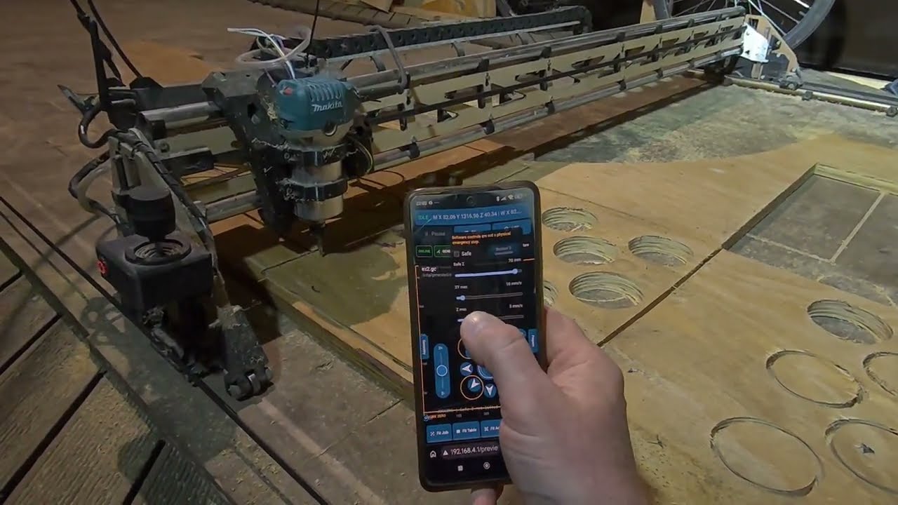

At the moment it already supports:
  • ESP32-CAM to Marlin serial communication
  • mobile web UI served directly by the ESP32
  • SD card file browsing, upload, download and delete
  • G-code preview in the browser
  • work zero capture
  • job JSON sidecar files for storing job setup
  • bounding box / dry run checks
  • arming a job before running it
  • basic job start / pause / stop work in progress
  • feedrate override is planned/being added
  • a top safety drawer that opens by clicking and keeps quick controls available
The safety drawer is something I really wanted on a phone UI. When standing next to the CNC, I do not want Pause, Stop or M5 hidden somewhere deep in a page. The drawer is always available at the top, and clicking it opens extra machine controls such as position, homing and zero-setting controls.
The normal workflow is becoming something like this:
  1. Upload a G-code file to the ESP32 SD card.
  2. Open it in the mobile preview.
  3. Check bounds and warnings.
  4. Jog the router to the intended work origin.
  5. Set work zero / Z zero.
  6. Run a bounding box or dry run.
  7. Arm the job.
  8. Start cutting.
One interesting thing I ran into was FreeCAD outputting G54 by default. I originally tried to remove it, but FreeCAD seems to expect a work coordinate system there. So the current plan is to treat G54 as the normal/default workspace, and have the ESP32 make the Marlin state explicit before starting a job by applying G54 and G92 in the correct order. That way the file uses my chosen work zero instead of accidentally starting from the machine/home origin.
This started as a quick replacement for a broken TFT, but it has already grown into more of a small CNC pendant / job controller.
The code is already on GitHub here:
https://github.com/MarkoNiitsoo/CNC-ESP32
It is still experimental DIY CNC software, so it definitely does not replace a real physical emergency stop. I am testing carefully and doing air runs before trusting it with real cuts.
