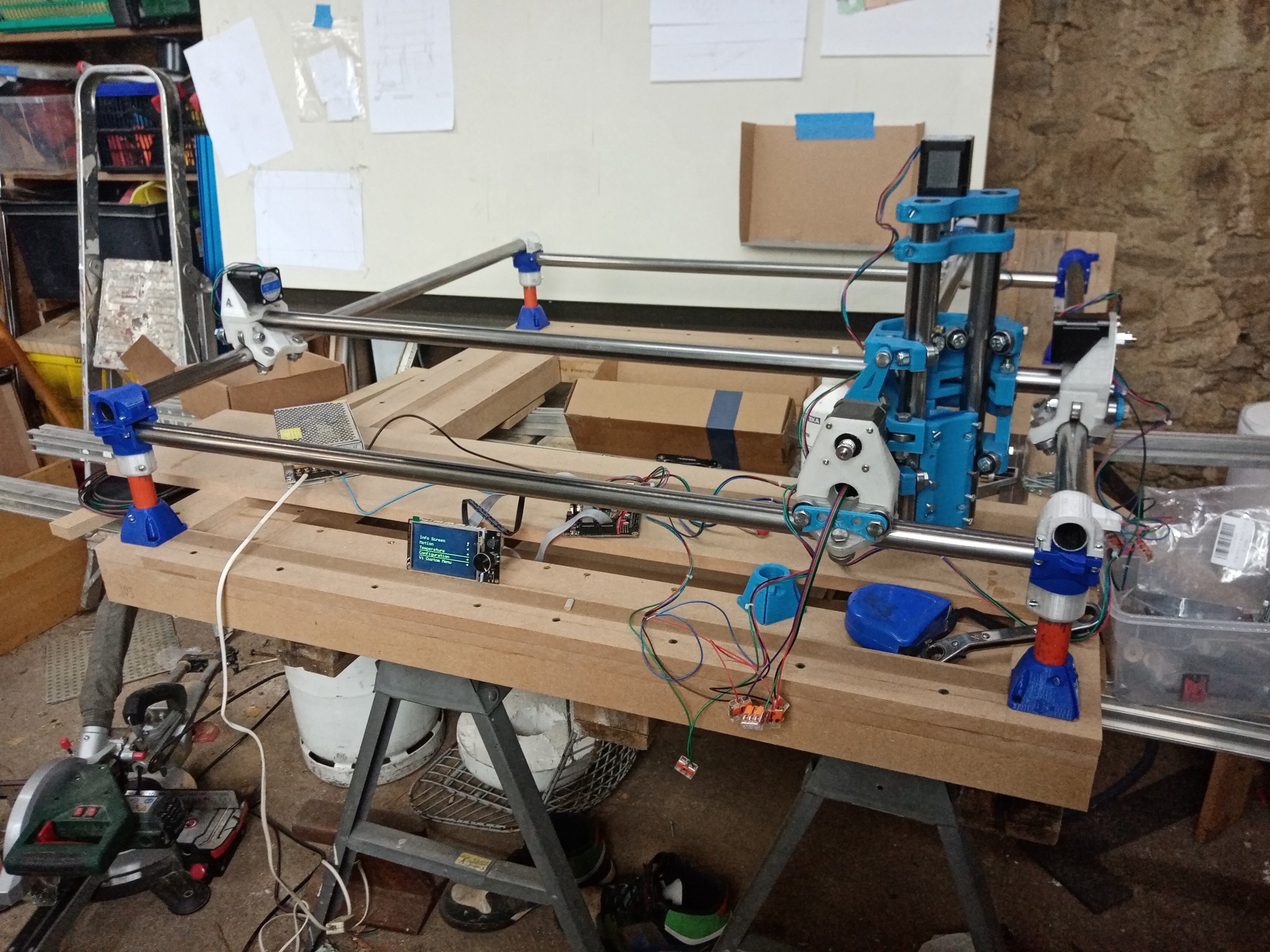

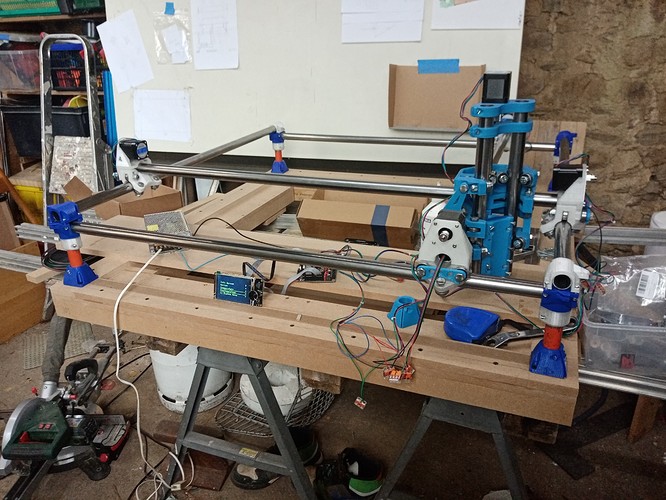

Well another improvement, I did a series cable for the motors!! WORKS :sweat_smile: :wave: :metal:

Does that screen have Marlin mode (and two gray cables?). You could probably get along fine with that.
Hi!
2 grey cables and one black. i connect it to the mother board and try to use the motors manually, no results.
i think it has merlin mode
If you hold down the knob, it should ask to go into Marlin mode. Then only the knob will work, not the touch screen. If you can use that, then you are all set.
Hi!!
Yes i can control with the Marlin in the TFT.
I guess now i need to set it up all together in the table and try to move all the parts?

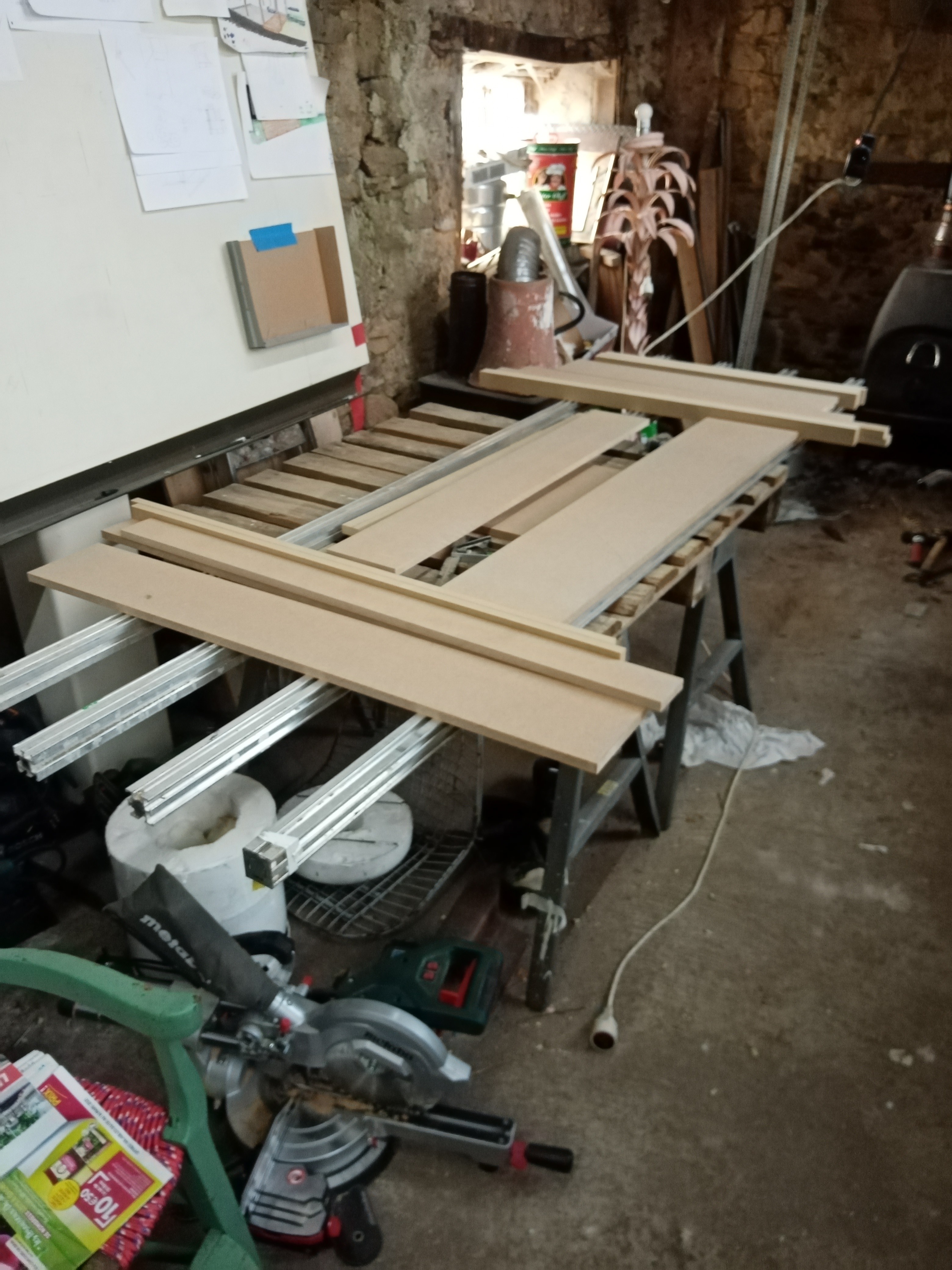

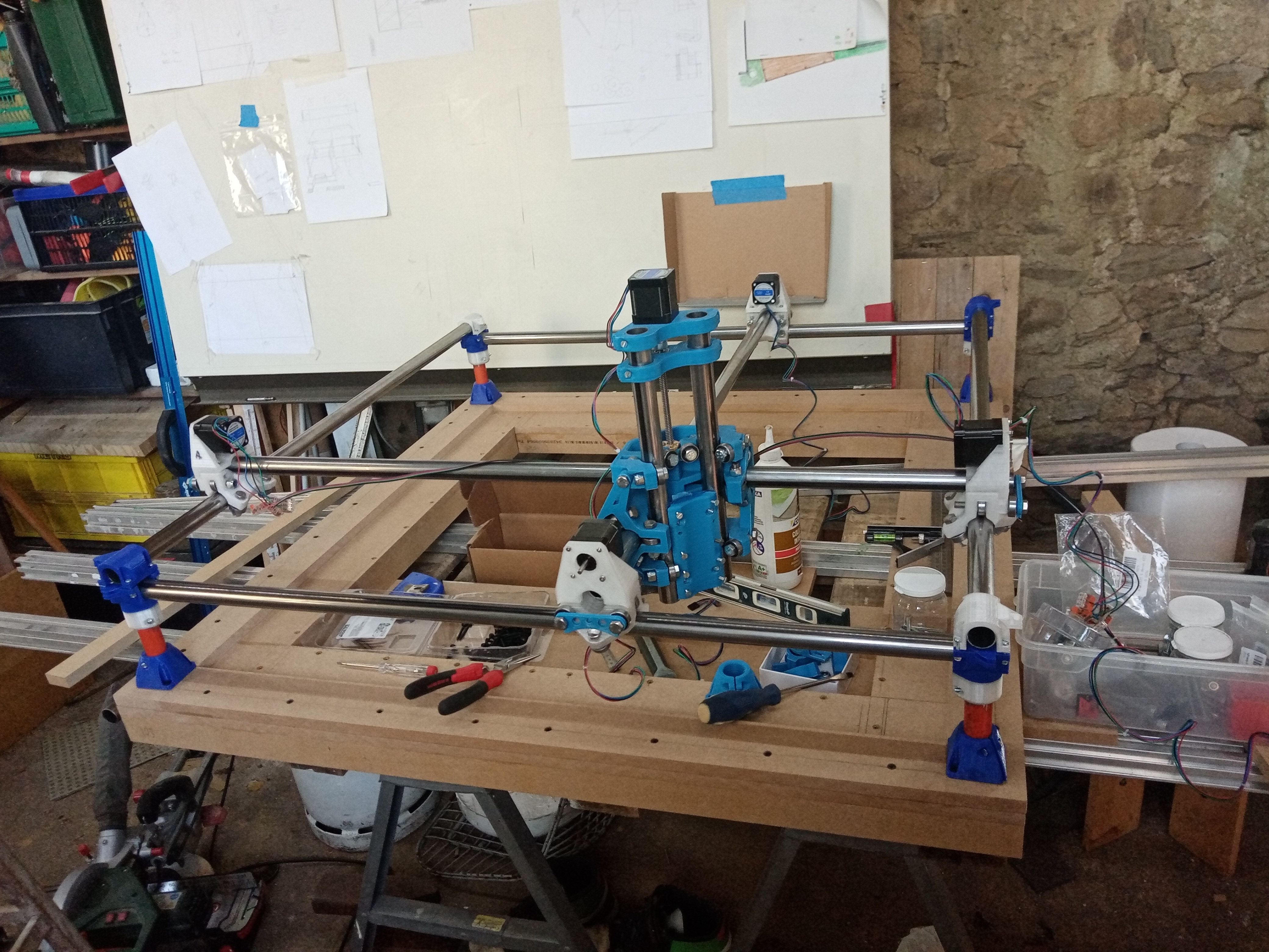

I´m back on track!! i was busy with my daughter!! She had a week of at the kindergarten!!
So I got the base, the cables set up and i tested the motors, they work and move, I need to prepare the final set up of the components!
I´m having a lot of fun and when i see the motors moving correctly we nice!!
thanks

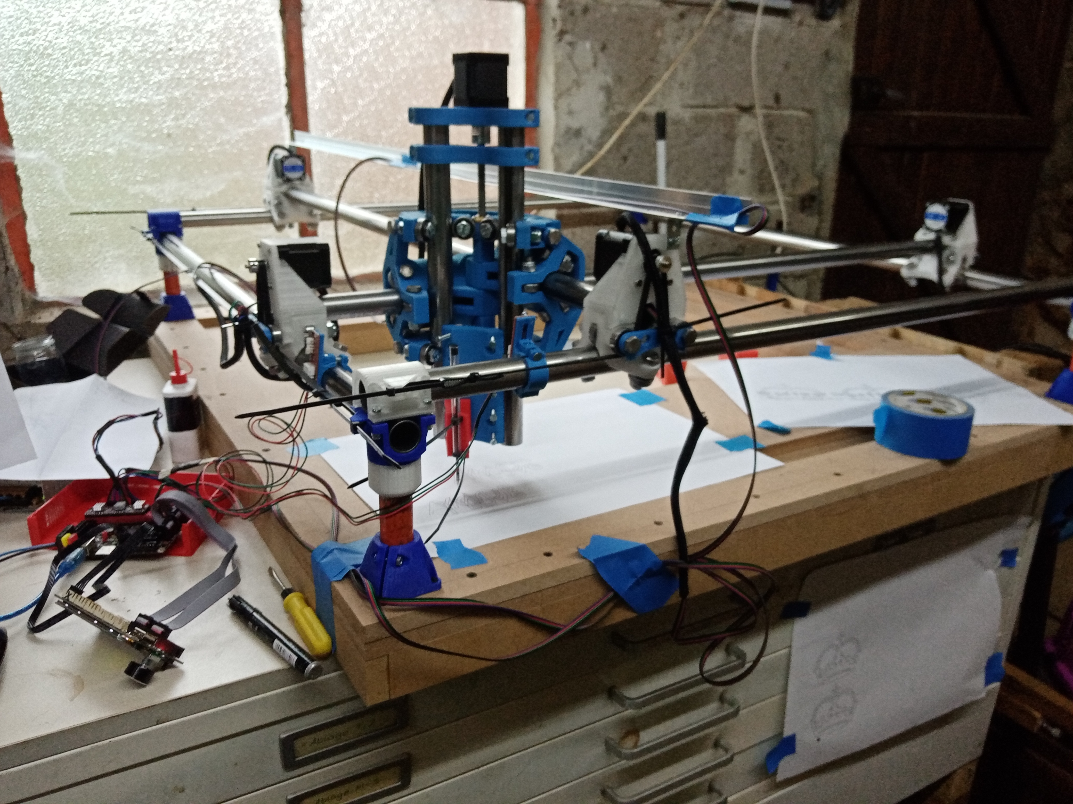

HI Guys, GREAT NEWs!! I did it!!! is working.
I clear a spot on my workshop and install a PC next to it, with the pen works fantastic!!
I’m learning a bit of fusion 360 to be able to produce some milling noise!!
The first im using is “Estlcam” to get use to the workflow.
Thanks a lot for all the help!!

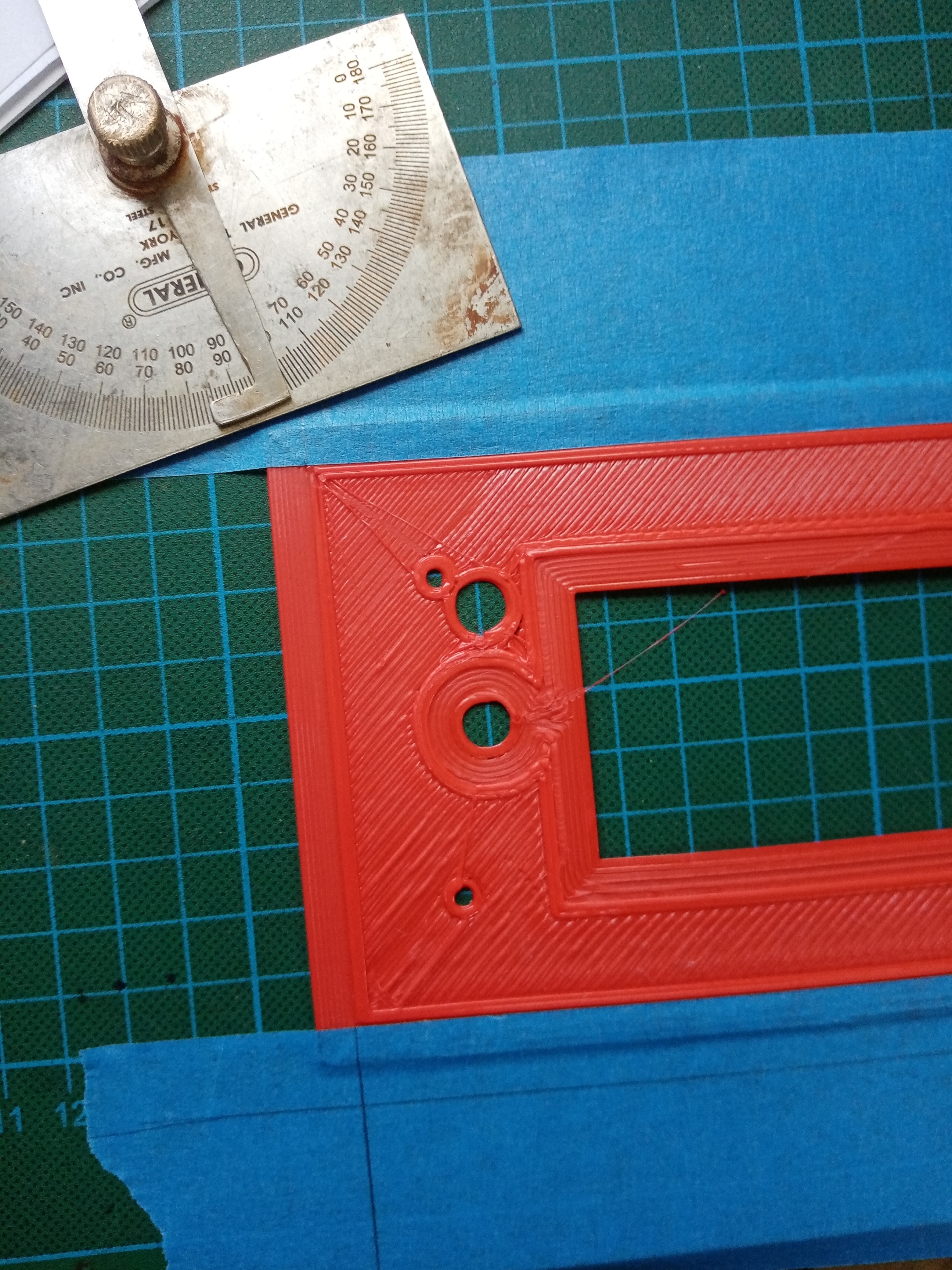

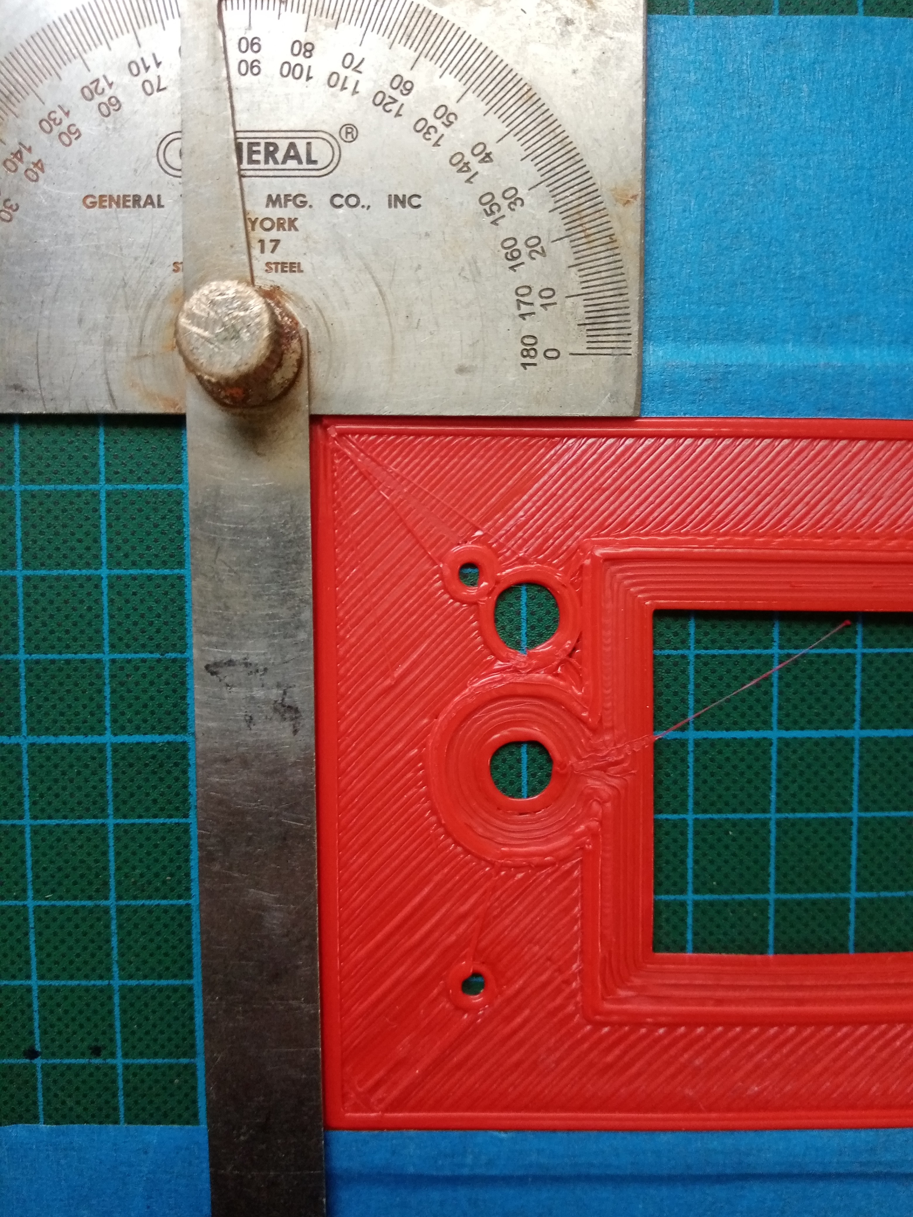

Hi guys!! i have another Question !! Is regarding my Anet A8.
I’m printing the box for the motherboard and controls of the CNC, the box is not to big but ani time i print is offset to the back.
Did you had this problem?
Thanks

Hi
is any project, when I go big like a box 120mm by 90mm and 25mm highs.
the front of the box and the back of the box has a displacement.
So: more or less is 1,5 degree but is not square, i check the tension on the belts and all the stability od the printer.
Thanks
OOPS I understand.
It looks like x and Y axes of your printer are not perpendicular.
Unfortunately I don’t know the Anet A8 printer so I can’t make a suggestion for you.
I hope someone else will help you.
