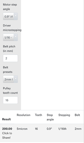

This calculator says 25 steps per mm, assuming youve got 16 tooth pulleys.
I think it should be 12.5
400 steps/turn * 1turn/16teeth * 1tooth/2mm = 12.5steps/mm
You should be able to get some stuff done with that, but I would prefer going to at least 8microsteps/step, if not 16/32.

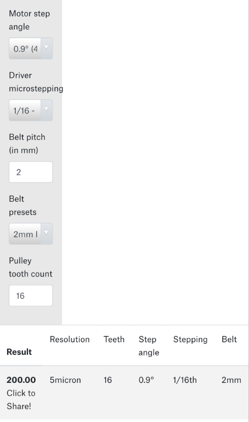

Steps per millimeter - belt driven systems
2mm pitch
6mm width
0.9 degree stepper motor
1/8 driver microstepper
16 pulley teeth
What that result number for?
What I do with it?
  1. When I choose 1/8 microstepper
    Result show me 100
  2. When I choose 1/16 microstepper
    Result show me 200
Which is correct result for MPCNC?
Those results look correct, I think the 0.9 degree steppers provide slightly less torque, I would try 8 steps first.
you mean try 1/8 microstep?
Yes, try 8 microsteps first, that’s 400 X 8 per revolution.
