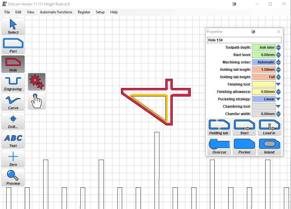

I’m attempting to follow the solution listed in this thread, but it is just not working. I’m using Estlcam 11.111. Here are the steps, along with screenshots below. Can anybody tell me why the pocket is not working?
Select the inner piece of the "4" using the part tool.
Select the outer piece of the "4" using the hole tool.
Select "Island" on the properties box. Everything inside of the outer "4" outline becomes red.
Preview shows that material inside of the inner "4" outline will be milled as well.
That probably has to do with the thin wall. Probably not considered a island in the software if the path overlap? Do all other islands work for you? You can try a quick test, scale it up 20% and see if it works then, if it does not perhaps the paths are not closed.
Yep, it was too thin. That was the first island I tried, so I never would have figured it out since it seemed the feature just didn’t work and I was already investigating other software packages. Thanks for the quick and insightful response!
Still, that seems like a bug. I would report it to Christian.
As a workaround, You could also connect the thing so a regular pocket would work. If the hole path went around the outside, then across a little bridge, then around the inside, I think a pocket would work.
