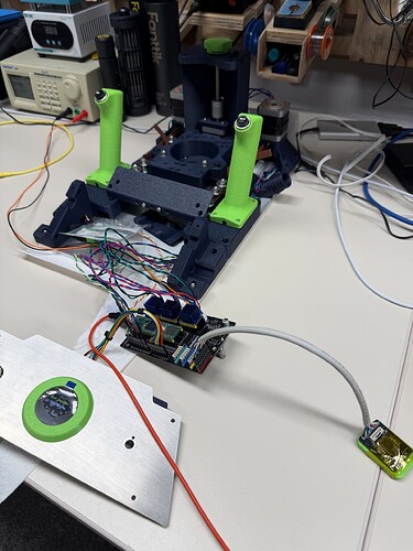

Hi all,
I built a handheld CNC and I’m now trying to wake the monster up — but I can’t get any sensors to be detected. Maybe I bought the wrong ones, maybe all my PCBs are faulty, or maybe someone just doesn’t want me to use this awesome machine :wink:
How can I figure out what the actual problem is?
Is there a debug version of the firmware for the Arduino Mega so I can see more detailed information? Right now, the only thing I see in the serial monitor is:

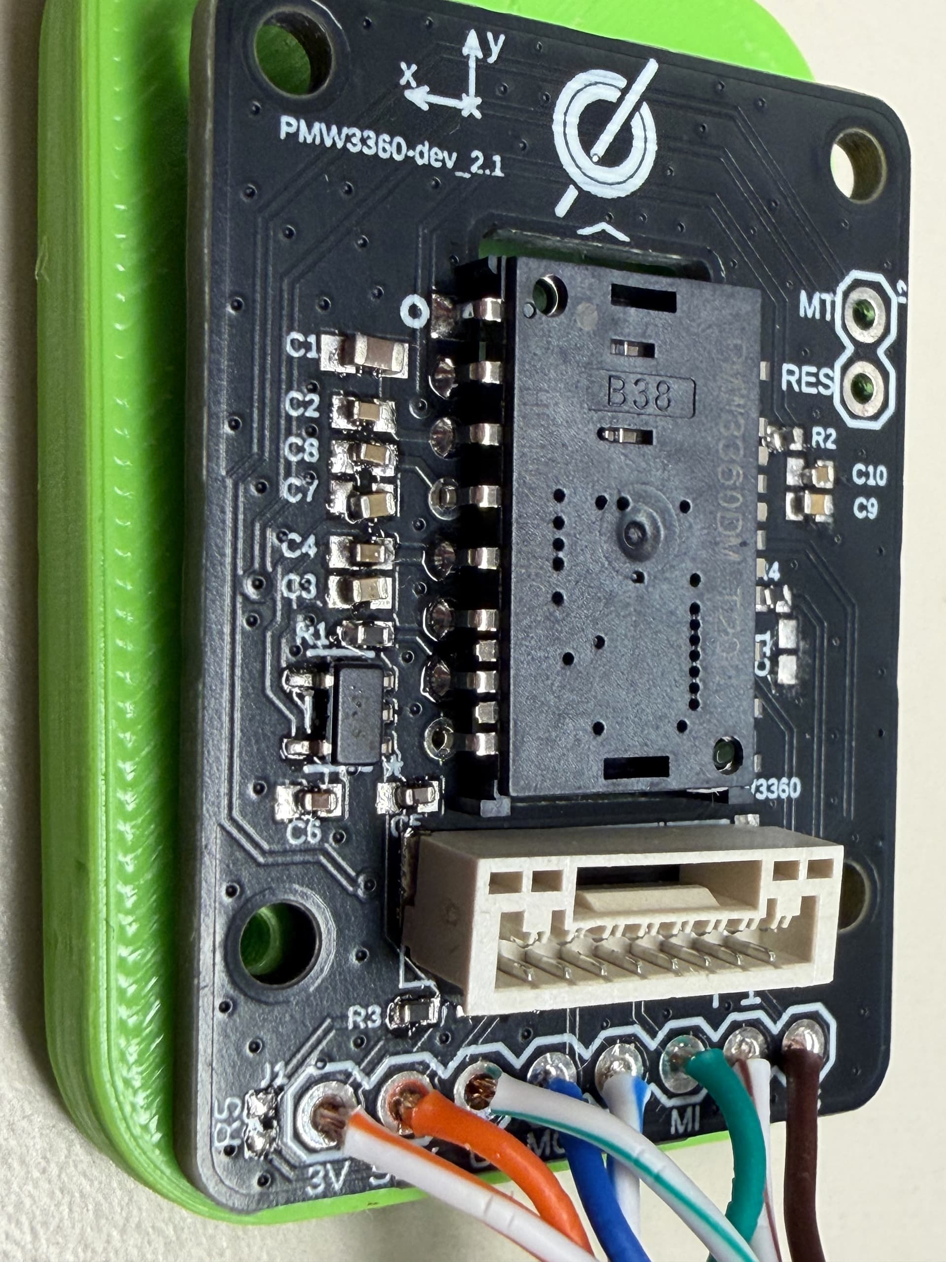

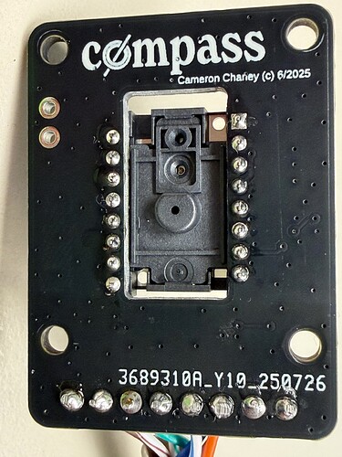

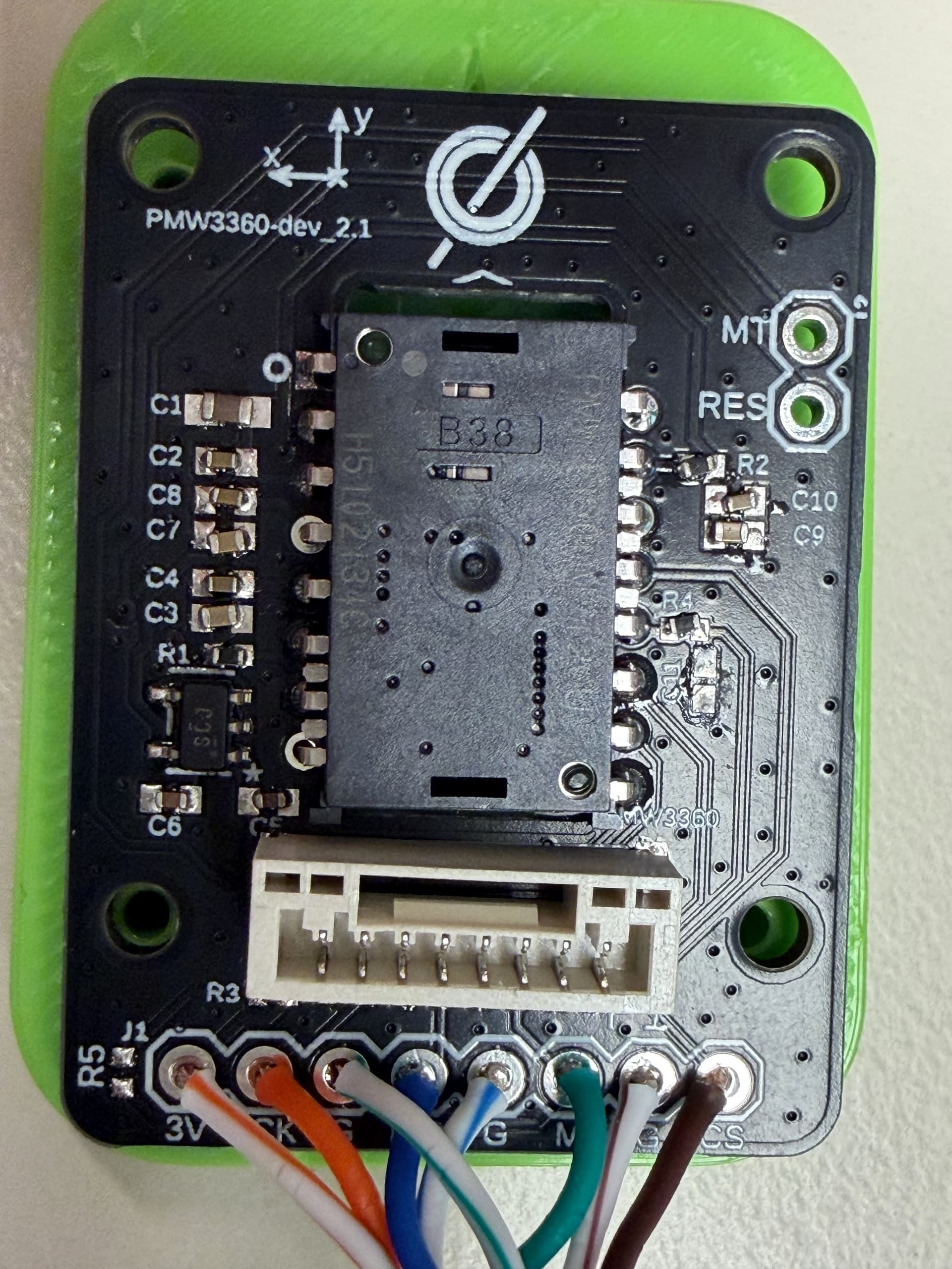

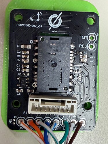

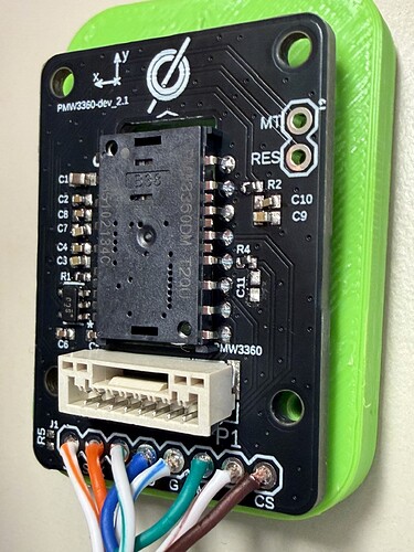

Hi @smuk3d, can you please attach a close up picture of the sensor PCB with the soldered sensor? From what I can see, the wiring looks correct, so maybe there is an issue with the chip soldering.
Hi,
here some shots .. hopefuly good enougth.
Did some serious debugging and checked all the resistors on the PCB. Found a few that weren’t soldered properly. Re-soldered everything — and now the first sensor is working! I’ll go ahead and re-solder all the pads. Might’ve been a bit too stingy with the solder paste.
More updates to come :wink:
Awesome, great to hear! And thanks for those pics. I can definitely see how a cap or resistor could be messed up while hand soldering those. Good on you for going that route, though. I respect it
Looking forward to more updates!
