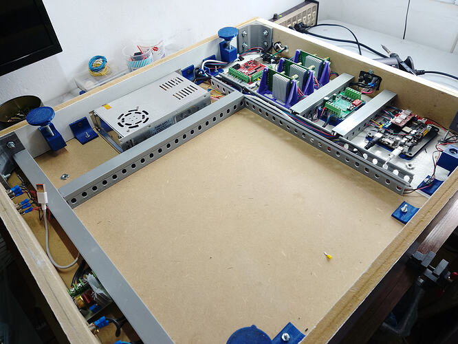

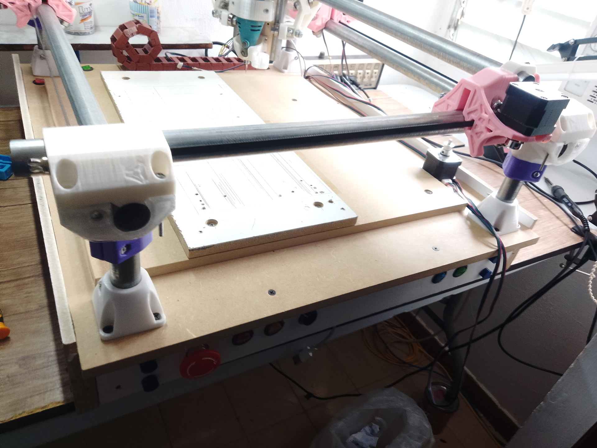

I built an MPCNC and I am using a red Mach3 USB controller board with 6065 drivers. The motors are NEMA 17 series 4401s. The belt system is GT2, 6 mm wide.
I am working with a maximum speed of 498.02, and I am using a Dremel as the spindle. When cutting or engraving 3 mm MDF, it starts to lose steps. I have been getting help from ChatGPT, but when I go deeper into the cut, the machine loses steps.
I am using 23.5 mm tubes, and the bearings are 608 ZZ ball bearings.
At this point, I am not sure what else can be adjusted in the structure.
Greetings, Eduardo.

You haven’t told us enough yet about your machine and build so I’ll ask some more questions.
That’s not a board we use here on our machines very often if at all, so we’ll need to know more about the board and how you have it configured. A few questions at first:
What power supply voltage are you driving your steppers with?
What drive and hold current is configured for your stepper drivers?
Do you have a link to the actual part you are using? If, for example, you used a 17HS4401, these are too low torque for most of our machines, and to even get that torque they need 1.5A of current, more than we typically configure for.

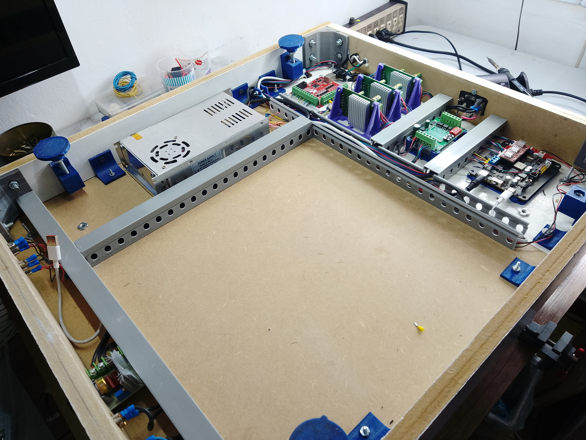

The drivers I am using, if I am not mistaken, are TB6065 rated at 3A, configured to 1/16 microstepping. I am running 2 drivers per motor on the controller board. Each motor operates between 1.2 and 1.5 A.
For the X and Y axes, I have 2 motors per axis. On the Z axis, I am using an 8 mm lead screw with 4 starts.
To power the motors, I use a 24V 30A power supply, and for the rest of the electronics, a 12V 8.8A power supply.

The machine works fairly well overall when it is not under heavy load. However, when I start using the Dremel tool, it begins to lose steps. I am not sure if this is due to the belts, which are 6 mm wide.

I’m not sure how to parse that. Each TB6065 should be able to drive a motor directly, there shouldn’t be any need for two drivers per motor.
You still haven’t confirmed the specific model of stepper you are using. Looking at your pictures, you don’t appear to be using the higher torque rated steppers we generally advise for these builds. The recommended motors are .59 N*m torque.
Your build is extremely well organized, neat and clean. That looks great to me!
You could be losing steps because you’re trying to pull the dremel through the material at too high a feed rate. You might also not have sufficient torque in the steppers. What do the chips look like when you do a cut?

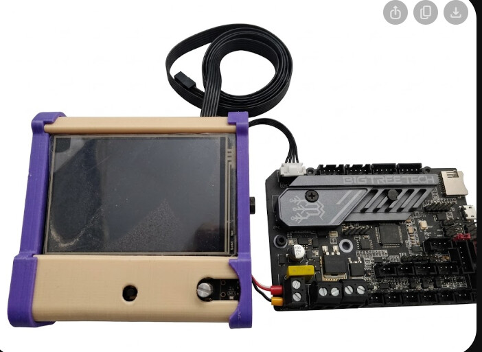

I have been experiencing problems with the TB6560 drivers. After some research, I found that they are not suitable for this system, as they support up to 200 microsteps, compared to the TB6600 drivers, which can operate with up to 1/32 microstepping, providing smoother and more stable control.
I also have other types of control boards available, such as the Arduino Mega kit and the boards used in 3D printers with A4988 or DRV8825 drivers, as well as the BigTreeTech board, like the one used in the Ender 3 V3 mini.
Which of these options would you recommend for this type of project?

Whatever you do, don’t buy the TB6600, they suck and are loud as hell. :smiley:
