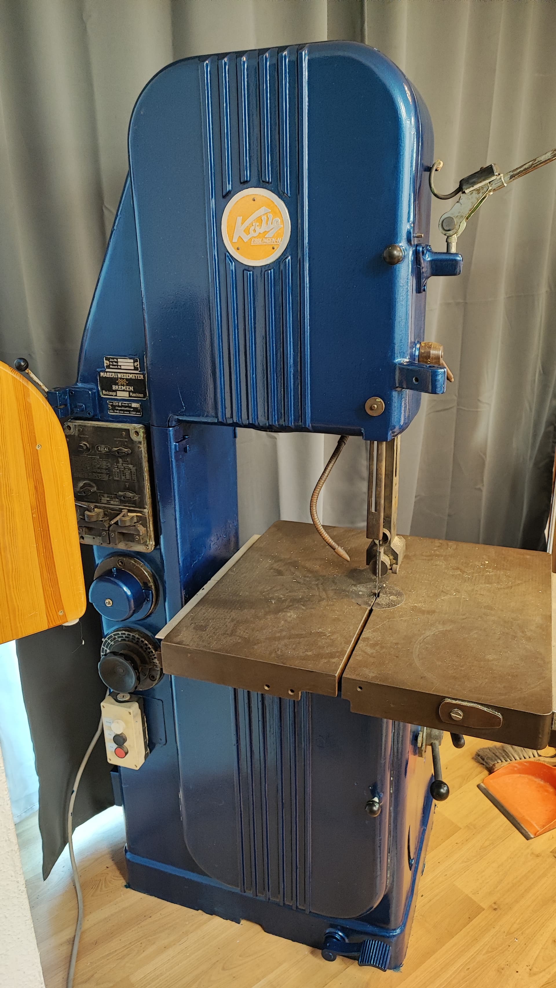

Okay, besides of a few places where minor touch-ups are needed, I’d say the painting is done.
Looks great, don’t you agree? :sweat_smile:
Pics or it didn’t happen

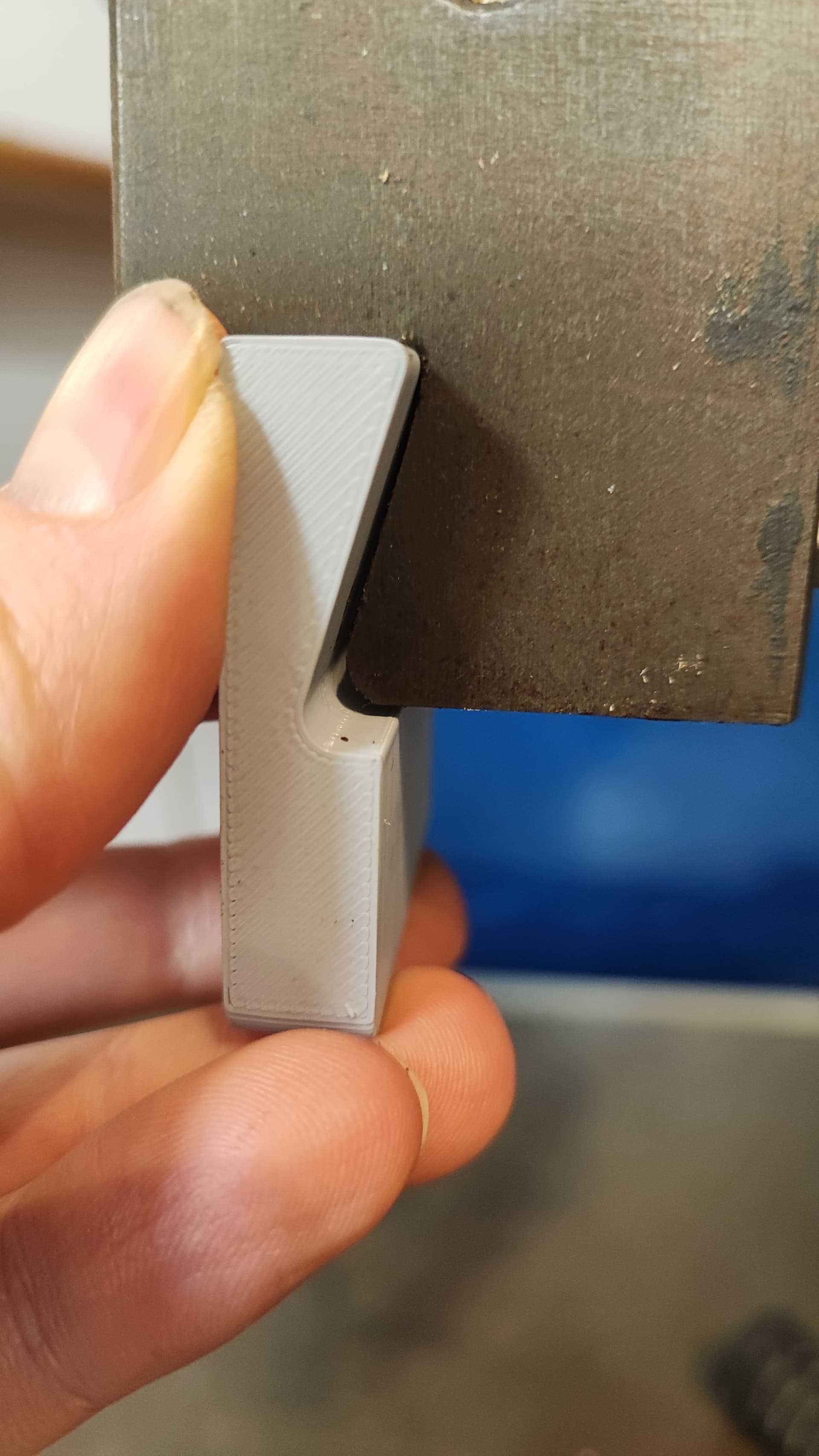

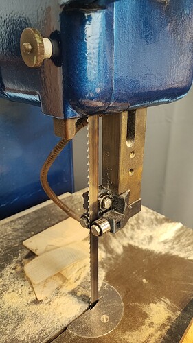

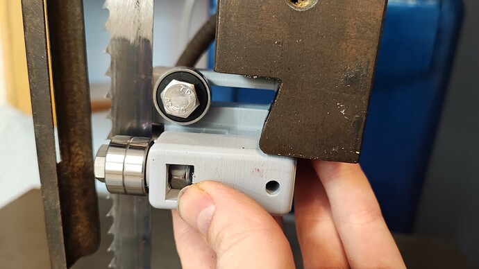

Working on the saw blade guide. The one currently installed is for cutting metal.
Changed a few things, testing the fit of the coupling. When I have such a massive beam, why not use it…
Mmmm… Hammerite… IMO, the best workshop paint, ever.
Totally agree, love that blue especially. And every idiot can get a good looking surface finish with it, just so easy to work with. Slather it on whatever surface, boom, you’re done. :smile:
Are you 3d-printing a blade guide ?
The load is minimal on them and I figured we are printing CNCs… Should be fine. :slight_smile:
Might get a bit warm though… :thinking:
If done right the sawblade should not really touch the guides, only a little. We’ll see about that. :smiley: At the moment the guide is a hunk of metal. :smiley:
You are correct of course - the bearings shouldn’t get hot.
Not 100%, but works for now. :slightly_smiling_face: I might need to print another one for smaller sawblades, but that’s in the future. :sweat_smile:
It’s just too great I bought the metal bandsaw accidentally. The Metabo 1688 I bought had messed up rails, the owner’s granddad cut the pipes with an angle grinder and it looked like shit. Now it looks better at least. :slight_smile:
I was finally able to procure a manual (loooong story). So if you want to read a German manual that is nearly as old as the US, here you go: Kölle BSM 40.pdf - Google Drive

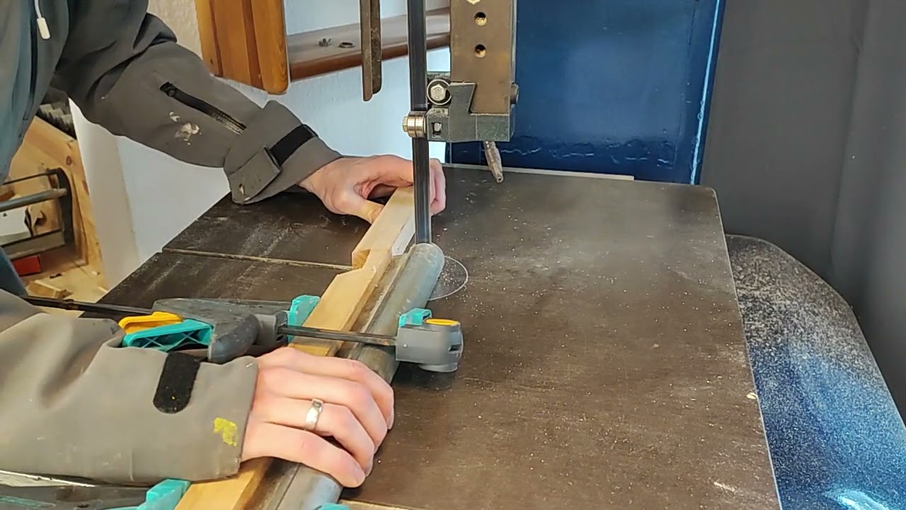

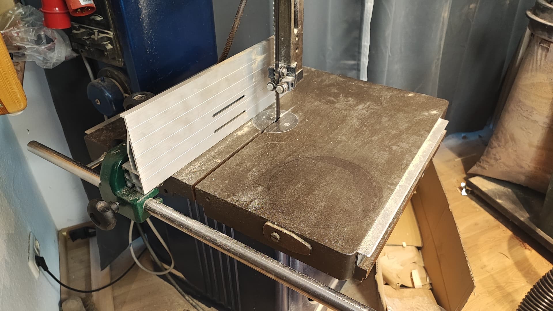

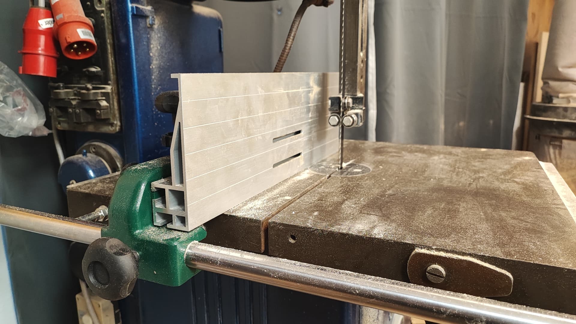

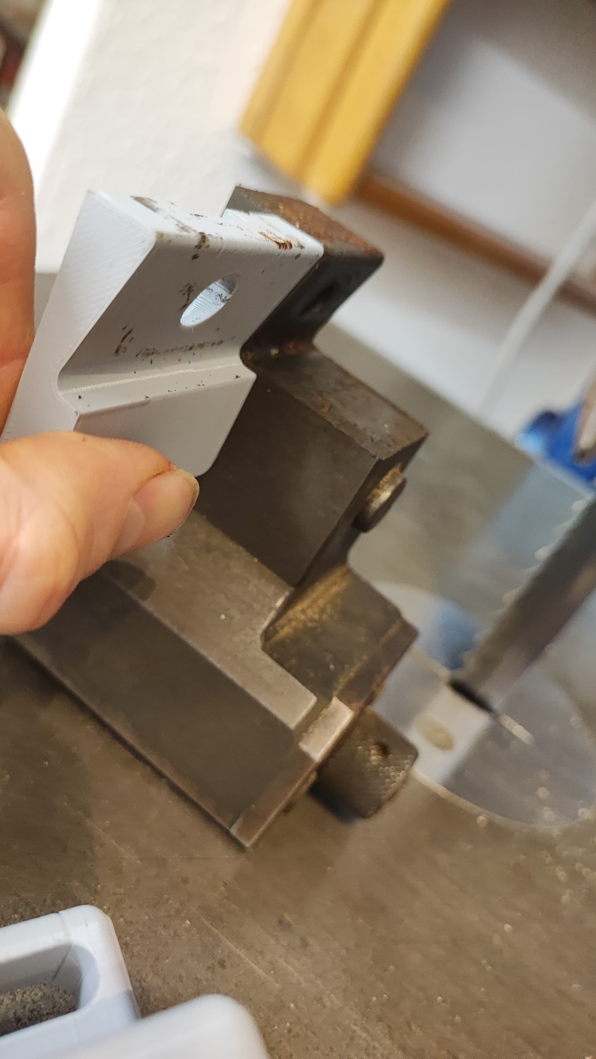

I installed a parallel fence as to make it easier to resaw wood and to be able to cut very thin wooden pieces, and what shall I say: it works!
What I can also say is: drilling through 2cm of cast iron takes quite a while. Since I was doing it while squatting (weird table height) and was concentrating so much I didn’t notice how exhausting it was. I had sore leg muscles for three days. It really hurt. :smiley:
The dark green clashes with the blue, but what shall I do? :frowning:
2mm, no problemo!
