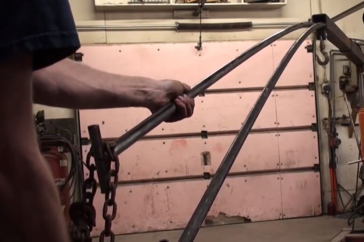

No personal experience but I did find this:
Thanks! I know that the “common knowledge” is that ERW has less tensile strength so isn’t preferred in chassis construction, but that video definitely makes it look like it would be more than enough for a 24" x 24" MPCNC, possibly even better than DOM. Which is definitely nice since it’s cheaper!!
