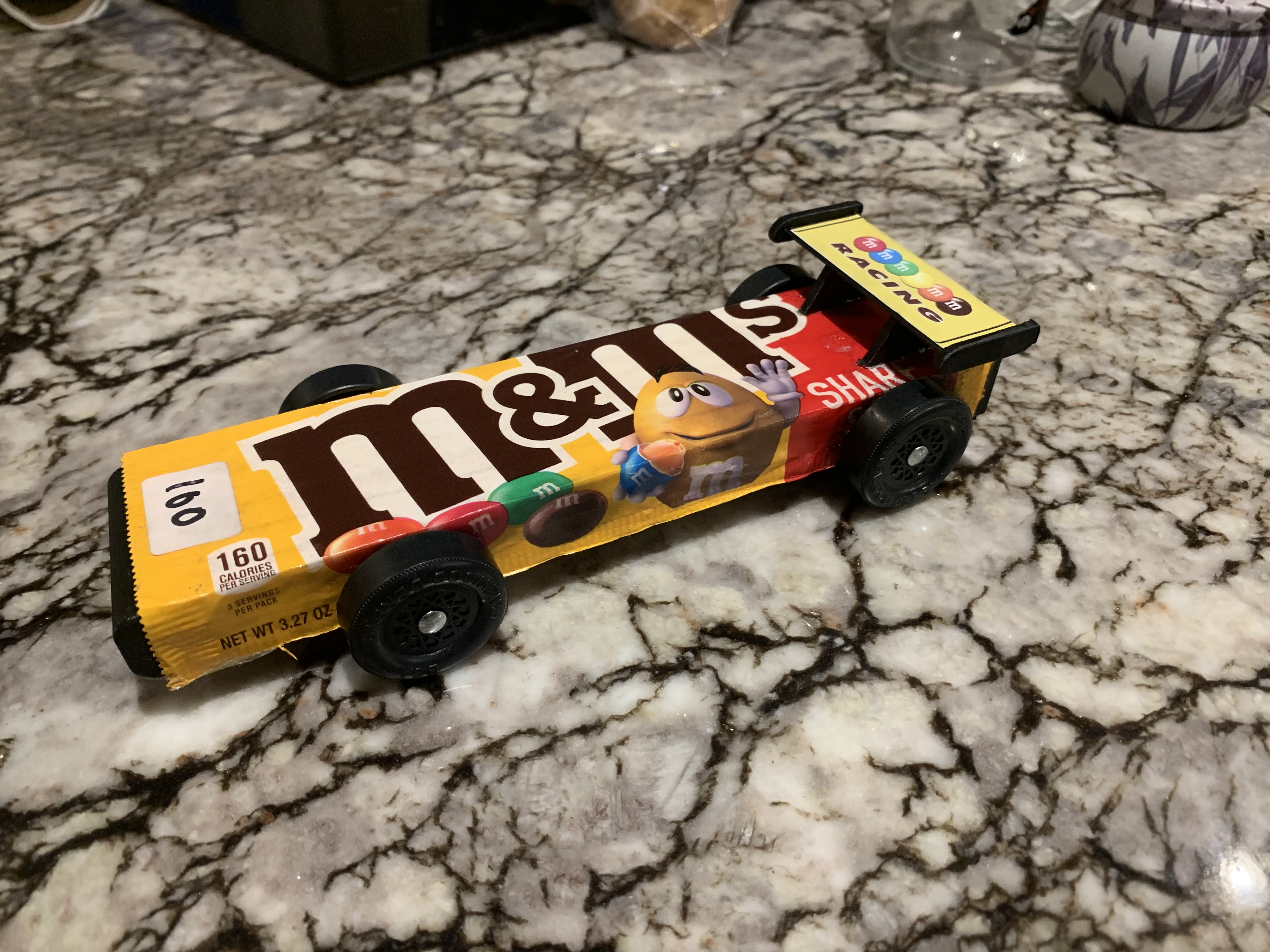

My 6 year old told me that he wanted a car that was easy to build and didn’t use dads fancy tools that he’s not allowed to use.Dad was very disappointed… so we cut the block in half and wrapped it in a candy wrapper which he was happy about.
At least we got to use the 3D printer and cricut since he’s now allowed to use those.
