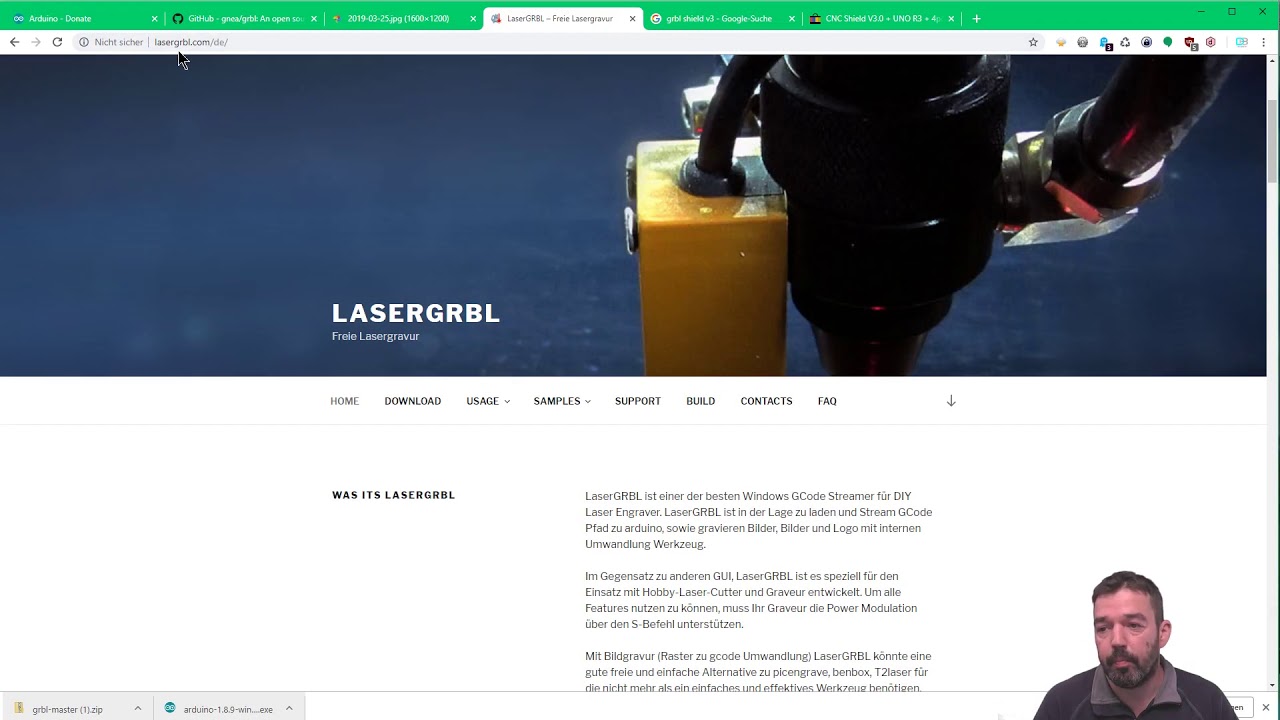

here is some information on those laser heads,
This is a German video, but it’s one that really explains it well. There are also pictures. :smiley:
The information is right here. You just need to learn German enough to understand a technical video to get it.
It might have helped… :frowning: I don’t have the time to translate it though.
for estlcam, i have watched Christians videos with cc translate to english. It works well very few times I need to pause so I can read, he does not usually speak that fast.
it works above too. but he does speak a lil fast.
I translated the relevant parts of the web page and saved as a PDF.
On one page it shows the connections which are pretty simple, just power in and PWM pin from the Arduino board.
I hope that helps a bit.

Very helpful, Philipp, thanks. For some reason I’m not getting the English CC option in YT so will need to figure out a workaround.
Appreciate you going above and beyond, Reg!
That’s what we do here Neeraj
I have made an English subtitle file that can be saved in the same directory as the video file.
The video file can be downloaded by using Atube Catcher (free software) Update to Latest Version – aTube Catcher Official Web Site
The subtitle file: (just unzip it into the video directory)
MPCNC Laser GRBL und Estlcam.zip (20.3 KB)
