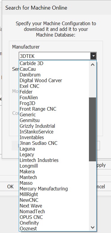

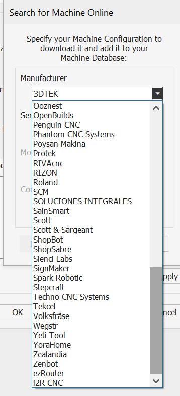

We are nearing the end of a new Primo build with a Jackpot controller. I would like to try using VcarvePro to make files for it to cut. What post processor do I choose? Here are screenshots of all the PPs in Vectric’s database.
I was hoping to see “Jackpot” or “FluidNC” or MPCNC here.
Never used Vcarve before but I am very surprised to see they don’t have a GRBL post processor. That is what you want. Might google and see if that generic one is GRBL or not.

I don’t see a GRBL option in the drop downs on V-Carve Pro. Here is a subset of the list. Should I use G-Code (mm)?
Please read them all, there should be 2 GRBL entries: grbl Inches and Grbl mm. I mean move the whole list up and down.
The list is alphabetical. Those are all the "G"s
I was caught by this conundrum too. Cesar solved it (see post 4 above) by making me realize there are machines and there are post processors, each with their own list. You are looking at the machines list.
Under machine config you can find “Openbuilds GRBL” they use same postprocessor. I use Cut2D which is same look and feel as its big brother Vcarve.
Is that the. Post Processor Management screen in the Machine heading? If so what version of vcarve is it? There sould be Gtbl (mm) and Grbl(inch)
Use the button Cesar mentioned in Post #4 above.
