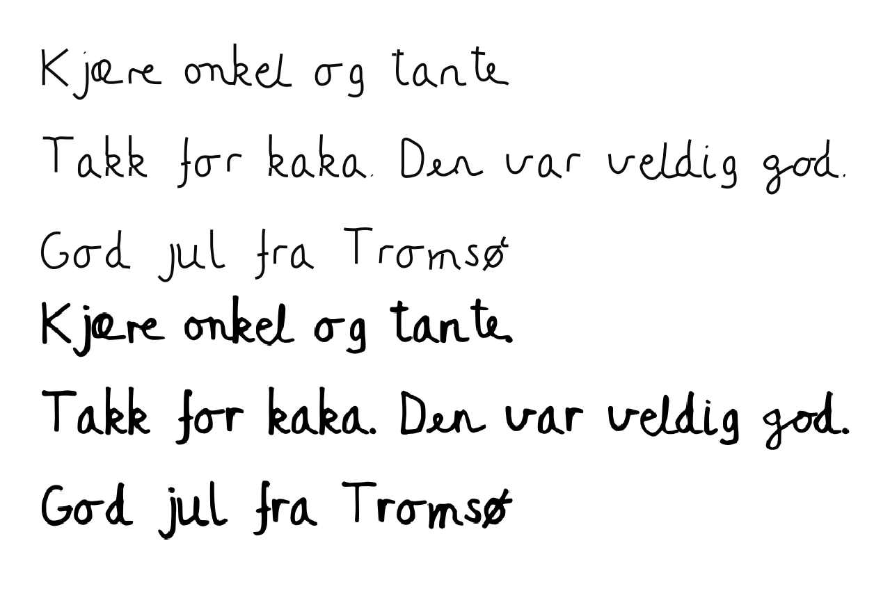

I’m currentlig strugglig with how to digitze my own hand writing. I’ve used calligraphr, an amazing tool for the task. I’ve even got ligatures for the most common letter combinations. If I’ll go further, I’ll make several variants for each letter - to make it seem even more natural.
Well - the problem is finding a good centerline. I cannot use outline:
Usually when I’m plotting things, I use the centerline tracing to extract vectors from a bitmap. But on my handwriting font, it’s not very nice:

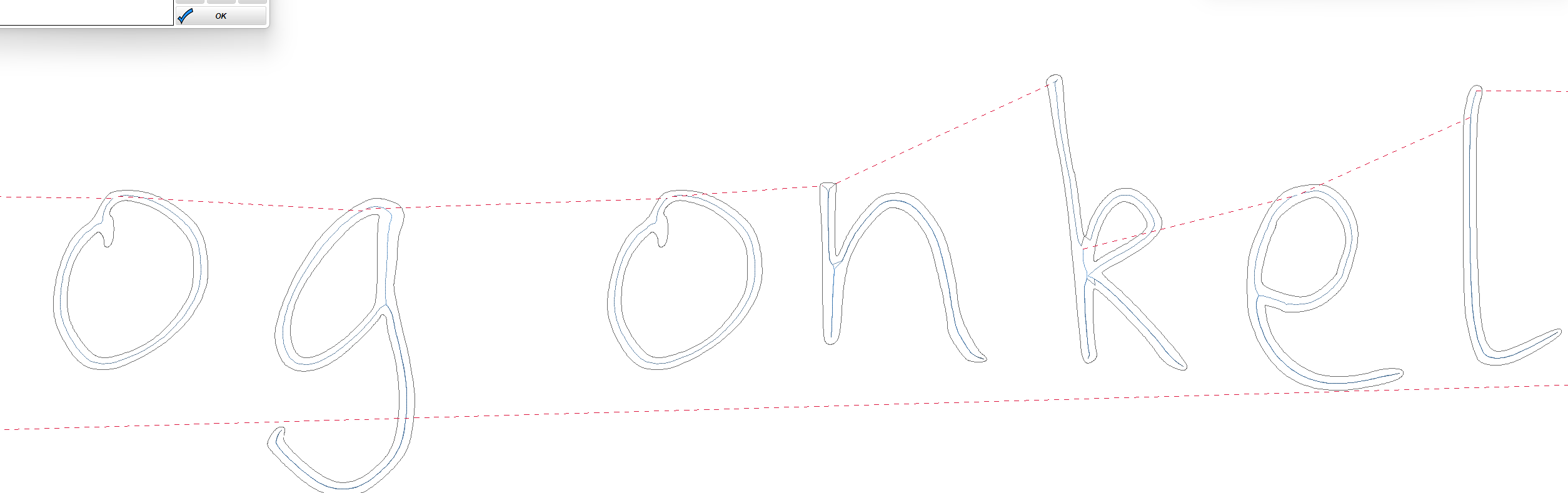

How can I centerline trace in a better way?? Here’s the output from the plotter:
My first calligraphr try I had a much thinner fontface. That was even more awful when trying to centerline trace. That’s why the current font is so bold, I was hoping it would trace better.

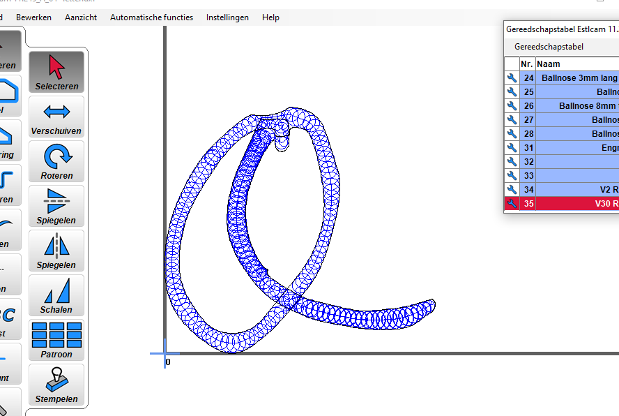

If you just carve those shapes with aV bit it will do all the work for you.
That might be the way! Just have to figure out how to set it up, so that I only get the center carve. Might need cleaning up all the letters with internal parts…
I’m sorry, I can’t figure it out… They all end up like this:

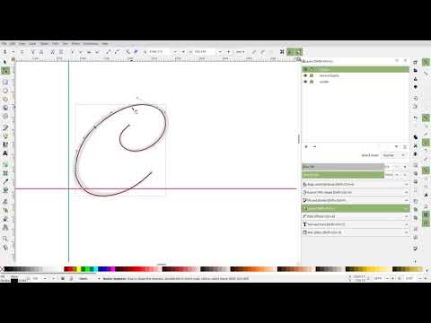

I was going to say inkscape had a option, but I’ve never used it. The other thing is you letters may not be connecting leading to the issues (sometimes software that we use to create a trace from a image doesn’t always connect the lines. But in inkscape you just need to mess with the fudge numbers some to get it right. I’d try following that video.
ALSO if you have time watch this
Is this what you want? (drawing of the letter was not accurate, just to show it)

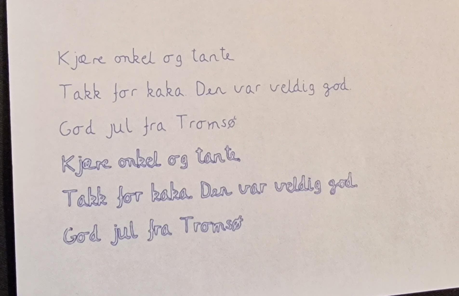

Amazing! The squiggly blue pattern confused me. It seemed like then pen would spin in circles. But looking at the gcode, they sure only move in one line:
This is definitively an imrovement. BUT - the paths are somehow “strange”, so it’ll still look a little phony. And every letter would need a clean up, before plotting. I think I’ll give a quick try converting the font to a centerline/stroke font. If not, this is one good option.
Yeah, was the same for me at the beginning. That’s how Estlcam 11 marks carves. V12 does it differently.
I would give them a test cut first, the preview is not great but I bet the cut is exactly what you are looking for.

It’s hard to figure out all the nuances with how deep the carve should go. I looked at the gcode, there’s different depth to the carve - at corners and starts/stops, even though it goes centerline.
As Jamie suggests, tracing it yourself is the proper way - makes it easy for quick production. I actually sent an email to the guy who made the stroke tool for inkscape, to hear if he does commissions… christmas is coming too quickly!!
Yeah it will go whatever depth is needed to go the full width, or you can limit the depth and let it clear out a flat bottom where needed. If you do a 1mm depth limit and a 10mm width you will see what happens in the preview, but with a font I think just letting it go as deep as needed would look best.
