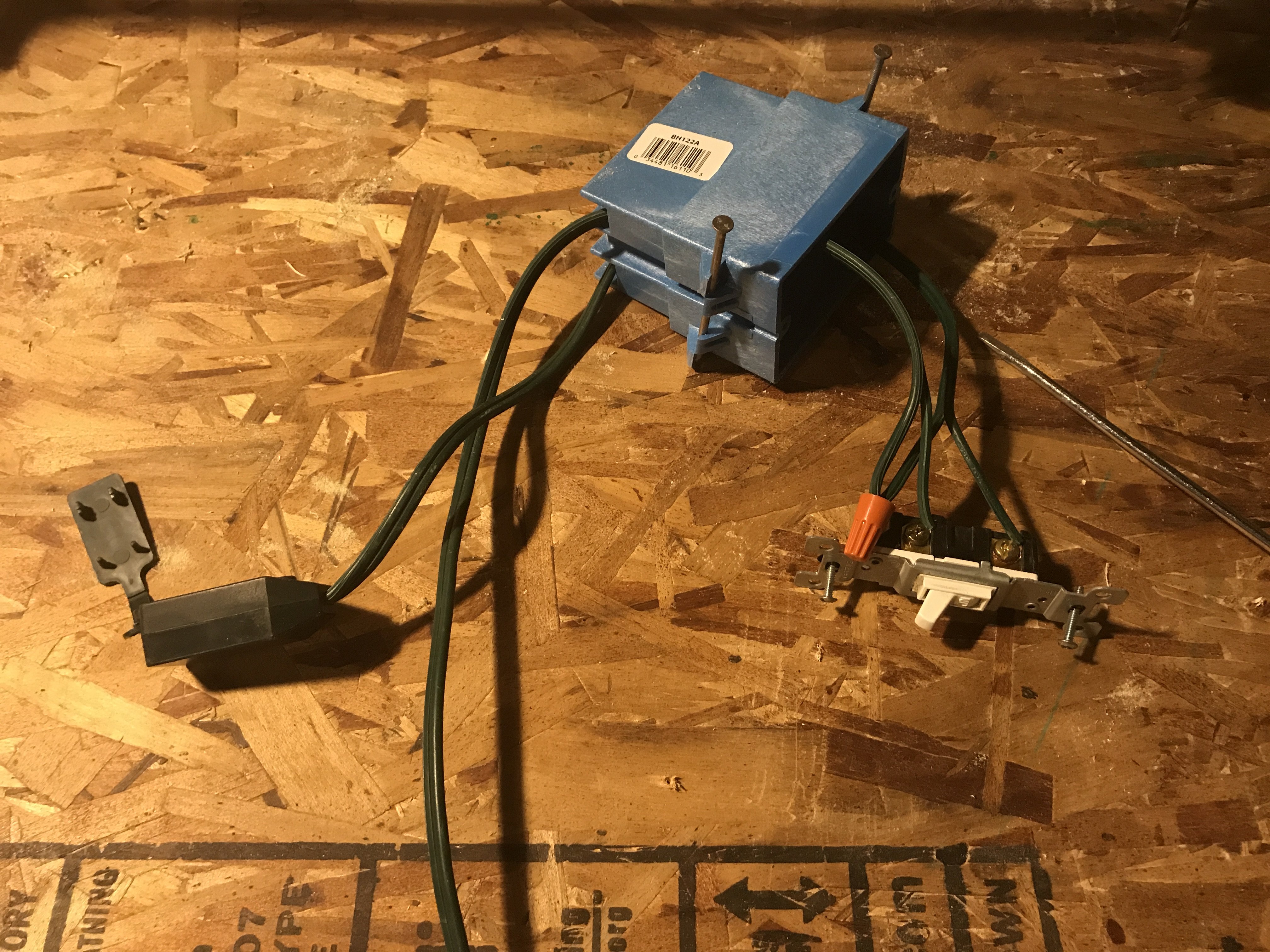

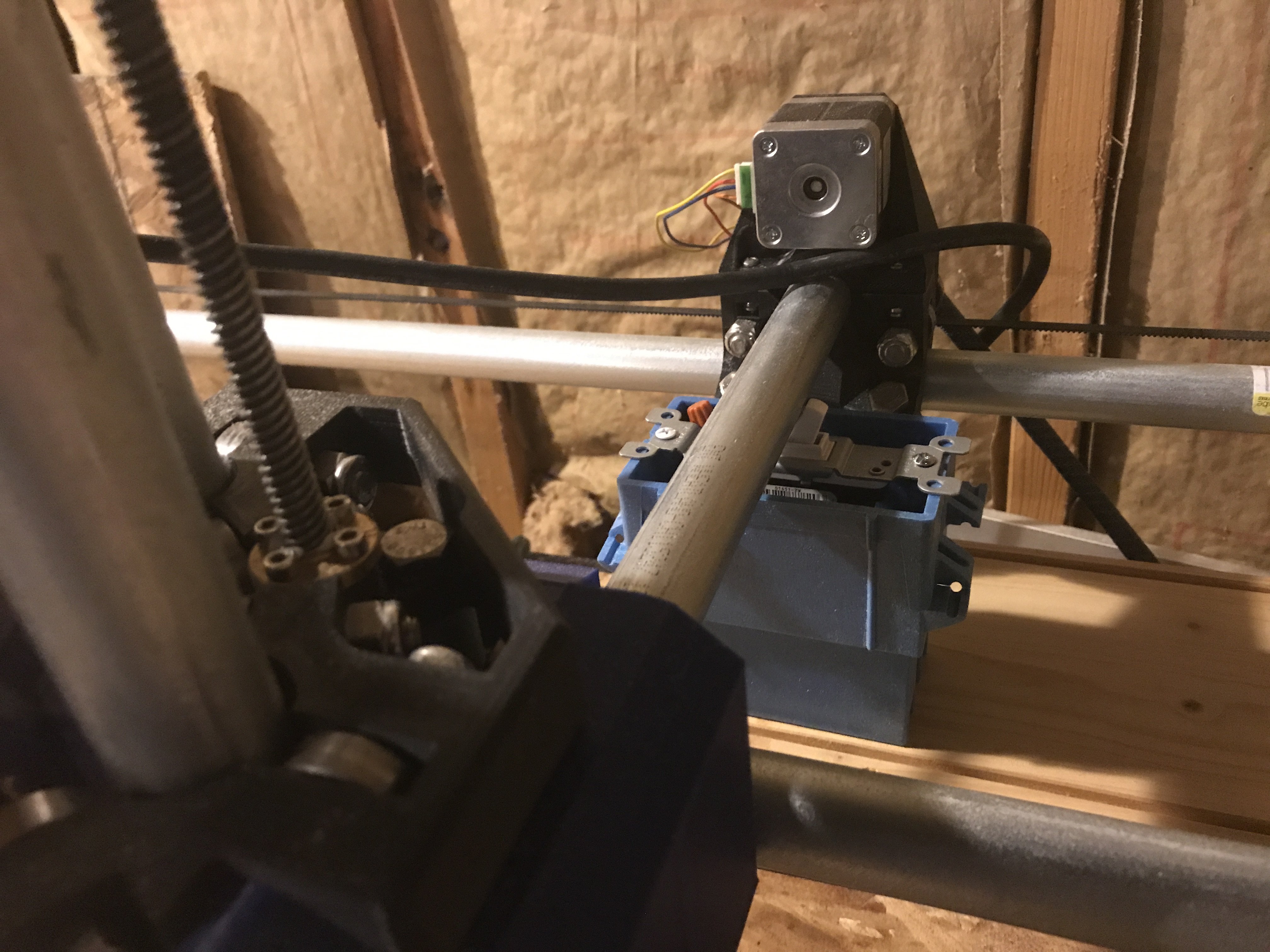

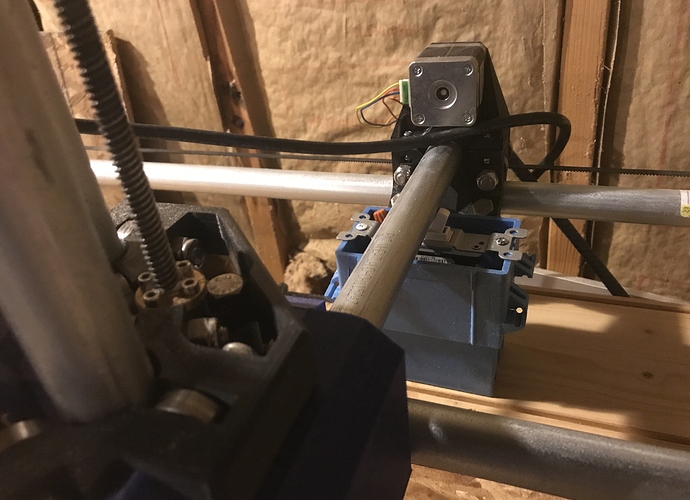

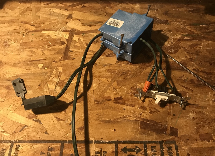

I am currently experimenting with that same idea with a fun electrical trick. I have created an electric kill switch for the router using a standard electric light switch. Here is a short video that shows how it would work. The basic idea is I will place the switch in a location that the machine (an MPCNC in my case) can flip the switch. Then I add gcode at the end of the file so the machine moves and turns off the switch. In the video I have it set as a high X location. I want to move it to X0 so I just send the printer back to home or X0 and it will turn off the spindle. Or I could somehow place the switch somewhere so the Z axes could turn the switch off. I don’t know.
That’s the idea. I don’t have it all figured out yet but there it is.
