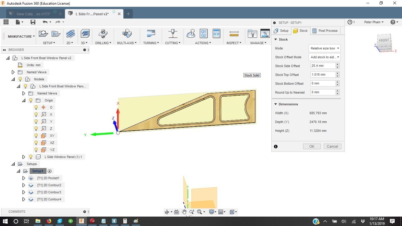

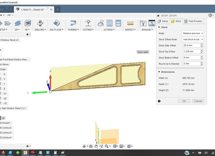

Hi,
I having a hard time trying to get Fusion 360 to start the milling process from the Home coordinate. I set the origin point in the setup tab and added all the cutting requirement as needed for the project, but every time I load the gcode into Lowrider 2 it goes straight to the first cutting process location. When this happen I can never tell where to place the cutting material on the table.
I moved the drill head to where I want it to start because that is the home position I indicated in Fusion 360 and it usually at the lower left corner of the material board, but it never work when its loaded into the system to cut!!
Here are the gcode: How do I get it to start at starting point?

Your gcode looks correct, if you start at the corner of your board as show in the Fusion window it should work fine.
This line means=where ever the tip of the tool is is considered 0,0,0 (the white dot in fusion).

That is exactly what you are telling it to do. You have a fusion cam issue, something with clearance plane and starting point. This says from zero move up to 15, move drill down to zero. Either correct your starting location (top of the material not bottom) Or use estlcam where it is much less convoluted to do the same setup.
Finally got it fixed!!! I set the X,Y, and Z right in Fusion 360 but I wasn’t paying attention to the direction each coordinate was running!!! There are little arrows on each axis point the direction flow…I had to go back and re-wired the setup so each axis is running in that direction!!!
Now its working right after the re-wiring!!! It process for the point of origin set in Fusion 360 now…
