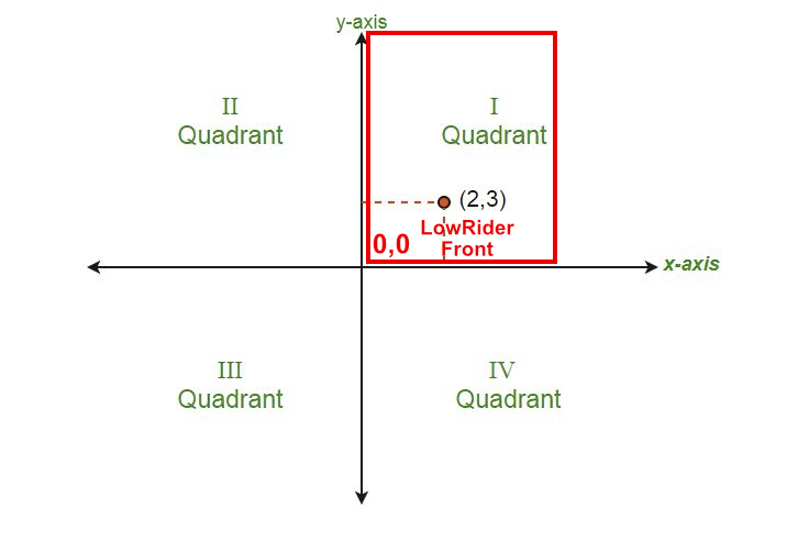

Homing to X-min and Y-max is indeed doable, albeit, the best way I know to do it, is by doing a logic swap in config, in which the X and Y labels / axes get swapped for each other.
Thus your CAM work can still be done like normal, in the “quadrant 1” area where all your X and Y CAM coordinates are positive, is still on the table, just turned 90 degrees from “standard” LowRider, like this:
Instead of this:

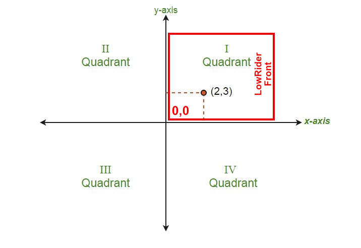

This kind of swap does not require any weird CAM magic or mumbo jumbo. The wide bottom edge of a landscape screen on a laptop or tablet during CAM work corresponds to the “wide” (long) side on the table. I personally have mine set up as “swapped” in this way, and I do prefer it. Obviously it is a departure from the standard plan.
In my mind, I would “see” such a table like this:
I think that’s what he has now, if I understand correctly based on his picture.
Just needs to fix the X homing.
Yes. All except for, some bit of of something will be needed to get a usable coordinate space for CAM output.

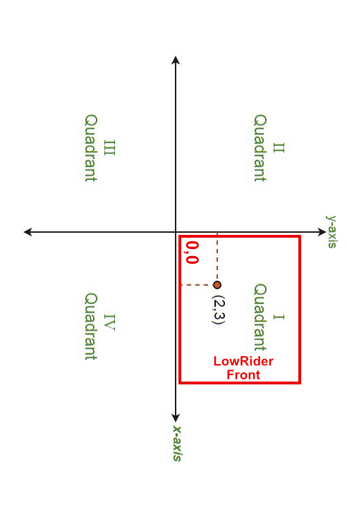

Nothing is mirrored in that configuration. It’s just rotated 90º right?
So CAM should be normal, I would think, except that his boards have to be rotated also.
Standing at the side, (0, 0) is still his bottom left, so the coordinate space is fine for CAM.
Just that it’s a little more trouble dealing with looking around the X Gantry and router, etc., right?
I think it’s more of a pain than it’s worth to do it that way, but I don’t think it presents any challenges except that the he has to remember to rotate the stock… and support is trickier.
If he has not swapped his X and Y axes, it’s not rotated yet.
According to his previous posts, X is normal, but Y is opposite. Y- is moving away, and Y+ is moving forward, correct?
That means his current configuration is as your picture showed. Homing to rear left.
Which is 90º clockwise from standard, right?

Trading + for - will not be the same as swapping X for Y. The X-Y swap is what would rotate it.
oh, yeah, I wasn’t thinking about the X-Y difference in your picture…
Just that he’s currently got it in landscape orientation. 90º clockwise.
Which should cause no CAM problems as it currently is configured
