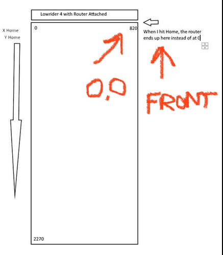

I am at wits end. I have everything working correctly except I can’t get X home to be bottom right if I am standing behind the machine to Top Left if standing in front of machine. With a 6’ x 20 foot table I can’t reach X on the other side. Below is my yaml file and I have read 42000 pages but no one syas what the command is to change this, just to change it… When I hit X home it goes Top right not Top Left :frowning:

Not really sure from your description what is happening and what you want to happen.
To remove ambiguity can you post a picture of your lowrider with where it’s currently homing to and where you want it to home to?

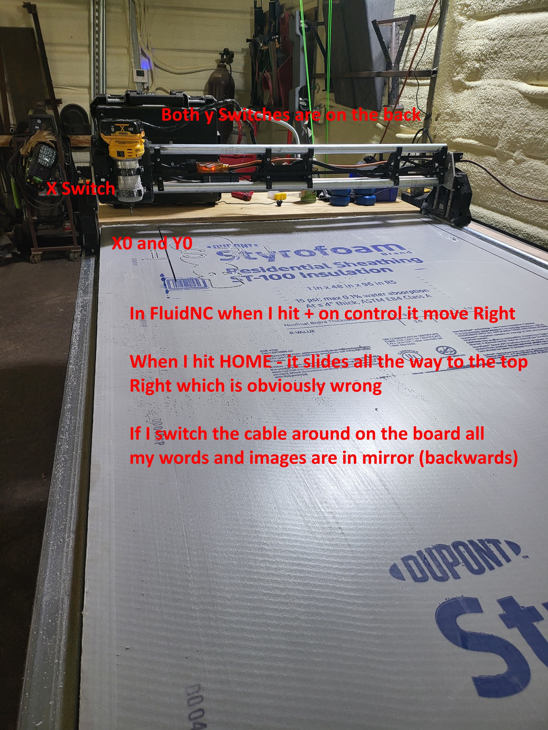

Here is a picture
X home means move left until it hits the endstop. If that is not happening, you do not have it wired correctly.
Y home means move to the bottom (in your picture).
In that diagram is the router on the top or bottom of the X gantry as you’ve drawn it?
When X homes does it home to the non-rail side?
To clarify this is the default. I know that’s a LR3 but the LR4 is the same, note the router facing towards you.
Your picture is correct except my x0 and y0 is top left not bottom left and when it homes it homes to the Rail side but I wanrt it to home to the non-rail side

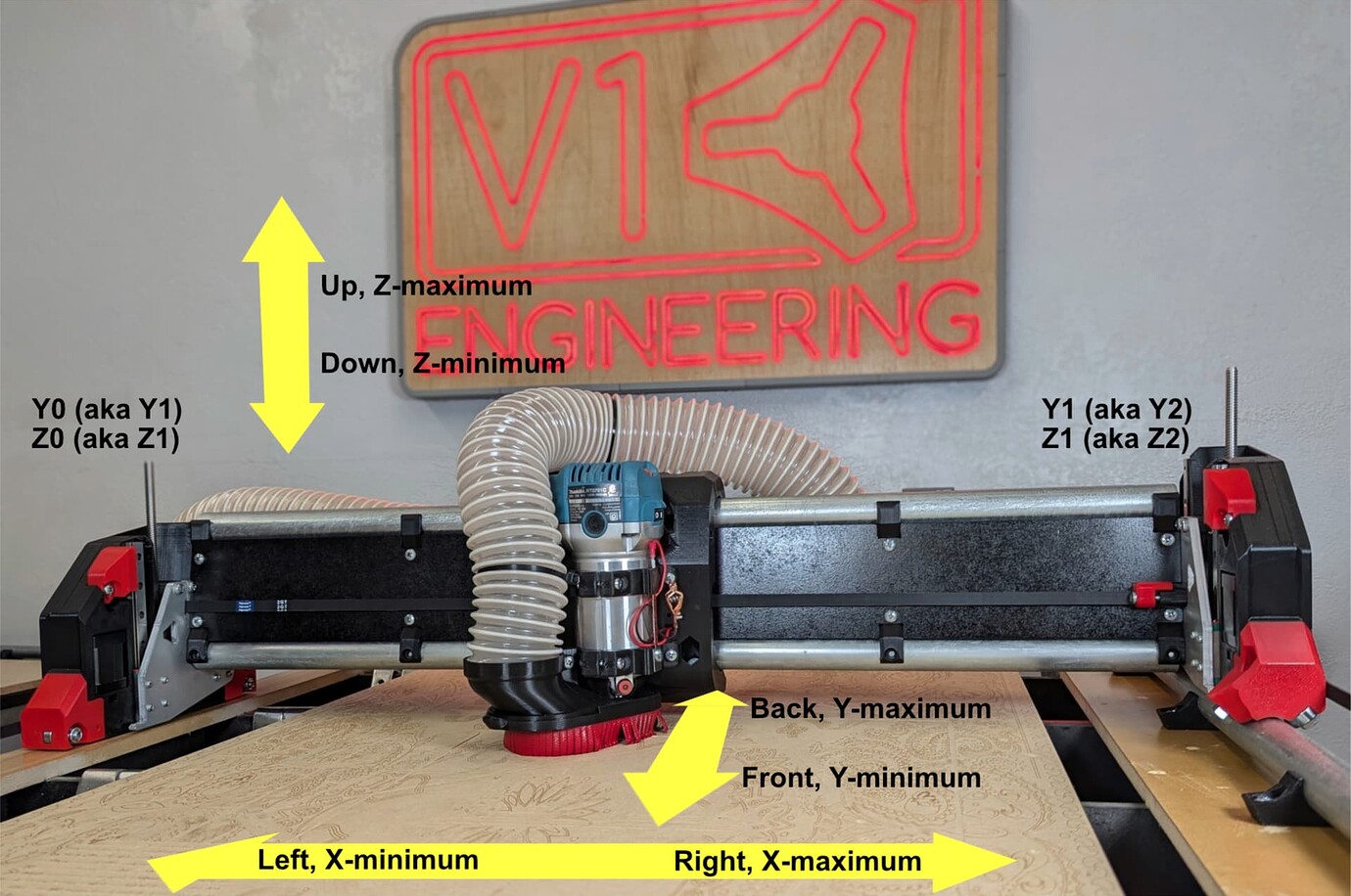

https://docs.v1e.com/software/reverse-motor/
X+ should move your router to the right, if it does not do that you need to flip the plug with the board completely powered off.
Y+ should move the router away from you, if that is not the case both Y plugs need to be flipped.

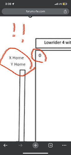

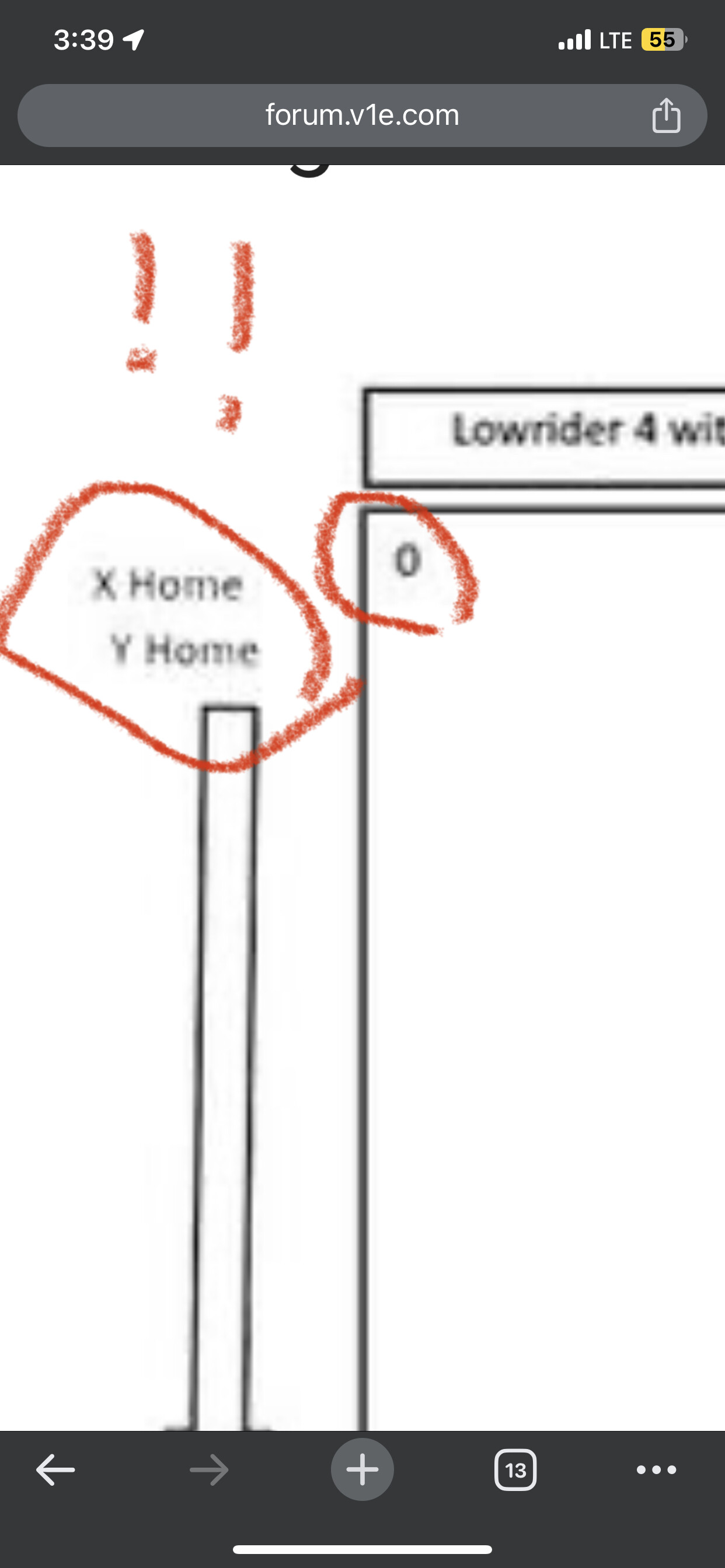

Looking at it from the perspecive of Dretfus’s picutre it does indeed move Right aka away from o but when I hit home it goes to 820 -3 IE 817.

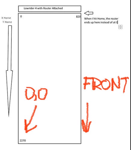

So you want x to home as per stock and Y to home to the far end.
Since you didn’t post a picture can you confirm you ONLY have end stops on the stepper motor side of the core (the stock, default) and the BACK of the YZ plates (away from the core side)
Just for clarity, this photo shows the stock orientation of a standard LowRider, homing to your left in the x-axis and near you in the y-axis. Is this what you are after? Or are you wanting something non-standard?
Yes, that is what I want. I have end stops of the left or the X and the 2 y’s are on the rear and of course Z’s are when it gets to the top.
If you include the + and - for positive and negative movement directions that’s diagrams a keeper.
Back to the core answer - how do I reset the MACHINE X to be 0,0 instead of -817,3 ?
Standard would be with the Y limit switches on the fronts of the two side assemblies — facing toward you, and the Y is homing toward you. To change the Y so as to be homing away from you, with limit switches on the backs of the side assemblies, would constitute (mathematically speaking from a CAM perspective), a non-standard and non-workable arrangement unless you swap X and Y axes (which I have done and it works).
A standard LowRider can either home to the “near left” or — by flipping the plug wiring orientations on the X stepper and both of the Y steppers, to the “far right.” To home in either of the other two corners, “near right” or “far left” would be a case when you need to swap your X and Y axes or else your CAM file output is not going to work right.

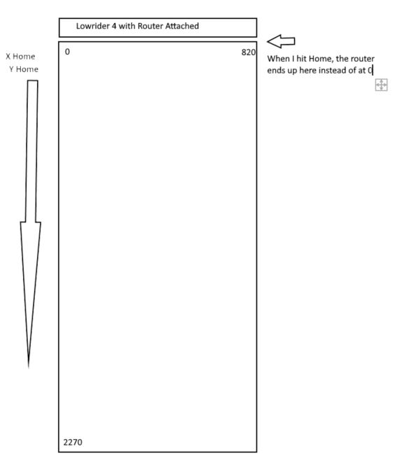

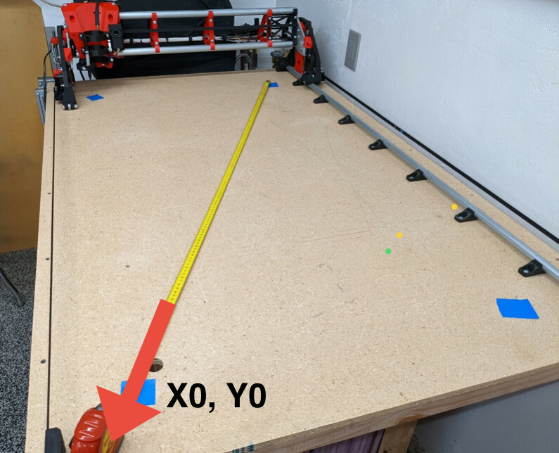

Time for a Picture with words
Your photo helps to bring clarity.
With a standard LowRider, 0,0 for homing is near you and on the left side. Hitting the + in Y moves away from you toward the back, and hitting the + on the X moves toward the right. Your drawing designates 0,0 in the wrong corner. The only way to have 0,0 function in that corner is if you swap your X and Y axis (logically speaking) within your config file.
