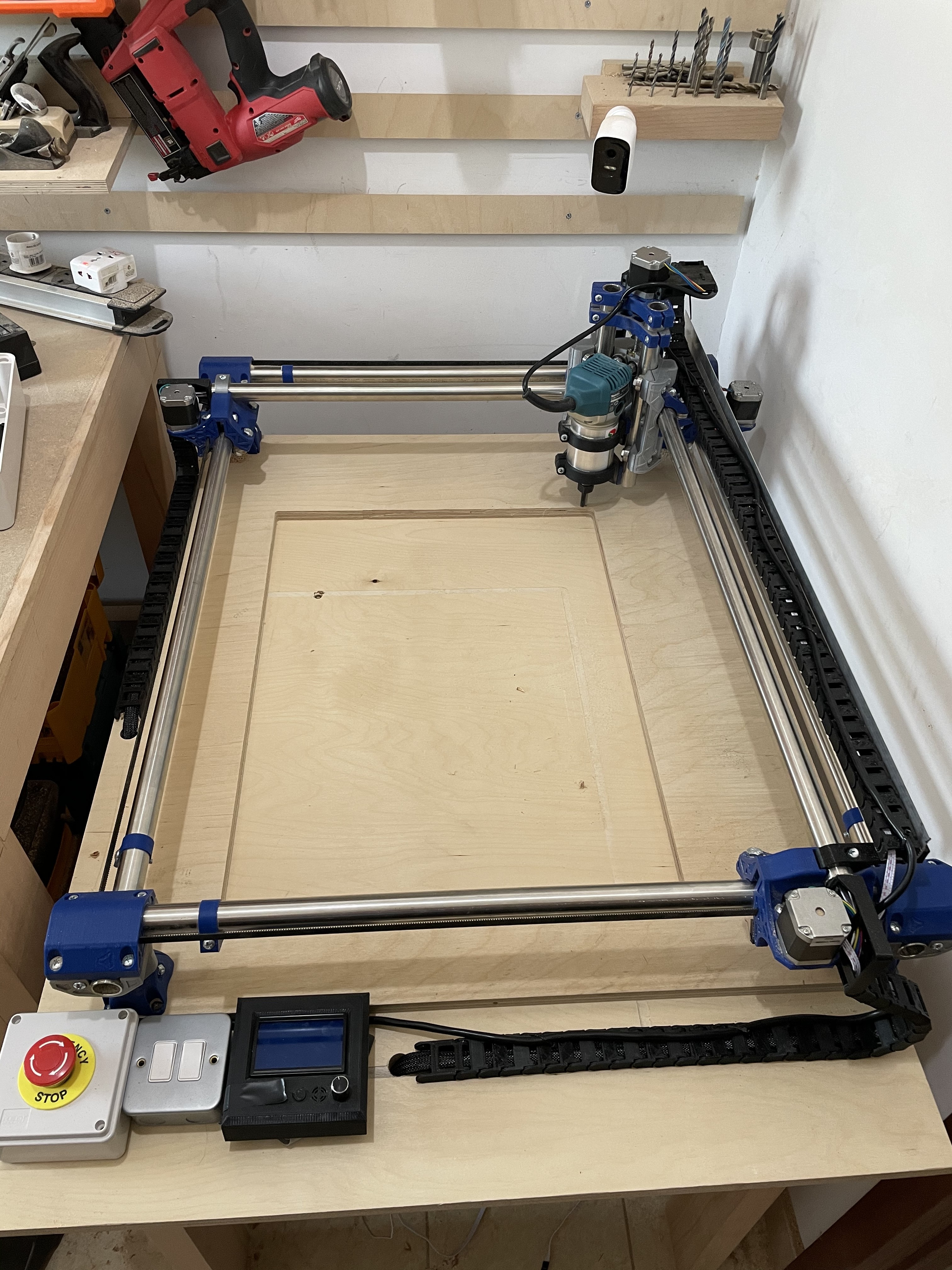

I’ve read through most of the posts here and learned quite a bit. But one thing I haven’t seen is how much cable chain to make. Specifically for a 2’x2’ MPCNC.
So can anyone tell me how much cable chain to print for my build?

Technically only need to go about 1/2 way on the x and y (if you’re going to do cable management below the table) and then about the full length of the Z…plus some extra for the Z slack and coiling. I 3D printed mine with slightly more than x and y*2…and I have a bit spare. Pic below.
Thanks. That’s a great starting point. It should give me an idea of how much I need.
