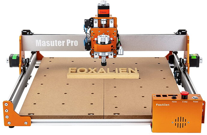

How does the FoxAlien Masuter Pro compare?
As many do, I’ve been lurking here for a while researching. Have got my spreadsheet of links and prices nearly complete with everything I need to order to build my MPCNC Primo.
Then I spotted the recently released FoxAlien Masuter Pro on Amazon and started to doubt. I enjoy building and learning, but on the other hand I’m always short on time and the idea of taking something out of the box and being able to cut within a few hours has some appeal.
It was under $600 a couple of days ago (and I assume would be again sometime soon). I was planning to go with a SKR Pro CB (with display) and stainless tubes so the MPCNC would cost almost the same.
I would of course plan to replace the stock spindle with a Makita or similar (which it includes a tool mount for in the box). Belts for XY, lead screw for Z same as the MPCNC (although 6mm belts). I expect the steppers are probably weak compared to what I’d put on a MPCNC. How would this compare in rigidity and accuracy to a MPCNC? I’m not planning to cut anything too exotic - primarily carbon fiber sheet (racing quad frame parts) and wood (plywood, softwood, MDF). Possibly some acrylic. For the wood, I expect +/- 1mm would be good enough for most things I would do. However for the drone frames more like +/- 0.1mm or better would be needed otherwise parts won’t fit properly or press nuts will fall out. I was planning to keep the MPCNC work area to around 450mm x 350mm so there is minimal tube flex.
Convince me why a MPCNC is the better option and that the work to build it will be worth it.
If you need to be convinced that going through the pain exercise of printing, building, calibrating, and maintaining your own machine is worth it, my guess is that it isn’t. For you. For someone else, they may want it to tinker with. Maybe they want to get a better, or deeper, understanding of how CNCs work. But if your time is super valuable to you, and you don’t want the hands-on experience, then a MPCNC is likely not for you.
Just by eyeball, their design looks pretty good. Nothing is screaming at me that says they made a bad choice anywhere. At least, not for the model shown.

Where the MPCNC is going to shine is flexibility in terms of things such as size, firmware, additions, etc. If the Masuter Pro meets your needs for the foreseeable future, then it seems like a good solution. My one concern is firmware. Hopefully they have something pretty generic on the board so that postprocessors are easy to find. I did see on a quick search that they were trying to upsell Easel Pro for this machine, so it is possible there is something proprietary in the firmware.
I’m not going to guess on their rigidity or anything. Honestly just having a cnc machine is a big step over not having one. So it doesn’t really matter on an entry level machine.
I don’t really like this call to action. You may not believe it, but I prefer you get the machine that works best for you. If my words convince you to get an MPCNC and that was the wrong choice for you, then I will feel worse.
I think most people feel the same. Even Ryan isn’t making enough money on one kit to compromise his morals.
Some things I would point out though:
  1. Even if it is not a kit like the MPCNC, it does require a lot of effort to learn to run any cnc machine. They are not inkjet printers. Ve prepared to turn your brain into a sponge and waste a lot of materials while you are learning.
  2. The work space is only 16"x16"x2". That isn’t necessarily a bad thing. But it is smaller than most mpcncs.
  3. If something breaks, or bends, or snaps, can you fix it? If you wanted to swap to 10mm belts, can you do that? The MPCNC is completely flexible and if you look through the builds section, you will see a lot of mods.
The best argument for an MPCNC is the gallery-mpcnc. But please, get the machine that is right for you. The V1 machines do require learning. They do require some work to build and tune.

Usually these have a slightly upgraded GRBL controller on the low end cost break, like a 3018 (I have one). The spindle appears to be the 770 watt upgrade motor from the 3018 world.
I used the 3018 to get my feet wet in CNC. A 3018 is a cheap, around $200, you can usually find a package with a set of bits, er11 collets, and a offline controller pendant.
I still use my 3018 for some stuff. I have 2 MPCNC’s of different sizes, with the parts printed for a third, that will be highly modified for a CNC lathe.
The advantages to the MPCNC, or Lowrider3, is scalability, a very active support from the inventor (Ryan), Jeff above, and lots of community help.
If you come from a 3d printing world to CNC, the MPCNC is a lower learning curve as well.
On rigidity, I used 1 inch DOM tubing with a .120" wall. My two are way above recommended size, and using this >0.0002 flex on a 26-46" width.
My Opinion is that you’ll probably be better off with the machine that comes out of the box. Further, I think that given your list of target materials, you may be better off spending more money on something that will be ultimately more capable.
The MPCNC is really good at what it does, but I have limited expectations of what it will do for pretty much anything that isn’t wood, and that I’ll have a lot of learning to do if I want to change materials. I’ve done a bit in acrylic, and it was a pretty big mess, so I know I’ve got a lot to learn there. I won’t touch CF plate. I hope to be able to do aluminum at some point. So far, the MPCNC has met and exceeded my expectations, so for me it was a great decision, given that I also love to tinker.
Most of the more expensive machines work MUCH faster, and have a wider range of speeds, can cut deeper, into more varieties of material. It seems to me that you’re likely to be happier with a higher end machine than either the MPCNC or the FoxAlien, but that’s just my impression.
That pretty much tells me you already get where I was going to come from on your choice. If you have some orders for cf parts you need to fill yesterday, maybe foxeer… if you want to become a ‘cnc guru’ and the orders can wait, maybe mpcnc.
Cutting CF at 0.1mm (4 thou) is doable on mpcnc. However if that’s a big priority, I’d definitely minimize the work area as much as possible, especially the z since it affects xy flex and you don’t need height for sheets.
