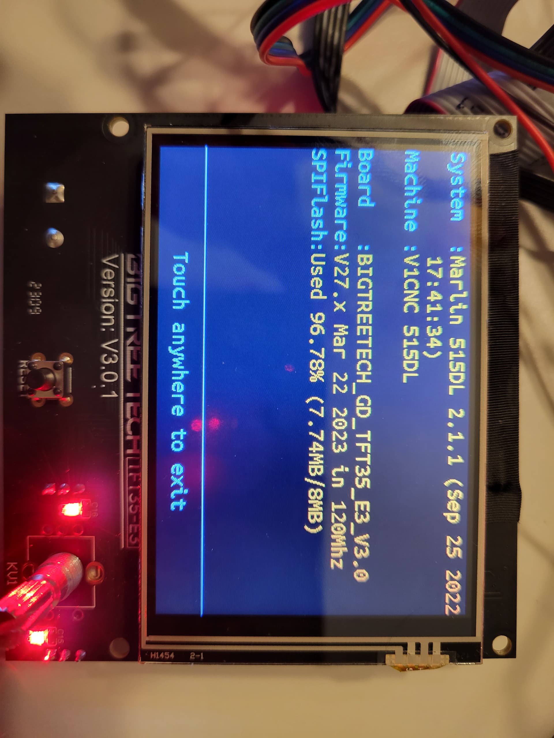

I have a LR3 that I’m getting close to finishing. Can someone tell me what I should see when I select the Z home on the firmware screen? I have a SKR Pro 2.1 with the stock firmware that was pre loaded. In my case, the gantry moves up and when it hits the end stops, One of the stepper motors stops but the other motor keeps moving even though the end stop for that motor has also been triggered. I can provide a small clip if it’s allowed to upload if needed. Actually, I’m starting to question if the firmware that came preloaded is correct. For the CNC would I have an icon for filament unload?

Not actually sure if its the correct firmware due to the machine name not saying anything about LR3. The file name was V1CNC_SkrPro_DualLR_2209-2.1.1 however.
After the new firmware, I can raise and lower the gantry with no issues. However when I home, only one stepper spins while the other just sits. Perhaps a setting somewhere? Any suggestions?
The 515DL marks that firmware as version 515 dual end stop Low Rider. The same firmware for the LR2 and LR3 works, so you definitely have the correct firmware for a LowRider3.

The TFT is still very much aimed at 3D printing, and so it will look like it is configured for 3D printing, with functions that are aimed at it as well (like filament unload) we can safely ignore that. There have been CNC specific builds for the TFT, but they do not work on the GD processor version of the TFT which you have. The firmware that you have for the TFT seems correct.
