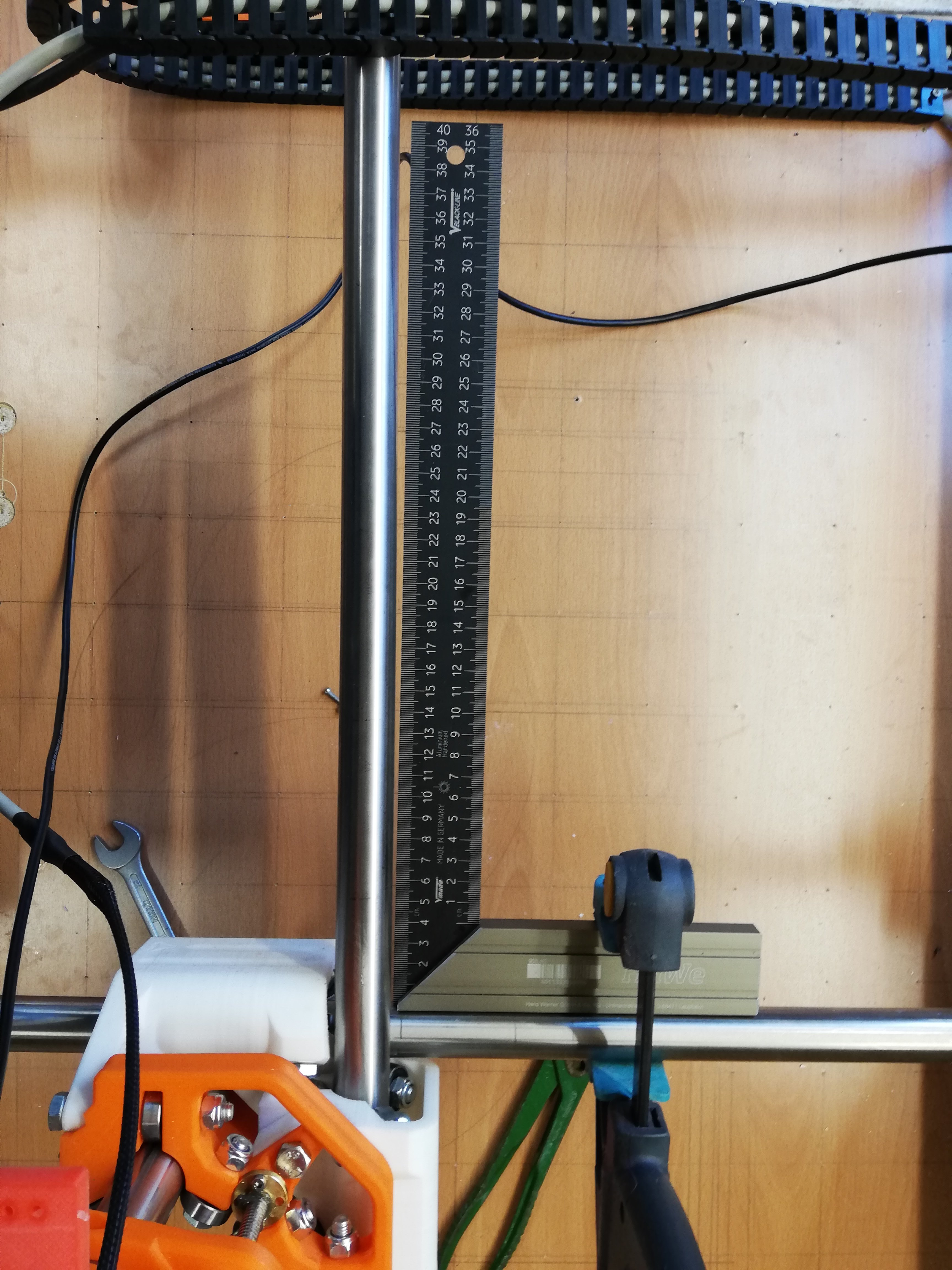

I do actually have issues with a skewed middle assembly / gantry (however you want to call it) and I have tried all the recommended steps to the get my assembly perpendicular (fasten/loosen A, B and C Bolts, filing the connecting surface of XY and XYZ Burly, redrill the 8mm holes for the screws). I have to agree with some other guys here that a perpendicular gantry is much more important than a square base. Unfortunately, due to the the differences in the height of both gantry conduits it is almost impossible to measure the squareness. Only plotting rectangles/measure diagonals is an option. However, you cant tell which part of the machine causes the issues (parallelograms) if you have your middle assembly and your base as possible sources for this problem. This makes troubleshooting a pain in the ass.

To get an idea how “unsquare” my assembly is I have attached a picture. I have used a steel square to measure this, I don’t know what a 2D square is.
I have problems understanding your envision of my “unsquareness” because I don’t understand what kinds of units you are referring to with " 1″ "and " 2′ " (1″ is 1 inch and the other one is?; Sorry, I was born into a metric system :wink: ).
What I have done is plotting rectangles with the dimensions 480mm x 900mm. (Y x X). The move in Y direction (Y480mm X0mm) turns out as a Y480mm X5mm move (assume that X-axis is perfectly aligned with the machines coordinate system).
This means that I am off by 0.6° (from perfectly square 90° [tan^-1 (5mm/480mm)] ).
I really don’t know if this is little or a lot. I just think it is more than I would have expected.
As I plan to also mill furniture parts (mainly) and I would also be happy to cut PCBs later, I hope it is possible with my machine (working dimensions of my machine are approx. 1010mm x 510mm [40″ by 20″ for you guys] ).

I am not really sure what to tell you, building it square is possible but I can’t really say why some self printed versions are so difficult to get right. Yours can be corrected with dual endstops I believe if you just can;t get it.
Like I said just use it for a while have fun revisit it in a while. Even with that big angle I bet you would not notice on through hole components on a medium sized PCB. That is actually really far off, you might want to check your printer.

Bed skew would work if you built your frame as a parallelogram.
