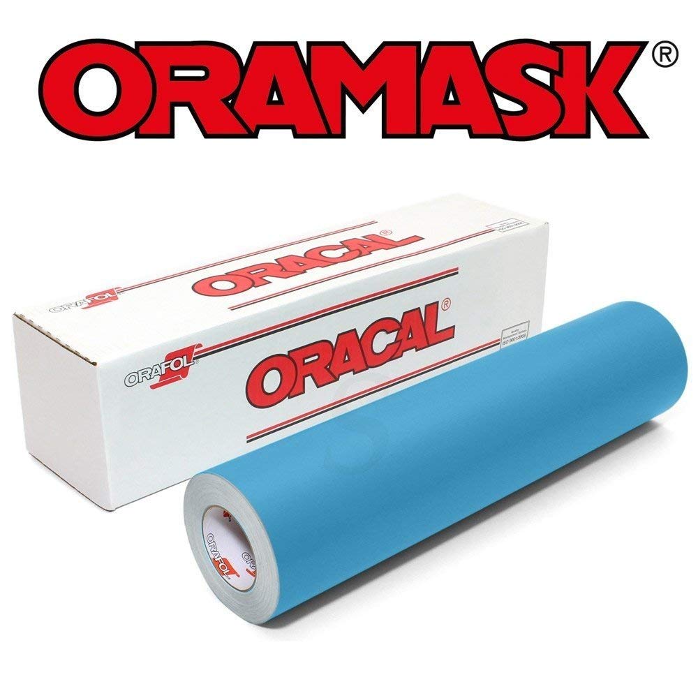

I have been using Oracal Oramask 813 Stencil film. I cover the project with the film and then do my carving.
I then spray the carving with clear polyurethane to stop the pant from beading into the wood. This is a real important step.
After the polyurethane drys I then use spray paint to paint the carving. When done painting I remove the mask and the sand before applying a clear coat.
This it the process I used with this sign.
[attachment file=78118]
Oracal ORAMASK 813 Stencil Film
