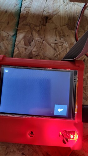

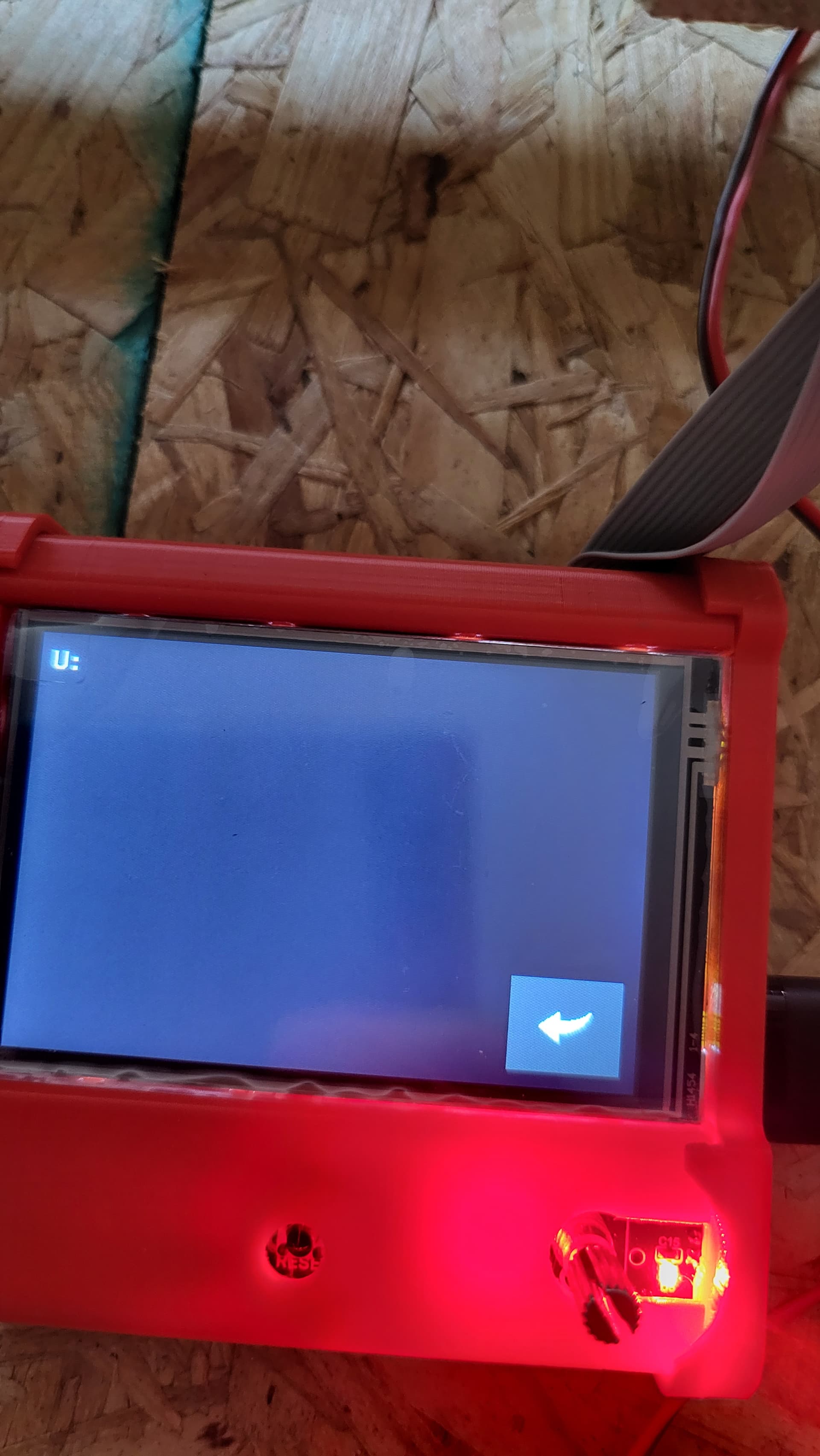

Hello, my home axis xyz are all working correctly. I assume I am ready to print? I go to carbide create and made a simple circle. Saved the g code to a usb thumbdrive and put it in the touch screen usb slot. When I click on print, then tft usb, it goes to a black screen with the letter U. Next, I try a sd card with the g code saved to it, it states sd card reading error, then goed back to print screen. Can anyone help me try to figure out how to start a print with the lowrider, skr pro board, cnc machine.

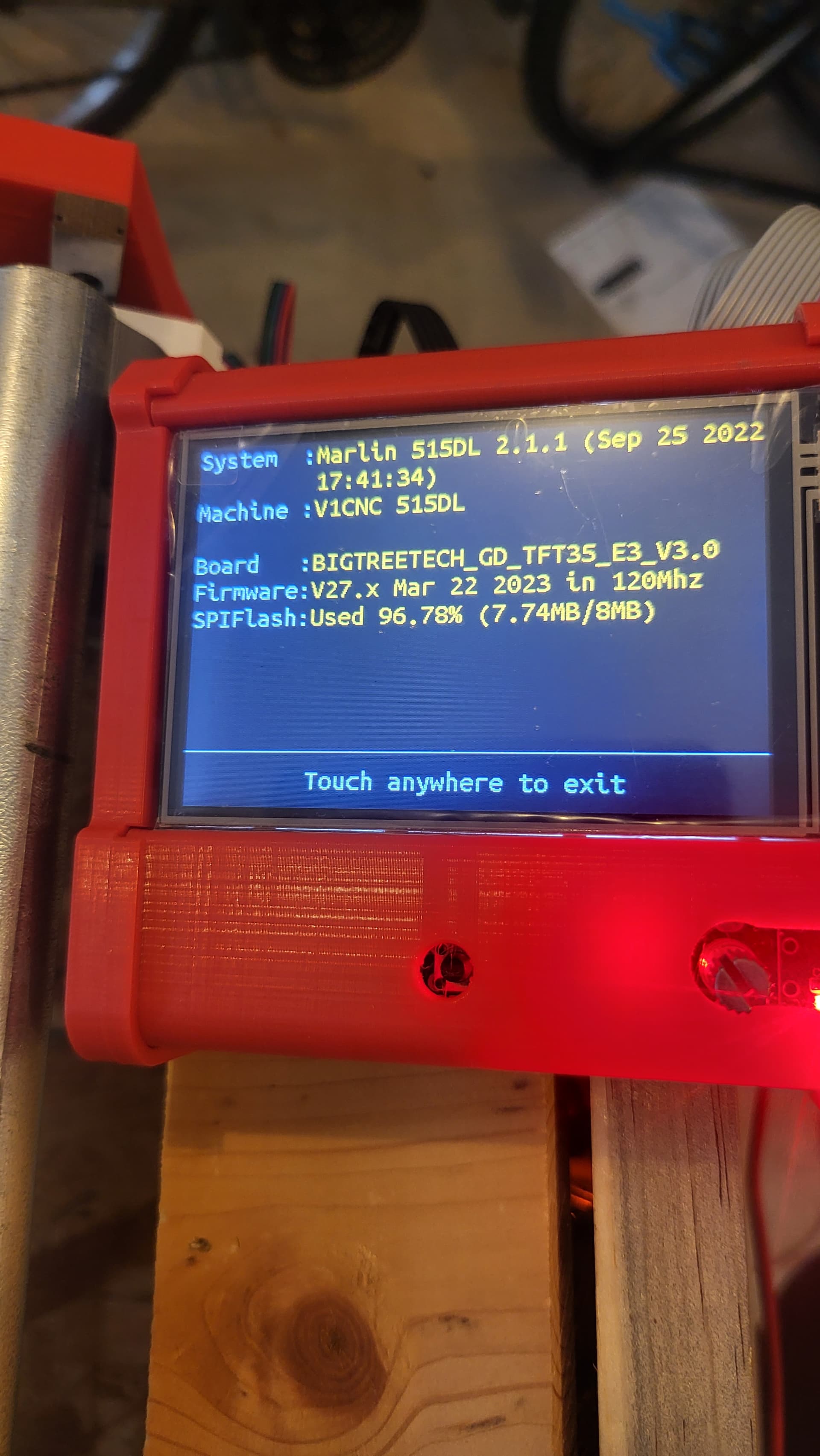

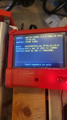

The SKR Pro firmware from the V1E documentation is Marlin based which is very similar to, but not identical to GRBL, so it is likely some gcode that the post processor is embedding that is unsupported (or being interpreted differently). Please confirm the firmware info including version to make diagnosis easiest.

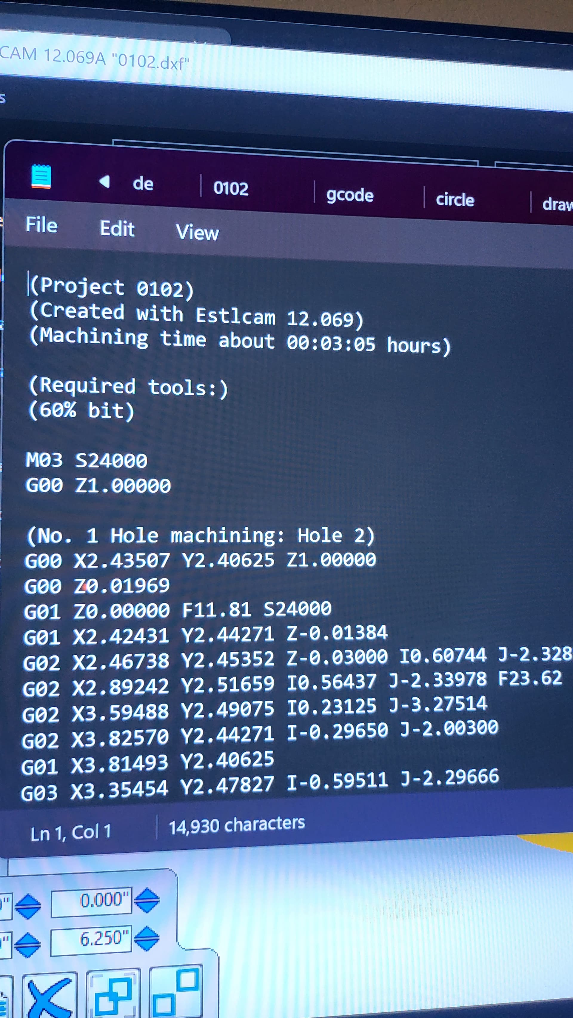

Drilling to the errant code: there are multiple post-processor options in Carbide Create, so please specify which one you are using (if you know) and post at least the first 50 lines or so of the file.
I don’t use the USB storage, but you may find that depending on your specific firmware you may have to use the USB or SD card in the host board (E.g. SKR pro or whatever you have) instead of the TFT.
More details about your build and which controllers and firmware you’re using would be helpful for us to help you.

Are you using the SD slot on the right side of the screen, or on the left side of the controller?
If you are getting an error, rather than a “No SD Card Detected” message, there may be something wrong with your SD card. Is it < 32GB? Some devices won’t work with the larger cards.
I have seen the “SD Card Error” message when I inserted the micro SD to SD Adapter but forgot to put in the micro SD card into the adapter.

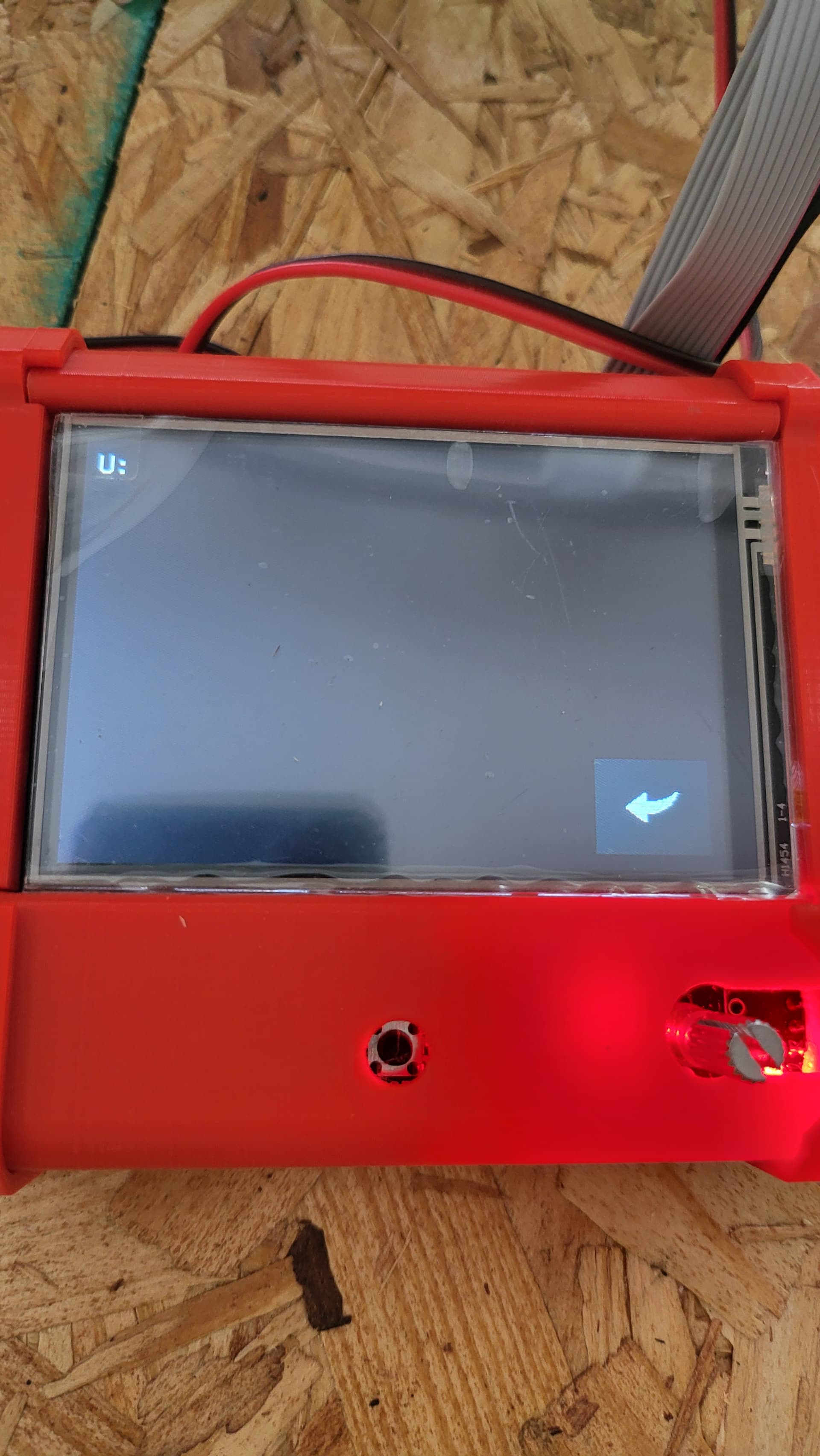

Yes I have everything set to inches. Now i can even get the touch screen to pull up the usb again. It just says U again. Ugh. I save the file from estl. The I make sure the g code is on the thumbdrive. Once i plug it it. Nothing. I’ll keep fidling with it

When I went to re insert the usb on the board, after changing the speeds, it stated a usb was inserted but again, I just get a black screen with the U symbol. When I inserted a sd card with the g code, its states sd on a black screen but nothing else. I inserted another sd card that had low memory on it, 16gb, and nothing.

If you can’t run that file from the screen, post a picture of what you’re seeing and your controller. We can start working on it from there.

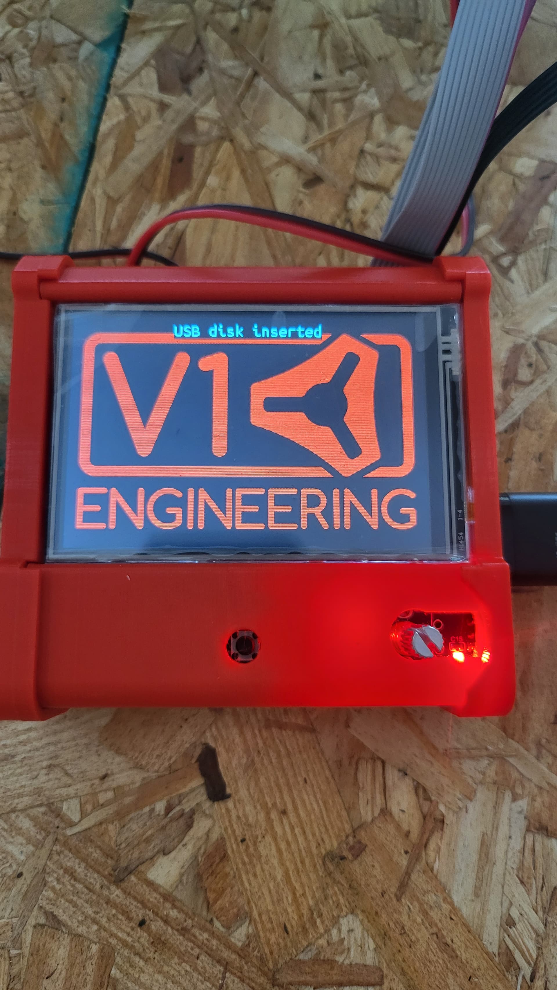

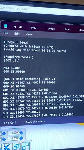

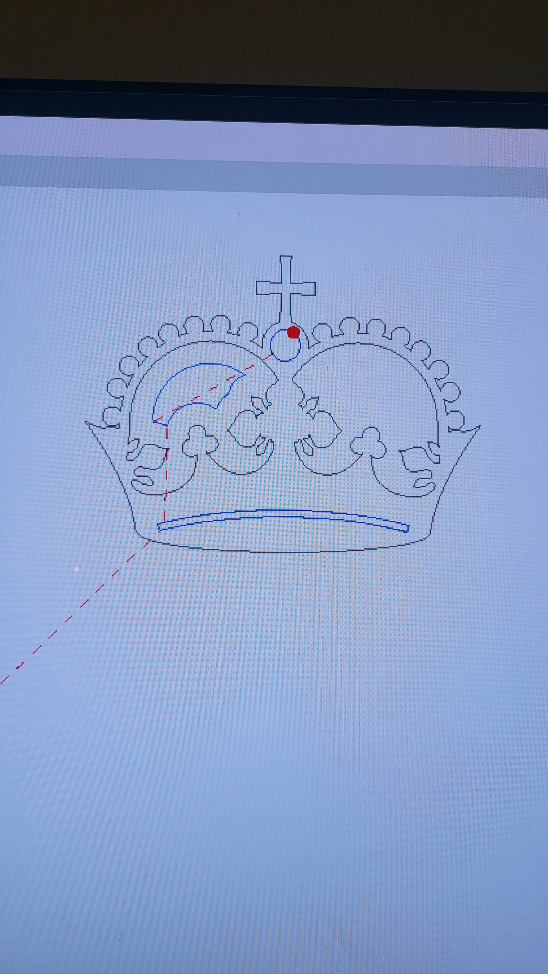

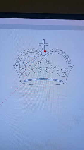

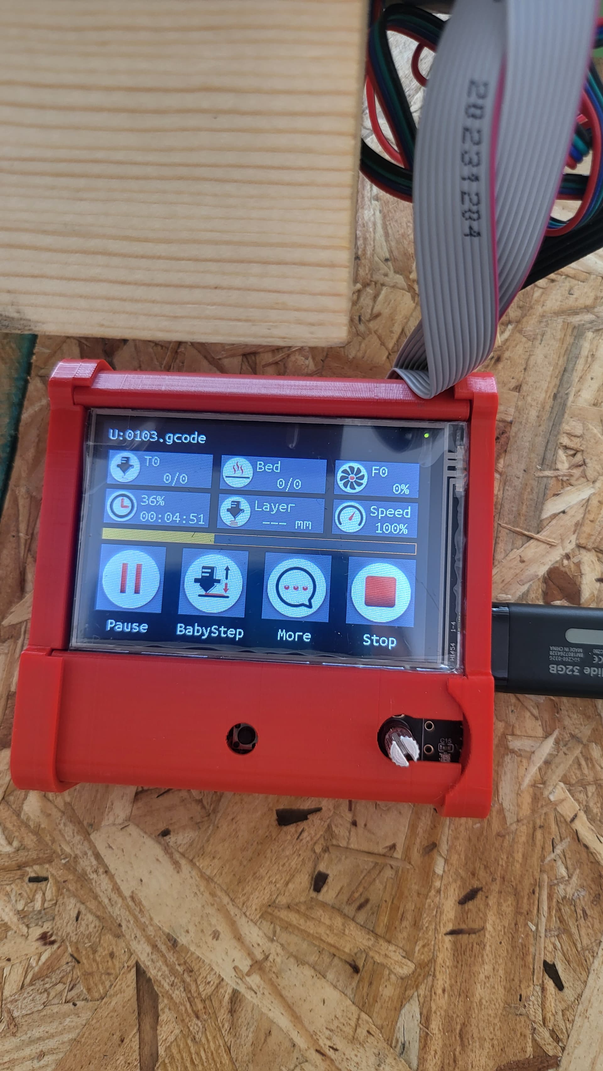

I downloaded the crown test again and placed it in estlecam to get a gcode. I did auto pockets and holes just to have it register something. I saved the gcode to my thumbstick. Made sure the g code was on the thumbstick. Took itnto the cnc machine, it stated a thumbstick was inserted. Hit print to see if anything was there but nothing. Here are some pictures from start to finish. I know the speeds are slow, I’m just trying to get it to read first.
I am not actually sure if the USB slot works, if it does the stick will need to be fat32 formatted and the File needs to end in Gcode, not NC
I did getthe USB to work previously, but it was only 1 time. It never happened again. I formatted USB stick again, the default was fat32. I ended the file in .Gcode. No luck. What am I supposed to be using? I am completely new with this. I am excited to use it. So close, but I feel so far.
Go even one step simpler.
Unzip the file below and copy that (not the Zip!)
https://docs.v1e.com/img/Test-Crown-12mms.zip
you should end up with a file named Test-Crown-12mms.gcode
I use a micro SD card (same as the Ender 3 uses for printing) and a micro SD - USB adapter (came with the Ender 3) to load the files onto the micro SD, then insert it into a micro SD - SD adapter that fits into the TFT SD slot.
