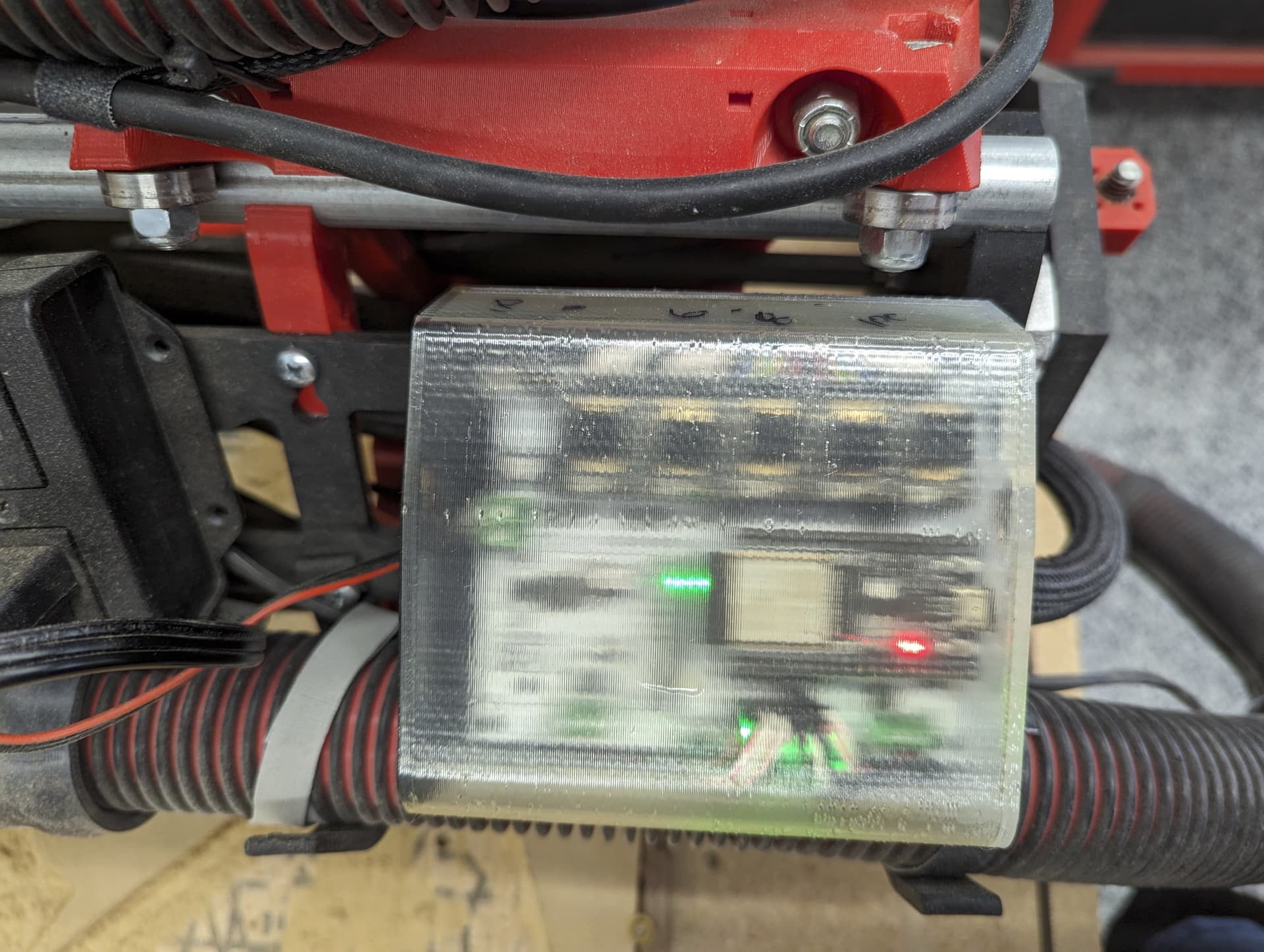

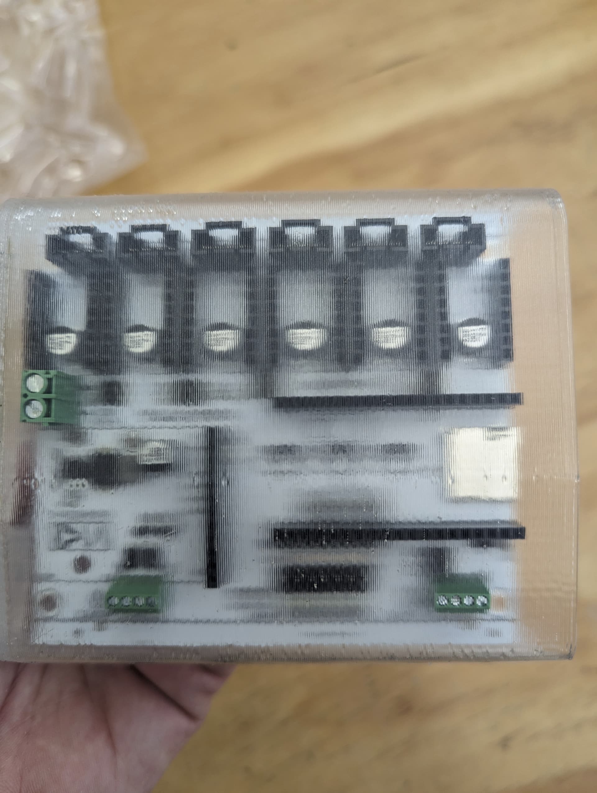

I am actually printing my third clear pla case. Playing with settings to see how clear I can get it.
Thank you for the offer though!
Well??? Which PLA did you end up going with? And is it actually coming out relatively clear?

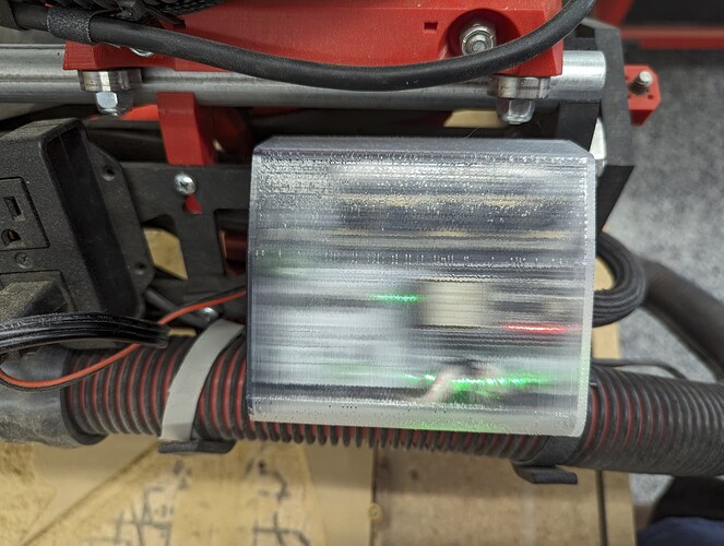

I got some sunlu clear from amazon. I made a custom file with a 0.65mm wall. Testing print speeds now. 60% up to 110% So far no major difference.
It is super clear to close objects but the diffusion is insane with any sort of gap.
This one is almost done, Then I will try it one more time and share some pictures.

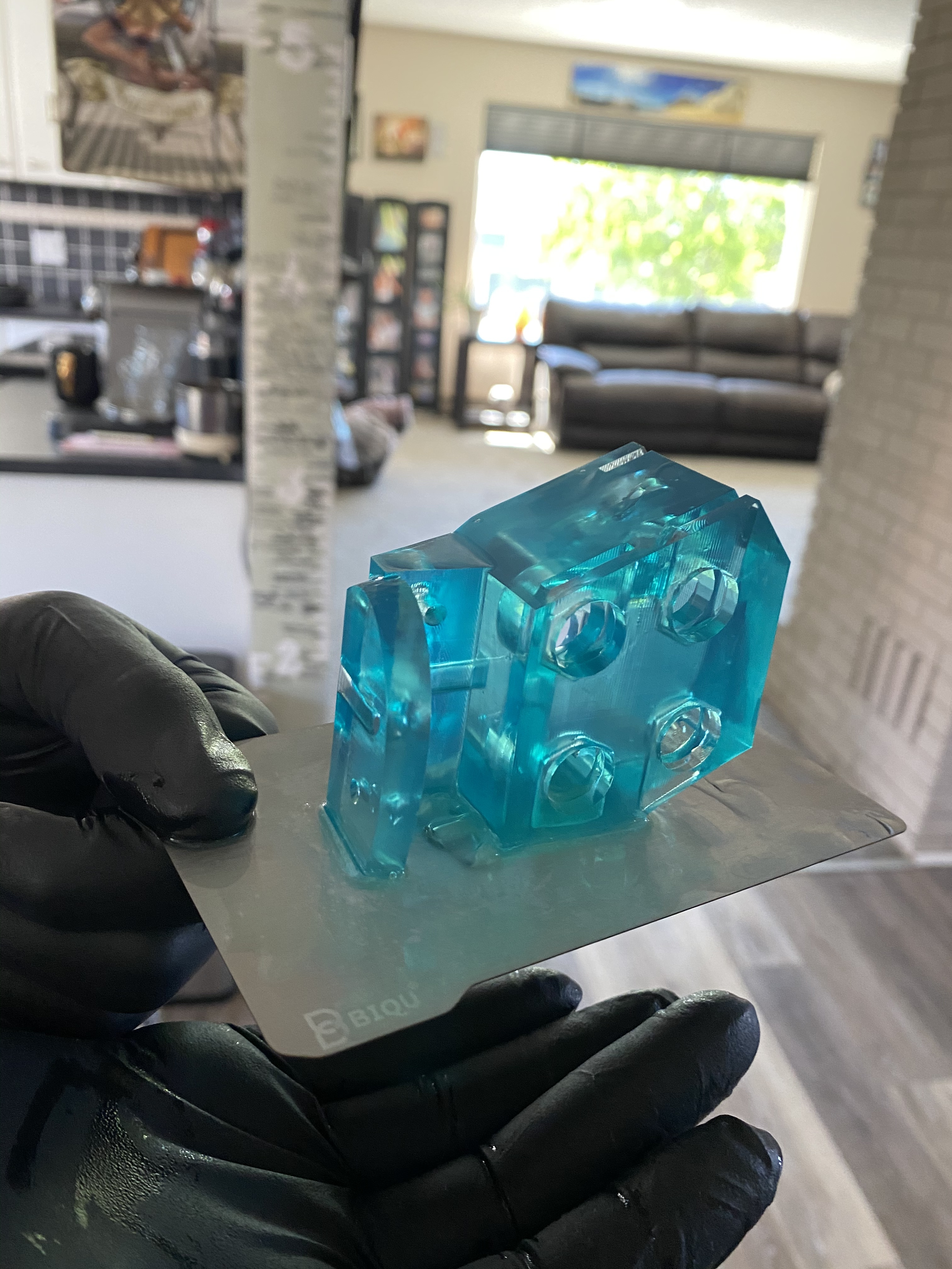

They can be pretty clear depending on the resin you use. Here is an example of a case I printed for a PCB I designed that turned out as clear as glass with a little processing work after the print.
xFlasher Case (USB C) by Element18592 | Download free STL model | Printables.com
Straight off the bed I sanded with some fine grit sand paper and shot it with a coat of clear and it turned out great. The downside to the resin I ended up going with was it has a bit of a yellow tinge to it and that shows on the corners but with the right resin and some very light post processing it can turn out amazing.

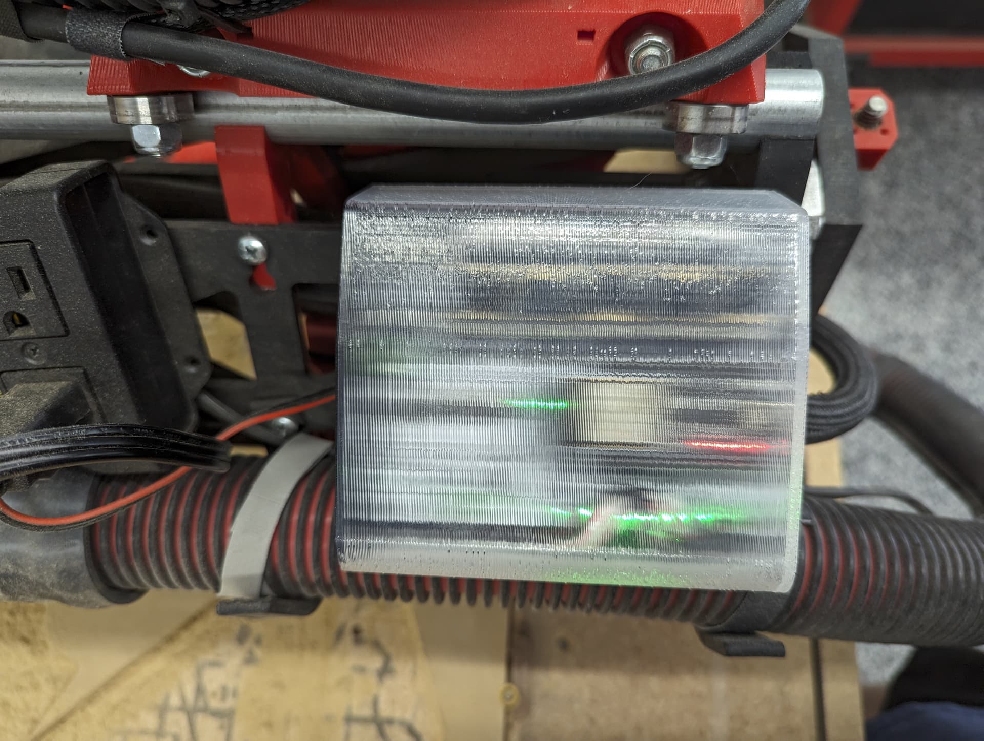

I have clear poly here and conformal coating. I want to go grab some regular clear paint. It is a huge difference.
That looks great!!
Two quick coats of poly…turning yellow, but nice.
Fresh print.
I think clear spray paint will really help. Soooo close to what I want. Yes crystal clear would be awesome but the poly coated one is good enough if it wasn’t yellow.
Up close it looks real good. I could make some light tunnels and really make this pop.

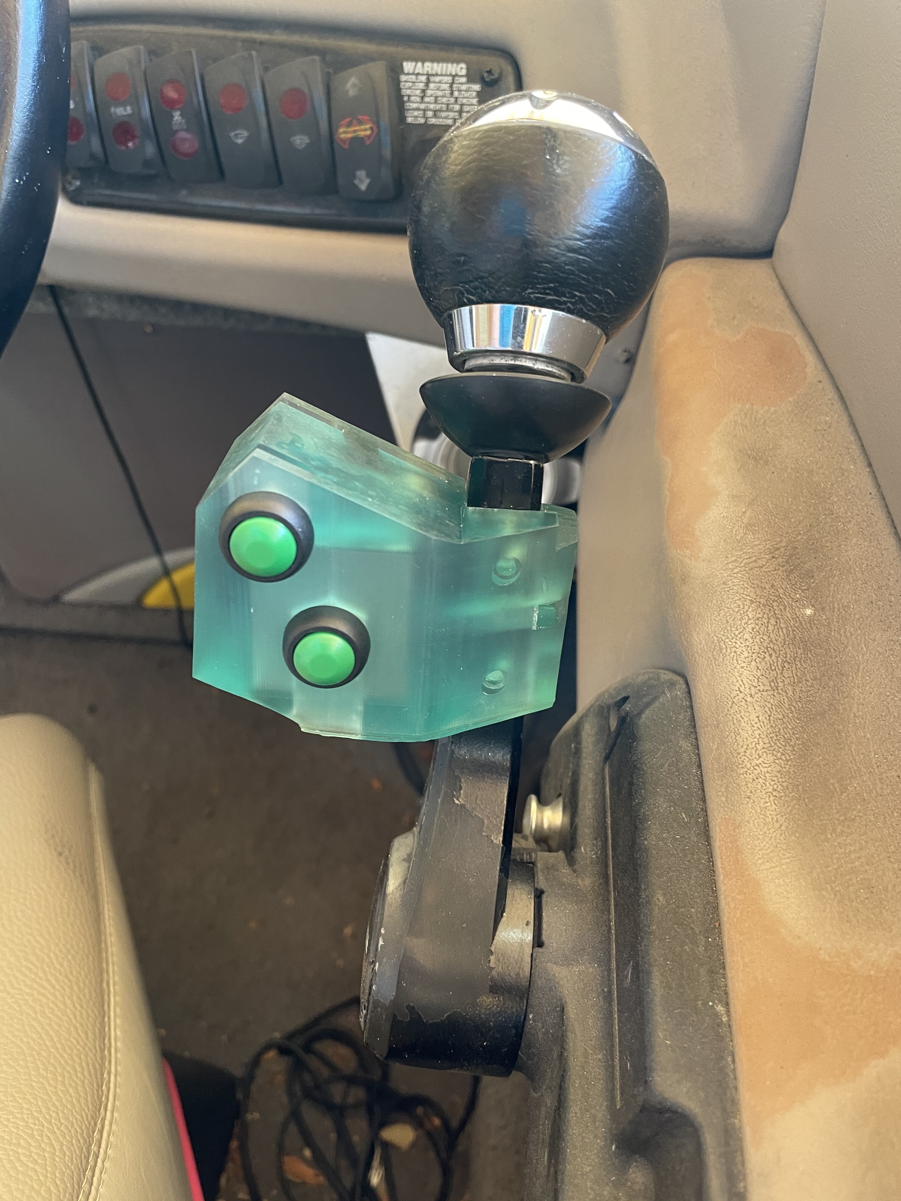

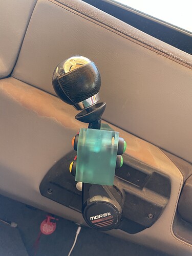

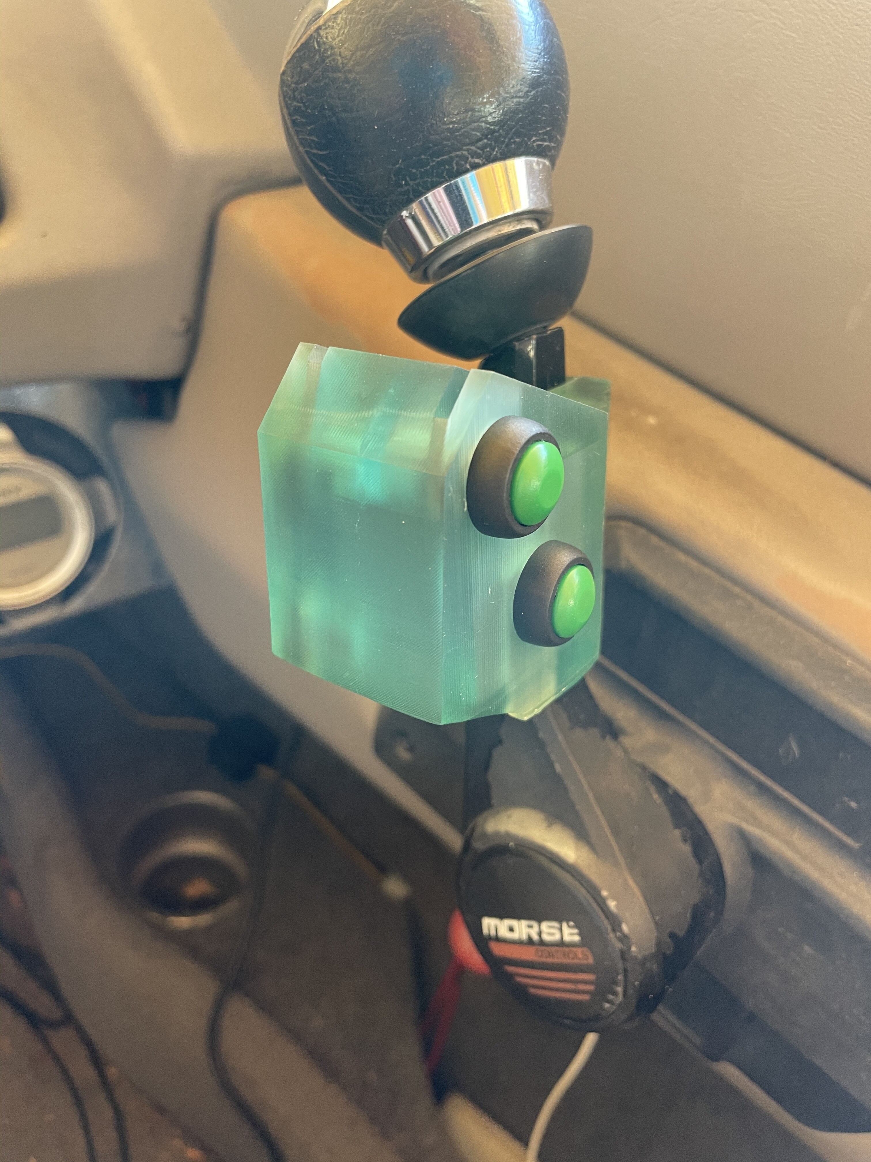

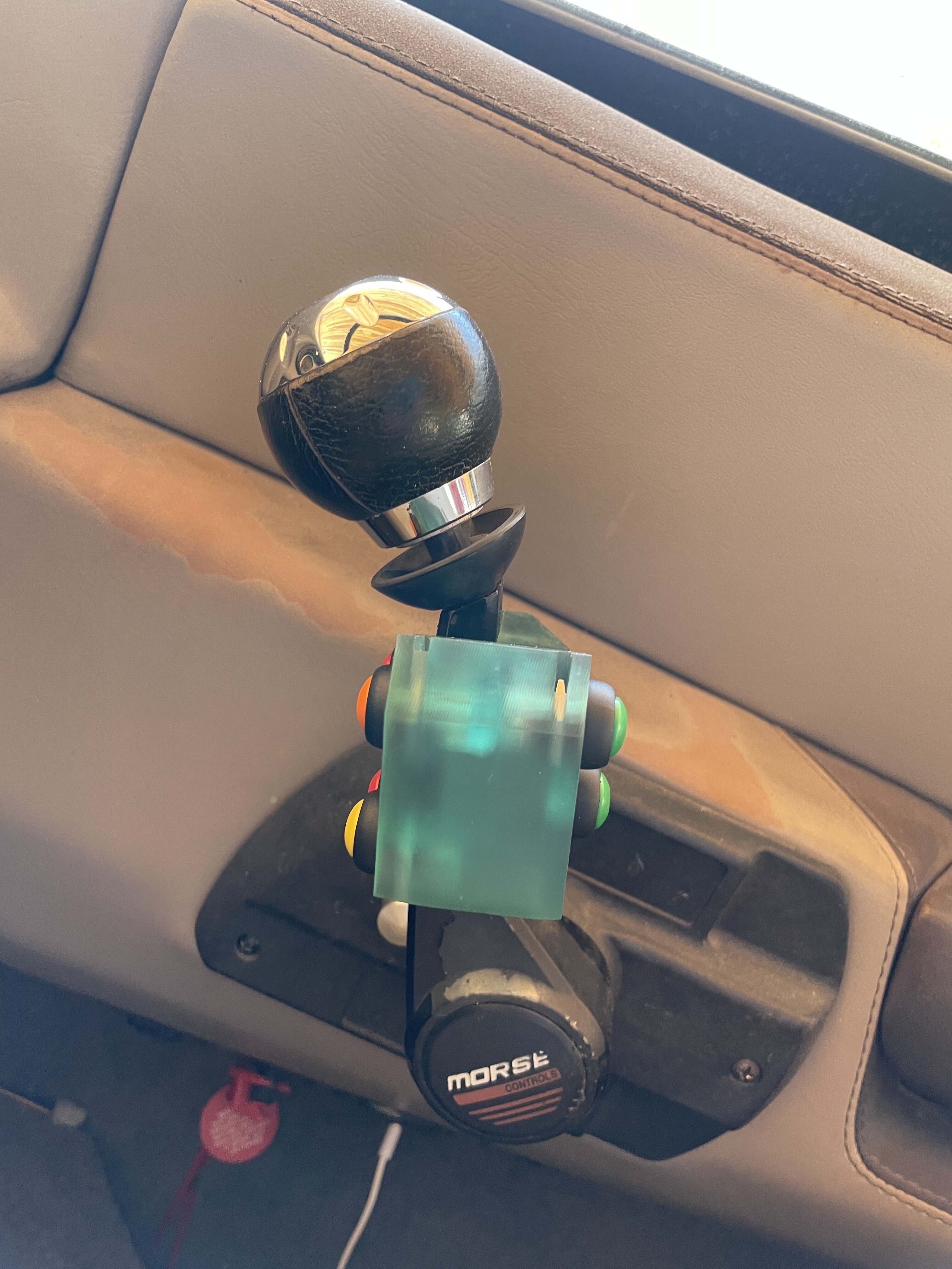

Here is some examples of clear resin I have done. I don’t have a uv chamber and the sun can really affect the yellowing.
WAG… Trim tab buttons???
