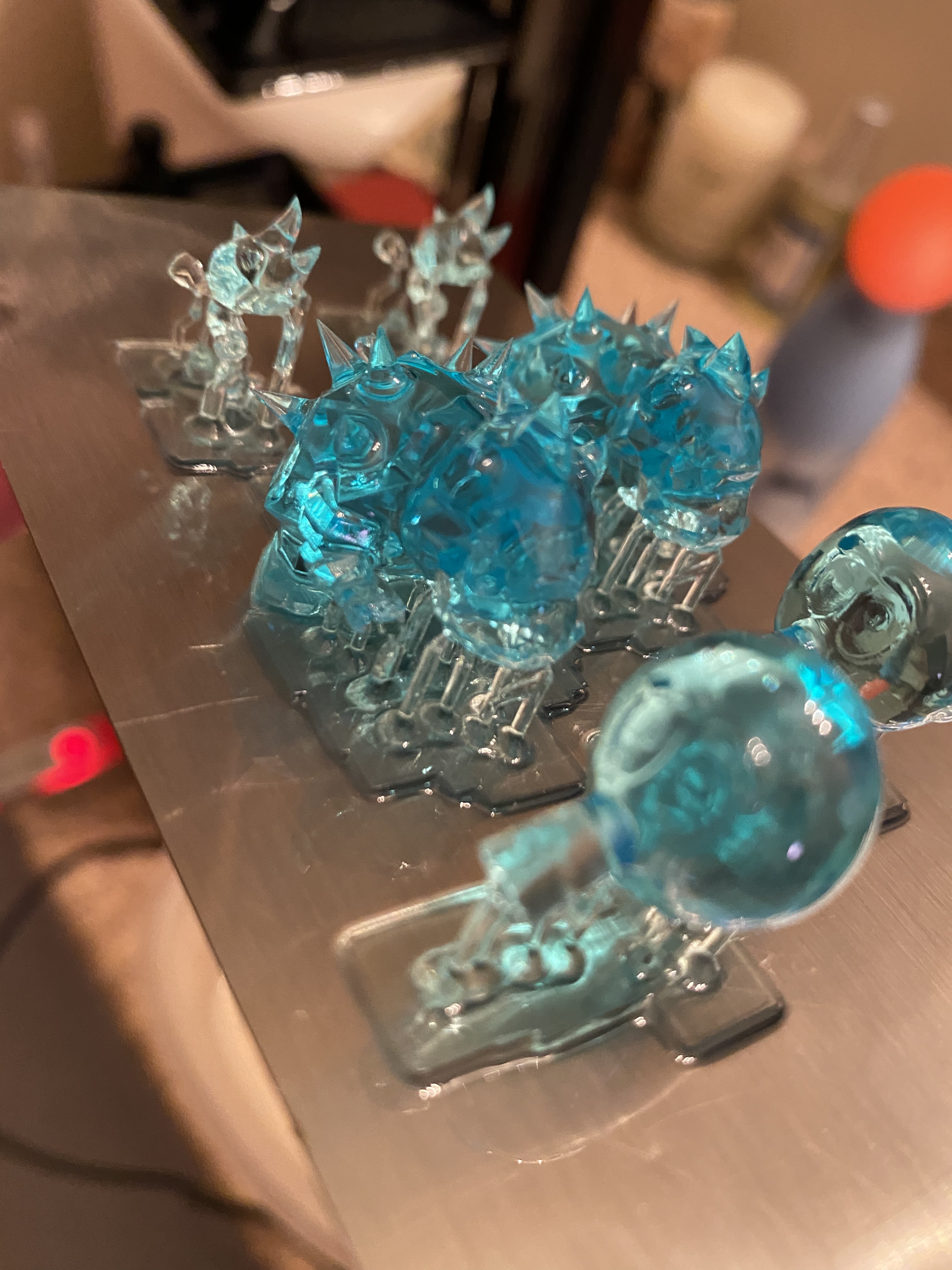

How clear are resin prints?

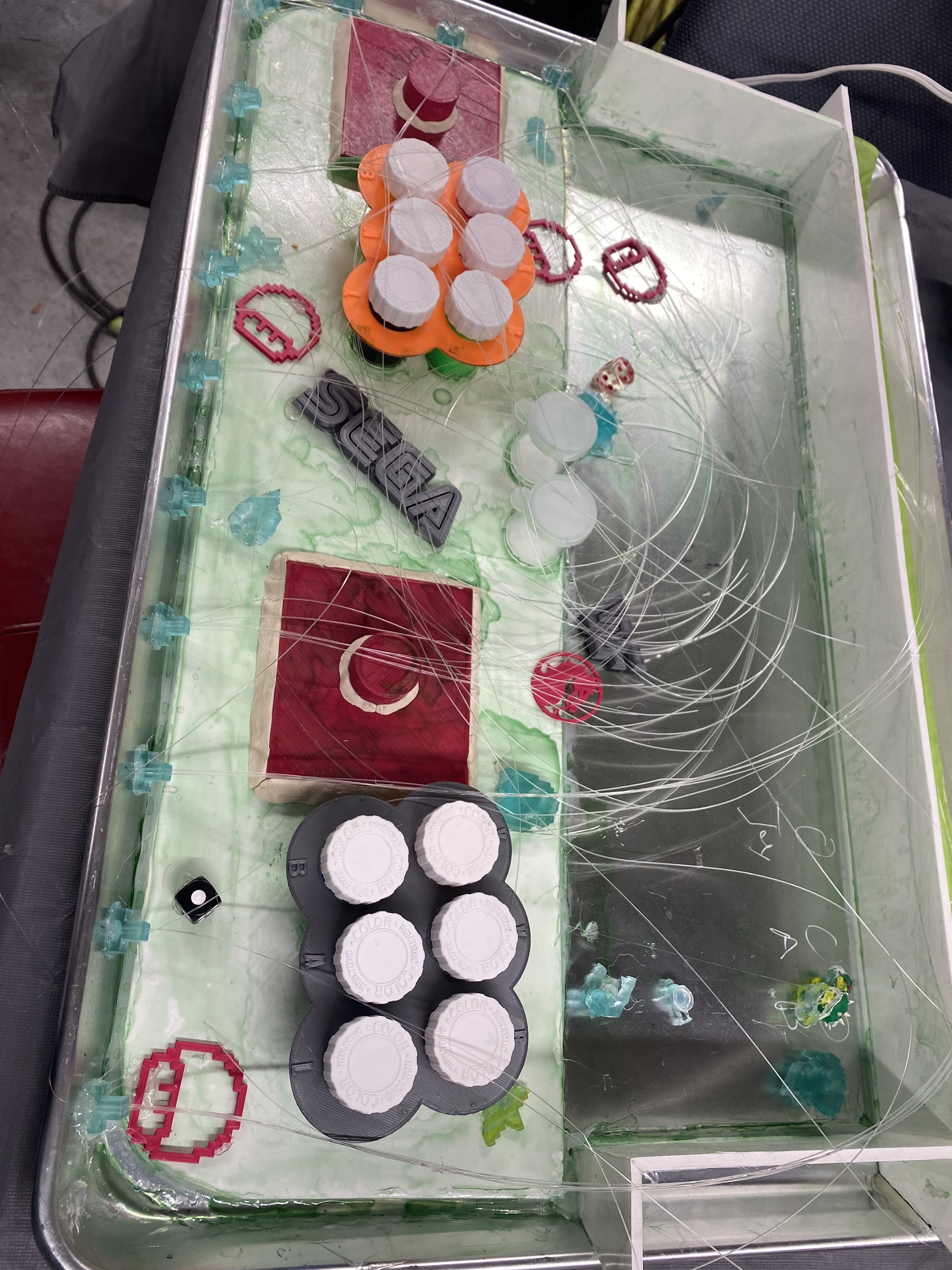

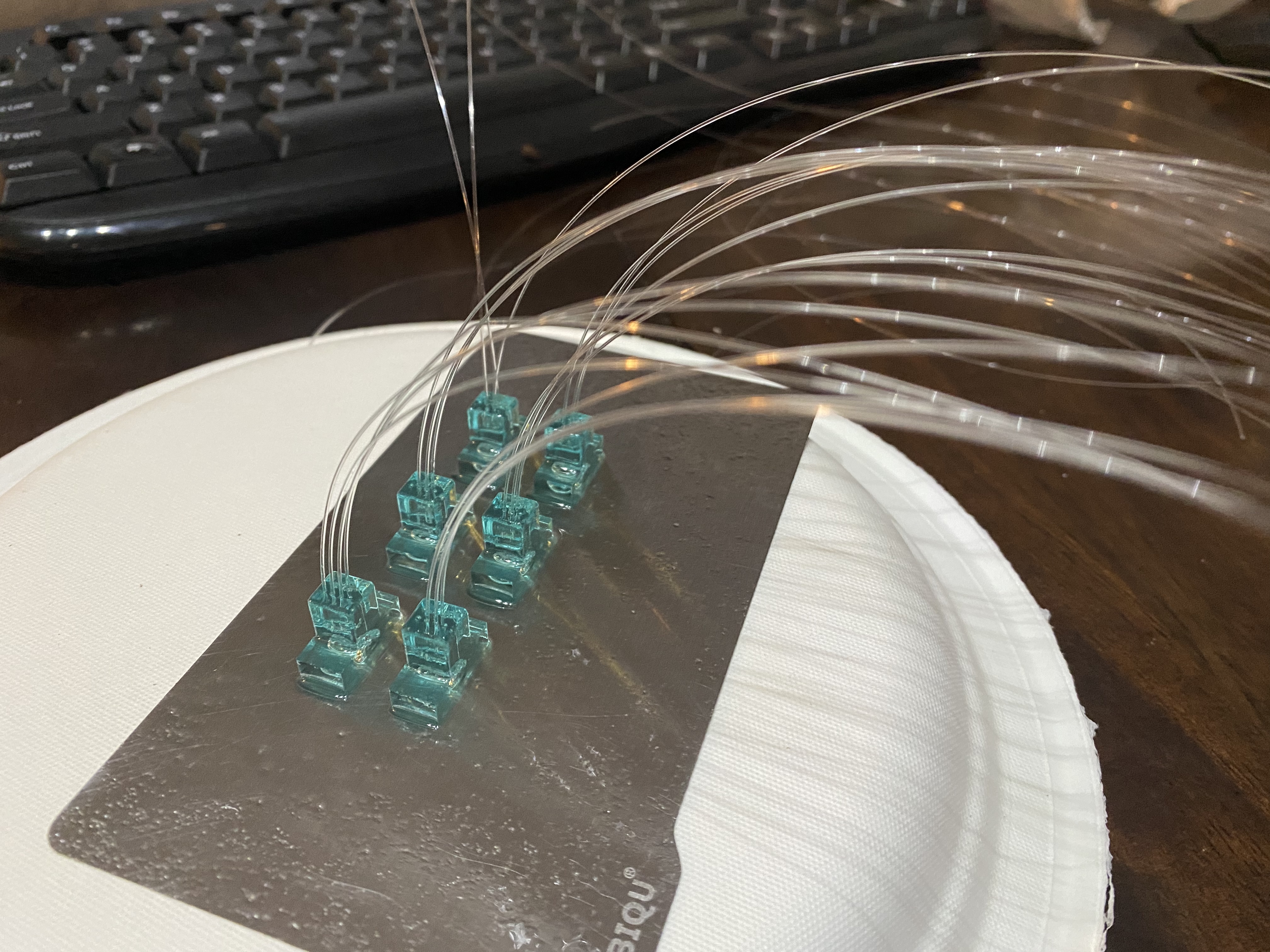

I have used the clear blue to make some neat end glow light up figures. And made some 3mm led clips that you put on the strip lighting to carry the light to the figure via end glow fiber optic
I set the fiber optic in before I uv cure to glue them in

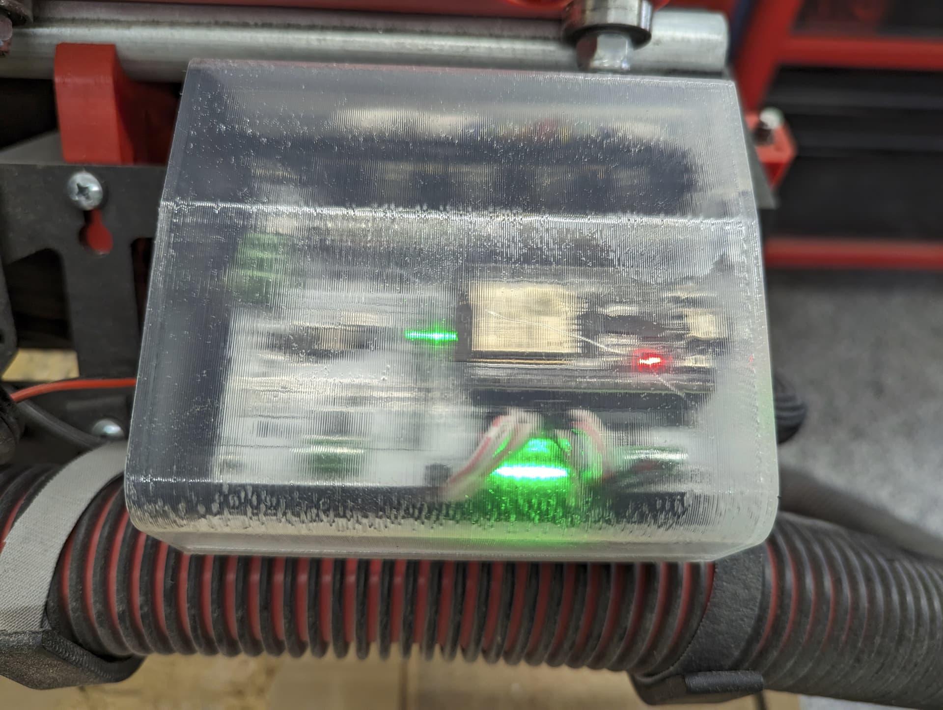

That is like 3 coats of clear. If I printed with thinner layers and prepped a bit better I think it would be super clear. This shape made it hard to use a thick paint like this without getting runs. Clear makes that even harder.

Thanks, if the board was closer it is super clear, being that far away it is super diffused.

I wonder if a thin coat of that epoxy after sanding might fill those layer lines easier and make it a bit clearer
I think it would. I used an epoxy product years ago and it worked very very well. I have some epoxy here I was going to try it but I got side tracked.
I don’t know. Maybe it’s just me, but I don’t care for the blurriness.
If it were me, I’d redesign the case so that either a flat piece of acrylic or even a bent piece could be used. Acrylic sheet is super easy to bend with just a heat gun and a sharp edge of something for the bend point and you can flame the ends to make them super clear too.

I agree, it is awesome to see through a bit more than it was. That quickly wore off, now I want clear.

The biggest bummer is at about 1" it is very clear. So maybe if I try smaller layers, or the epoxy.
Maybe an acetone bath???
I don’t see how adding a layer of something makes it clearer. To me, all that does is hide imperfections in the top coat. From a reflections point of view, it probably looks nicer, but looking through it really shouldn’t be altered much.
The acetone bath, OTOH, would smooth out the wrinkles and could possible make it clearer as you’re directly affecting the material instead of adding more on top. It’d be similar to the above idea of using an open flame to smooth/clear up the edge of acrylic. It may also be similar to using a flame or heat gun to pop bubbles in resin pours.
Acetone only works on ABS.
I think the clear just smooths it out and combines them. So instead of a tiny lens at each layer it makes it closer to one giant lens.
Straight off the printer at close distances it is very very clear. The better the clear coat the better it looks at further distances.
