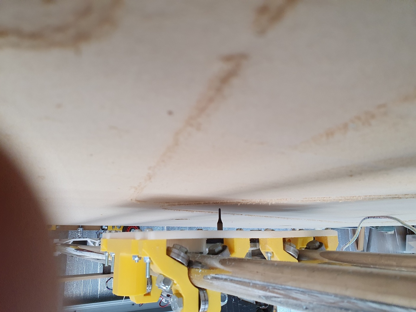

  3. It turns out my bed is quite badly concaved - buy almost 3mm. So while the cuts are nice and clean at the edges of the X-axis, by the time the router bit is in the centre, it isn’t even touching the bed. (See pic). How do I resolve this? From what I gather, i have three options: (1) Level the bed using a planing bit (basically cut a pocket) (2) Build up a 3mm border all round the bed, and pour in some extremely low viscosity resin - the kind they use for vacuum infusion - the stuff is like water) That will absolutely ensure a perfectly flat surface (3) Do both.
My wheels run in two channels with a 8mm deep groove routered out along their lengths. The wheels do not touch the bottom of the groove. There is a 2mm - 3mm clearance. I would need to use the resin to level these grooves alsoThat way the rails and the bed are both as level as possible.

I wouldn’t mess with leveling with epoxy. It’s a waste board after all. What kind of support does the center of your table have? Maybe it needs to be built or jacked up a bit. Other than that id flatten it with the router.
Hi,
Yep = a pretty weird bearing. The support for the bed is a humungusly heavy table I sourced somewhere. On top of that I’ve laid a panel of chipboard used for flooring here in Aus. And then I have 20mm plywood. Weird thing is, the chipboard seems to be pretty flat, but the plywood isn’t. I’m now going to remove the plywood, and use the chipboard as the sacrificial layer.

The epoxy isn’t perfect anyway, because if there is any flex in the tubes, it will be slighlty lower in the middle.
But that is so far off that even if you do plan on surfacing the spoil board, you should try to fix that a little.
Fix “that”? Which “that”?
Your spoil board is so sunk in the middle, I would shim that up first before trying to surface it.
Ah… Thanks. Done. And looking much better. I think it’ll do till the surfacing bit arrives next week.

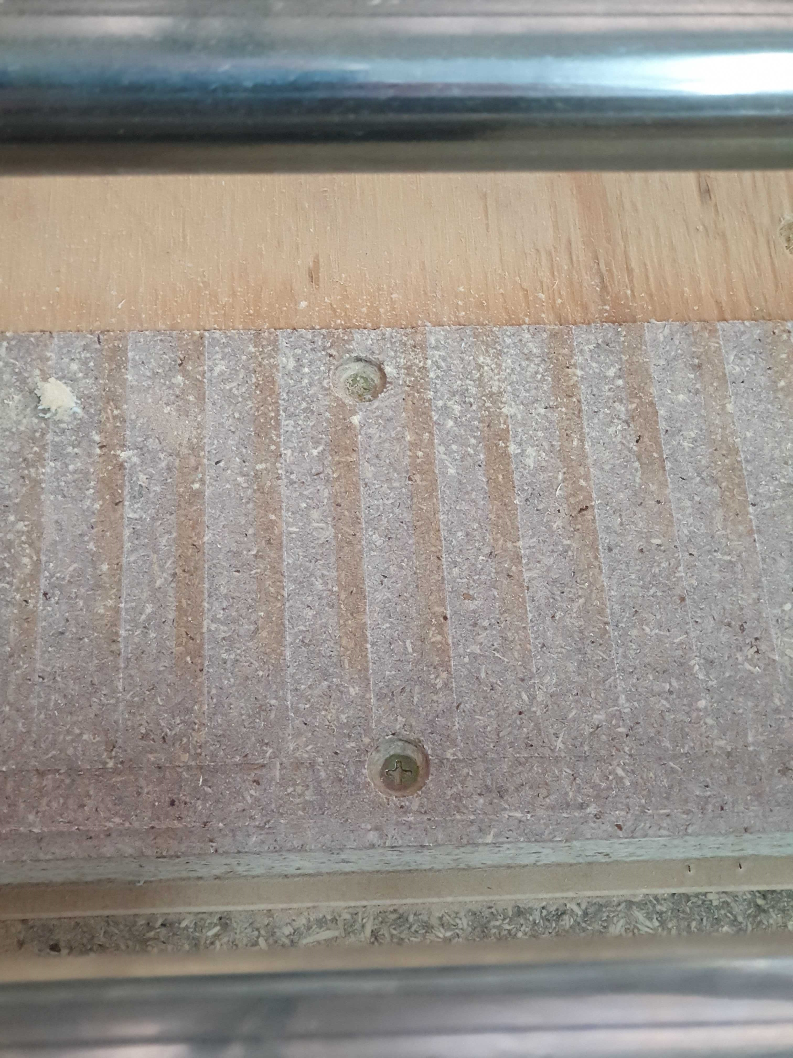

Hi. New challenge:
I used a 16mm straight bit to re-surface my waste-board. Wow! It had some extremely high spots, and some slots that were too low for even 3mm of bed levelling to touch. But the waste board is 21mm thick, so I have a good safety margin.
Problem is, I’m using Estlcam to create a pocket for the entire 2440 x 1220 bed, with 75% stepover. So far, so good. Except that each 2nd pass of the bit leaves a ridge (see photo)

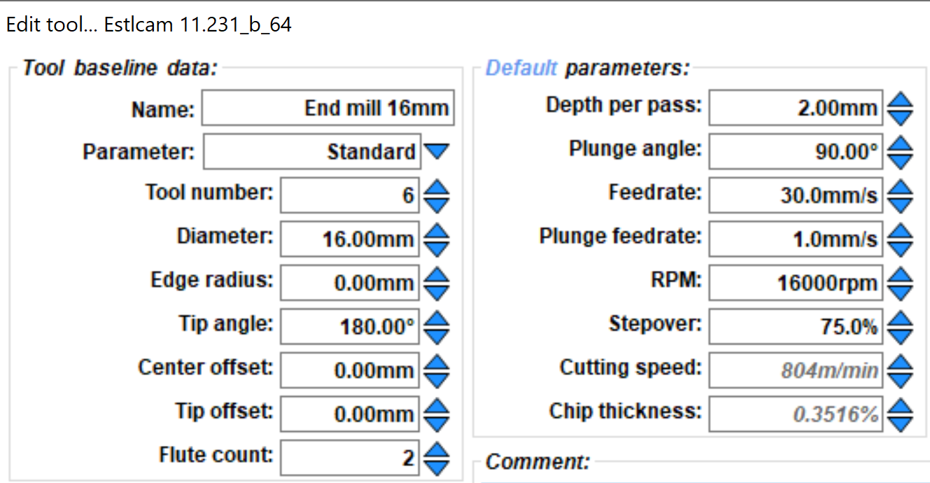

The tool:
The tool settings:
The results: Every 2nd pass only
Can anyone see what I’m doing wrong? I’ve checked the verticality of the router but by mounting a 6mm rod and checking all sides for 90 deg. As far as I can tell, it’s all good. Is my feed rate too high? Stepover OK? RPM?
I have a 30mm planing bit arriving next week, but I thought I’d get a head start with the 16mm bit.
Regards,
Duncan
The two things that come to mind are if the bit is not perpendicular or if it is deflecting under load.
If the bit is not perpendicular then one side cuts deeper than the other. If the direction of travel has the deeper side leading, then it will cut at the outer edge, but if the deeper side is trailing, it will cut using the bottom, which I’ve seen leave scorch marks.
You checked that it’s perpendicular but when it’s under load it could deflect away from perpendicular. In one direction the tool deflects one way and in the opposite direction the tool deflects the opposite way. This can also affect depth since the pivot is not exactly above the tool, which can lead to ridges even if your tool is perpendicular to start with.
I didn’t find an easy way to force CAM to cut in only one direction, and it is simple enough that I wrote a surfacing generator for my test pattern generator. You can specify the direction for cutting, so if you know which way your router is tilted you can cut with the deeper side leading. It also uses many short movements so you can use Octoprint’s feedrate adjustment while the job is running with only a little bit of lag.
Hi. Thank you for the suggestions. Perhaps I should slow down the feed rate. I’ll take a look at your test pattern generator also.
Duncan
Not sure from your description how you checked level, but a simple tramming setup with a long arm will give you accurate readings. Here is one from Thingiverse: https://www.thingiverse.com/thing:4128469 And if you search on this Forum for ‘tramming’, you will find pictures of a couple more.
To check for deflection, try a few very slow passes with shallow depth of cut and compare that to what you are getting. Your setting of 2mm for DOC seemed aggressive for a larger bit.
Don’t know if it is available in Estlcam, but in Fusion 360, the direction of the cut is controlled by setting ‘Direction’ to ‘climb’, ‘conventional’, or ‘both’. So you can look to see if those terms are available in your Estlcam facing operation.
