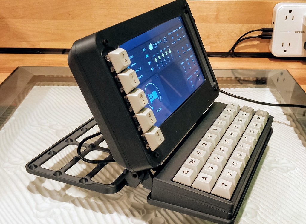

The waveshare ones I have are pretty decent. You print your own enclosure, but you can also adjust the brightness with pwm (if you’re into that):
I was internet famous for a week or so because of that project. It sits on my nightstand and still works fine. I update it occasionally.

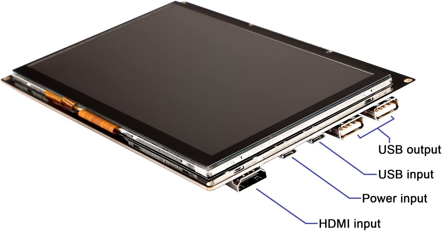

How do you connect the touch if I were to connect it to a PC? USB-A? The Boards we have at school use USB-A to USB-B for the touch capacity, but it might only be that way so stupid people don’t connect their “normal” USB to it and are confused. :confused:

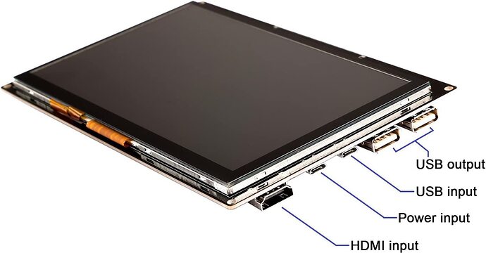

Mine has 1 HDMI port for input, one micro-USB for power, one micro-USB for touch communication, which also connects to 2 USB-A ports which are connected as a USB hub. These ports seem to work, but don’t supply very much power, and don’t work well for things like wireless keyboards or wifi dongles.
This is the picture from the Amazon listing Amazon.ca
Yeah. The micro USB to USB-A cable shows up as a touch screen (at least in Linux). The other USB for power is separate. The HDMI is also pretty separate.
