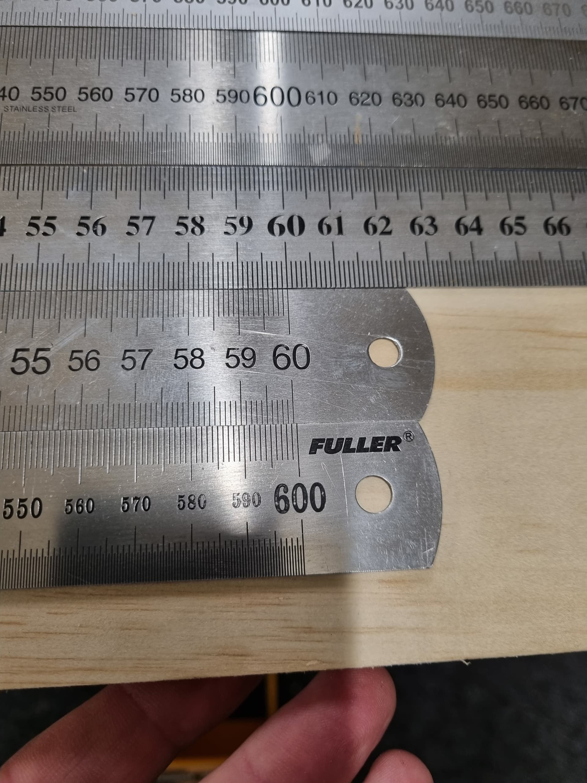

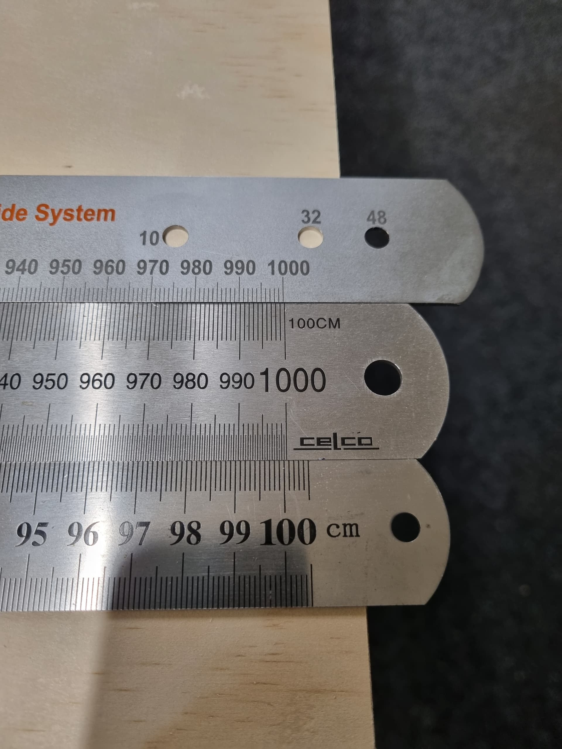

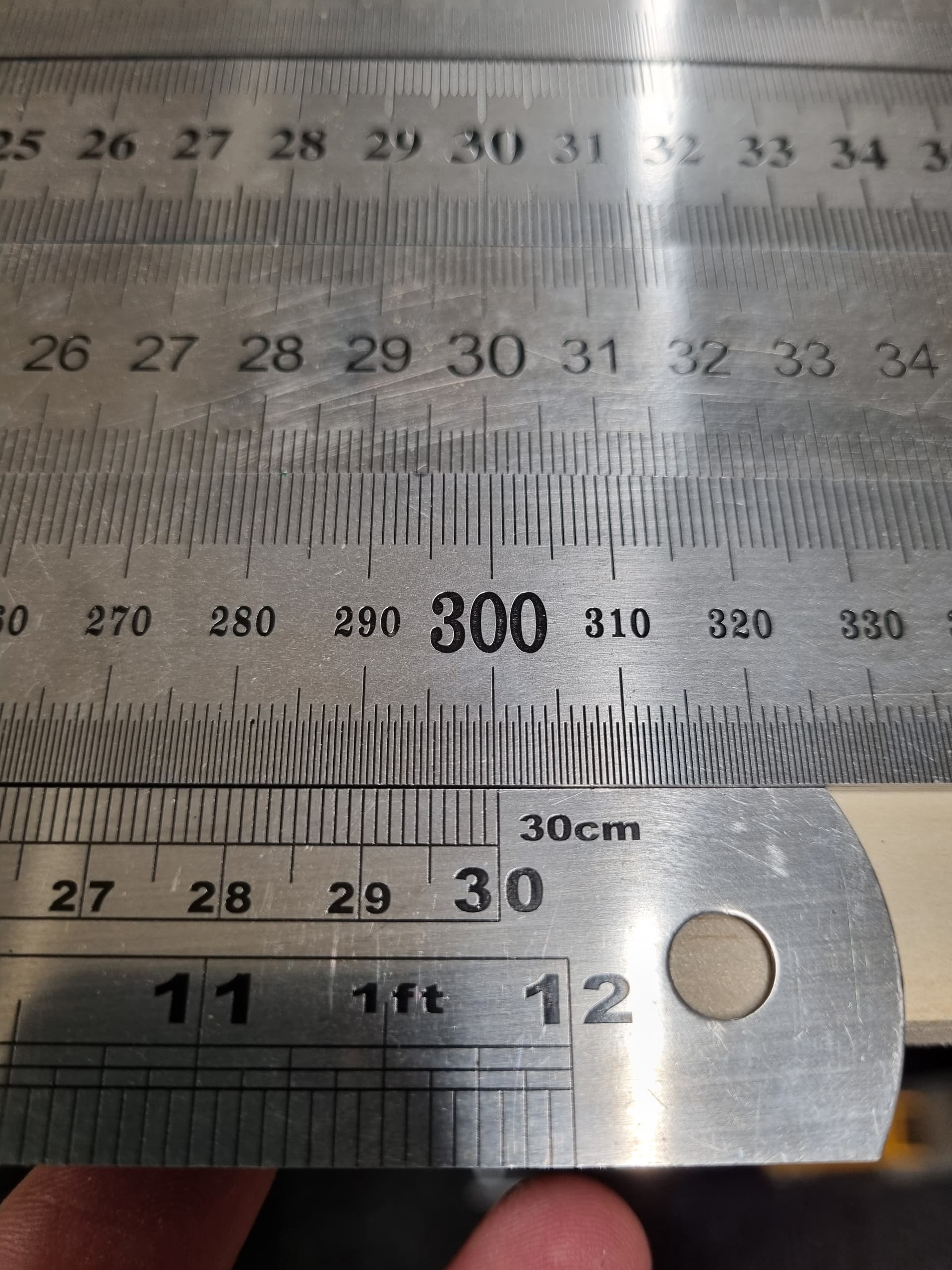

Just found these photos from when I was going insane trying to chase down some weird measurement errors.
The top 1m rule is one of the parf sticks included with the parf guide system, which is basically a class-1 steel rule with holes precision drilled into it.
Since then I have acquired a separate class-1 1m steel rule from a different manufacturer and a class-1 measuring tape. Both parf sticks, the 1m steel rule and the measuring tape all agree to well within my ability to use them.
All of my measuring devices are from Harbor Freight lol
I will keep my ignorance and not line them up lol
