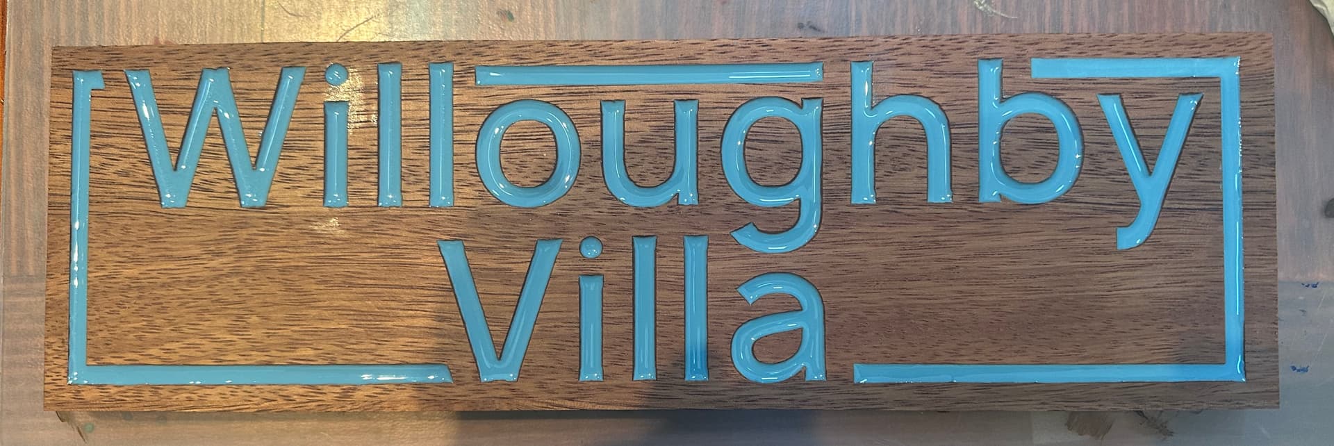

Been a little while since I’ve posted :slight_smile: Still getting random commissions for things.
Hardwood vcarve with resin infill. Colour choice was the signs new owner. I made the design with vcarve.
I use Feast Watson sanding sealer to prevent the resin from spreading through the grain. After the resin dried, this was sealed with an oil/wax.

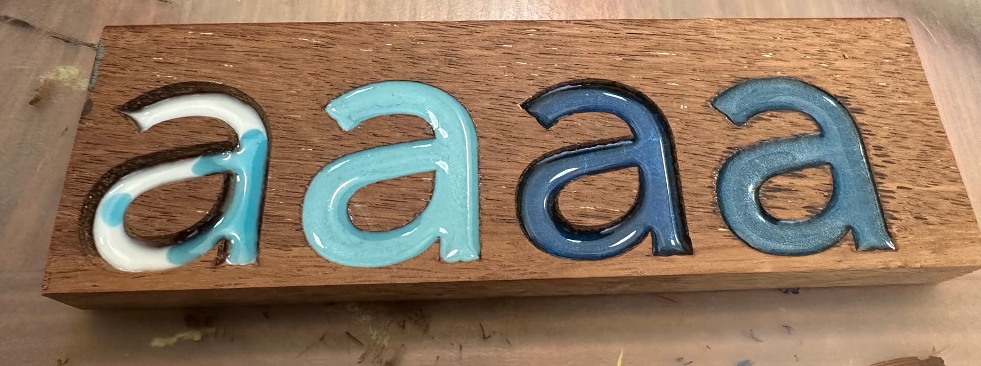

Here’s a couple of sample options I gave them for colouring where you can see the problem when resin runs (in the last a it’s obvious)
She was very happy with the outcome and it’s hanging on her house now!

Interesting approach to resin. I always overfill it and make the carves a mm deeper (starting level -1mm) so I can just plane down the top layer. Eliminates the need for bubble hunting and makes one completely even surface in the end. Also, you don’t have to pour that precisely. I do like your method as well though. :slight_smile:
i’ve never had much luck getting the shine back when i fill up and sand back. it’s possibly the colouring i’m using. i actually like the slightly under filled look though - it gave a nice mini shadow to the sign and looks like it’s expected :slight_smile: plus it stays nice and shiny!
I like that idea. I can’t get the same shine either. As long as it is not a cutting board I think I will do a slight underfill as well from here on out. I like the look it gives.
