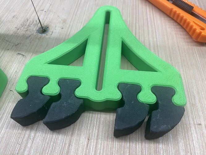

Well, here’s the very first foam cutting I’ve ever done. Feather boards for table saw fence setup.
The motor controller I ordered has not arrived, but I just moved quickly, and used the on/off switch frequently to try to keep the wire from getting too hot.

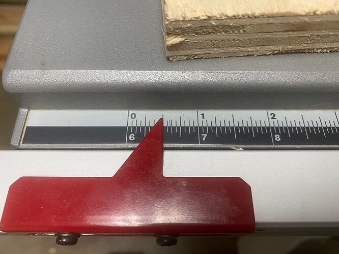

Got the neat rip-fence mod done for my table saw. Works great, and because the calibration of the fence measurement is as easy as loosening a couple of screws and moving the little pointer part, I was able to adjust for the 15mm of added thickness quite easily. I

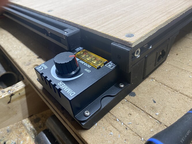

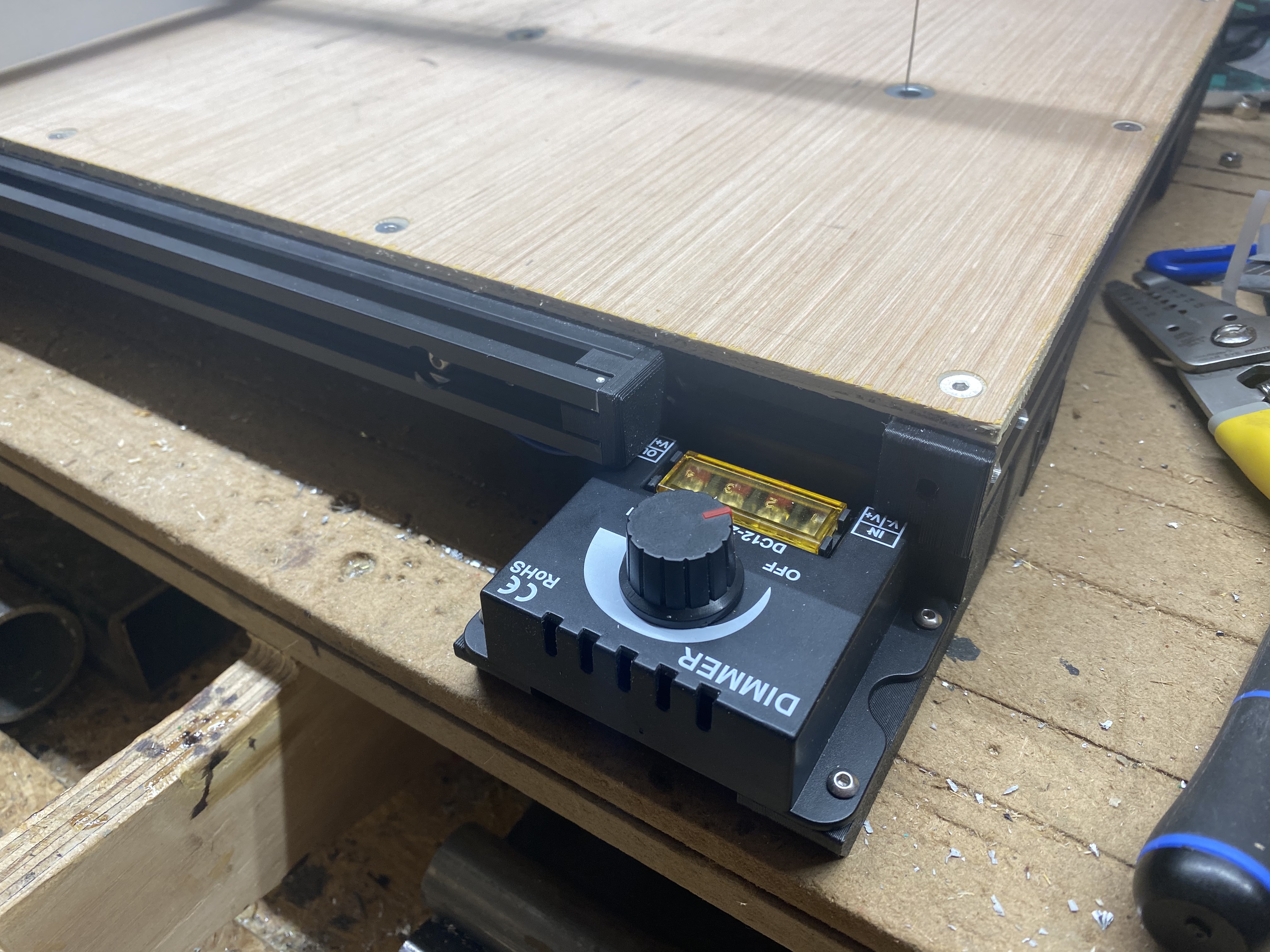

Hey, everybody. Just circling back to add another update about the foam cutter. I installed the cheapest PWM “dimmer switch” “voltage control” thing that I had found and bought — and as far as I can tell it is working fabulously. If it burns up or gives up the ghost in normal usage, I will definitely come back to give everyone an update. However, as far as I can tell, it’s doing exactly what I hoped it would do, with a really great level of precision on what I need as far as flexibility on the control of the temperature of the wire. Using printed mounts that are also feet I’ve integrated both the AC-DC power supply and the dimmer switch.
