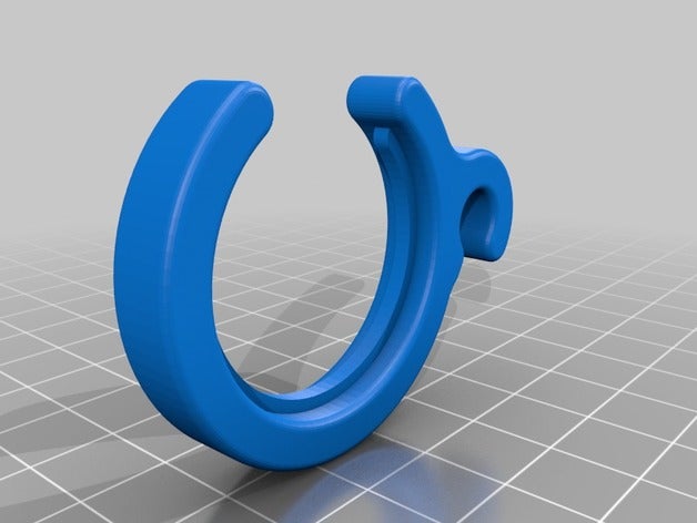

So my real question though, anyone here good enough with designing to get a 3D print file created for this? I searched thingiverse.com and didn’t immediately find much that wasn’t a true “clamp” as this is more of a compression fitting.
This one is close but is Festool size specific and not very universal.
This would be a great first CAD thing to make. It is primarily just two circles, with some cuts and an offset.

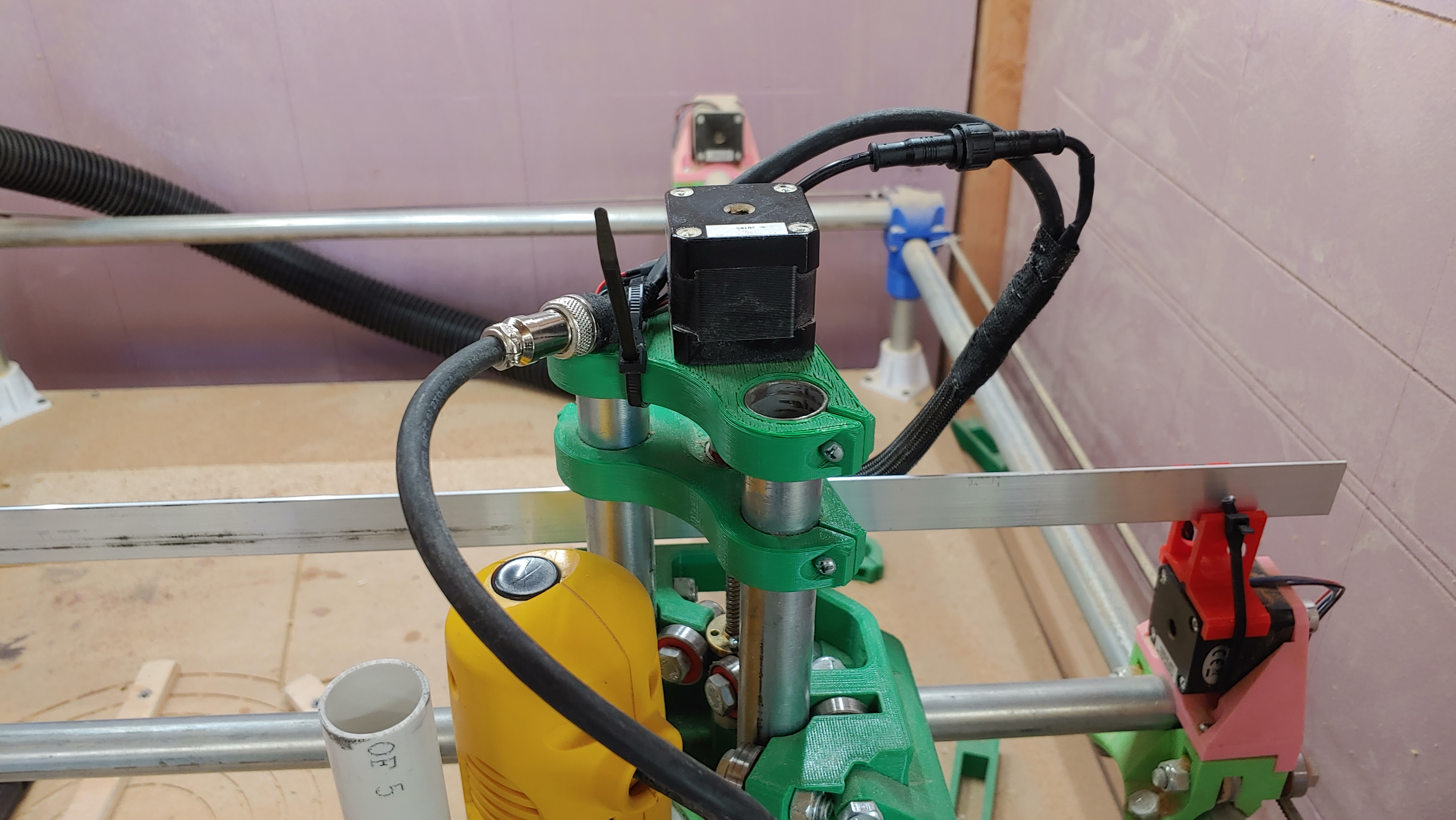

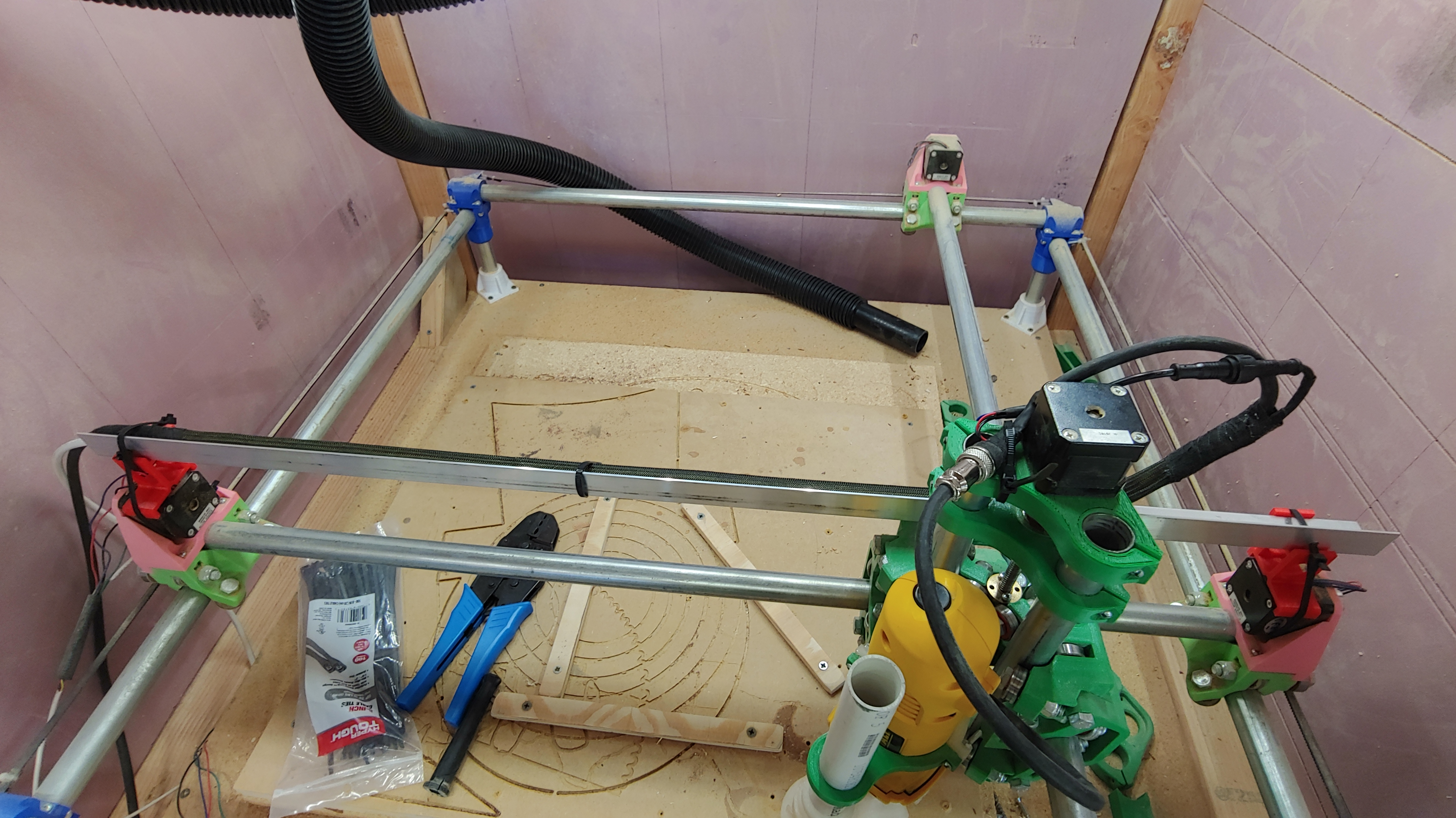

I went the aluminum angle route with my Z axis cables. The vac hose is still dangling from the top of the enclosure so I can take it off and clean the spoiler board after a project

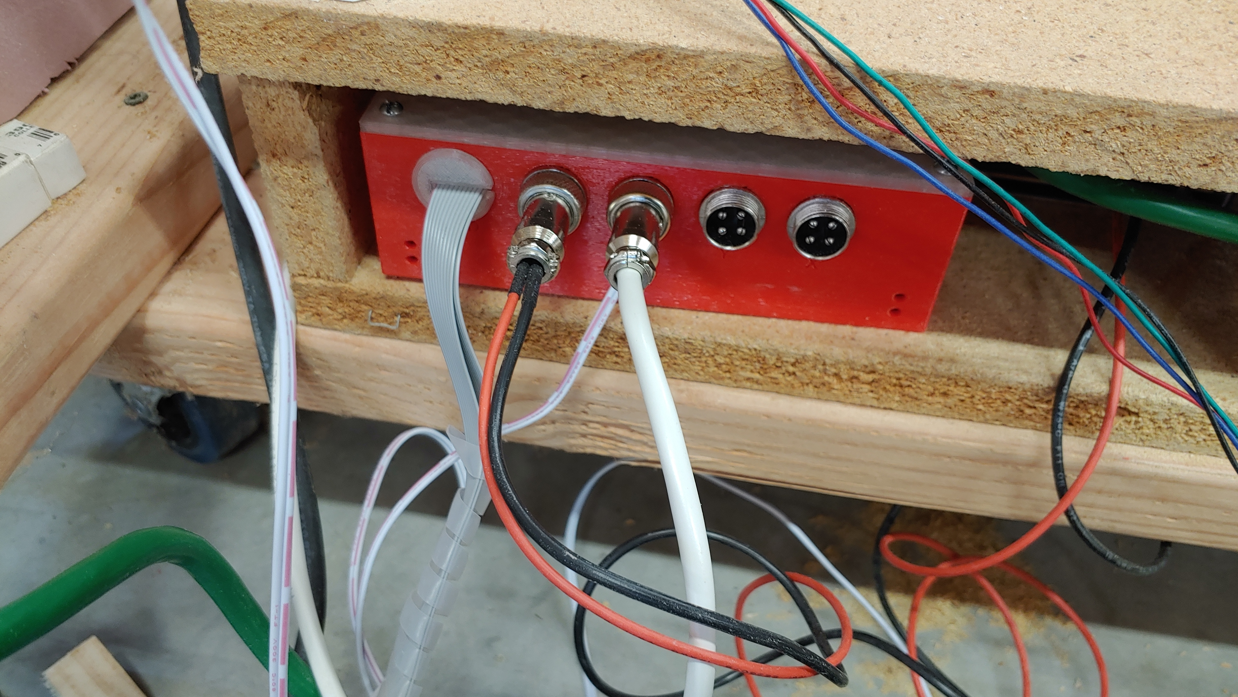

@niget2002 where did you get your cable connectors? I’ve been seeing lots of people using those and the cat5 cables too, but I haven’t really looked into that much. I’ve never used them before so not really sure what to look for.
I began my cable management last night and more often than not I would just sit there and stare at things not sure what to do about each situation. I am using the cables provided with the kit but obviously some are really long (close to lower left corner) and some are BARELY long enough to get to the lower left corner (where I want my control board).
Aviation plugs…
https://www.amazon.com/gp/product/B07D7SHKGK
The router connector is an aviation plug, but the stepper connectors are these:
5 pairs will do 1 MPCNC with no mistakes while soldering :blush:
That’s why I got the 10-pack… :wink:
Since it seems these are just pigtails, what did you use for the overall length between them?
According to Ryan, any 22/4 stranded cable will work. Most big box stores will carry 4-conductor alarm cable that should do the trick. Cat-5E/6 would also do the trick, just gang up the pairs for each connector.
I’d rather use what’s most convenient and with the easiest maintenance, even if it costs a bit more. What does gang up mean? Is that when you need to use a magnet for interference? I’m not real great with the electrical side of our machines.
Sorry, Cat-5/6 is made up of four pairs of wires. What you would do is take each pair of wires, and connect both of them to one conductor of the pigtail. That’s what I meant by gang up the pairs. Green and Green/White go to one conductor, Blue and Blue/White go to another, Brown and Brown/White a third, and Orange and Orange/White the fourth.
