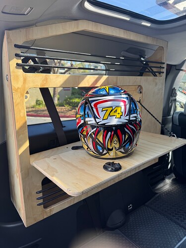

I designed a ripoff from scratch and made this on my old LR2. I’ve since sold the Honda, R.I.P, but it was a great little SUV. I never got around to making the bed part, but the cabinet , console replacement, and little desks were super handy.
(Since it was such a direct ripoff I won’t be able to share the files, the designer wouldn’t be too keen on that I’m sure! My design was from scratch though, just looking at pictures and tweaking.)
Pre finished 1/2" maple plywood, biscuit joiner, occasional pocket screw, black plastic edge banding.

It was a pretty involved process with a bunch of cardboard template/prototypes. Totally worth it in the end. Makes me really miss that car!

Even if I had the time, it took quite a bit of fiddling and adjustments (and cheater cuts with a jigsaw) to get it to work and pretty much needs an Element on hand to get the measurements right, so sorry I can’t help you out there!
Good luck with your journey! Even “stock” I was surprised how the seats folded into flat-ish useable beds, so I’m sure you’ll have fun figuring out storage that suits your needs.
