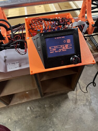

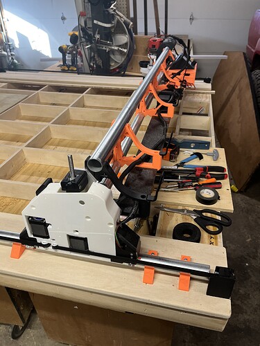

Hi everyone, first I want to saythanks for being here and all the knowledge everyone has generously shared. I am new to cnc and I’m trying to get started. I have finished my LR4 build and I’m trying to home it so I can then square it and so forth. My build is a 4’x4’ LR4 with a SKR pro/TFT screen.
First, somehow after my first couple attempts to move it individual axis at a time I lost the original screen layout and it seems to be just the marlin( I really don’t know what to call it) was a nice colorful screen with icons now just a black and red with text only.

Thanks for any advice.And yes I know I have endstops unplugged in the pics was taken while troubleshooting.
We call it “Marlin mode.” You can switch between the two screen modes by holding down on the control knob for a few seconds.

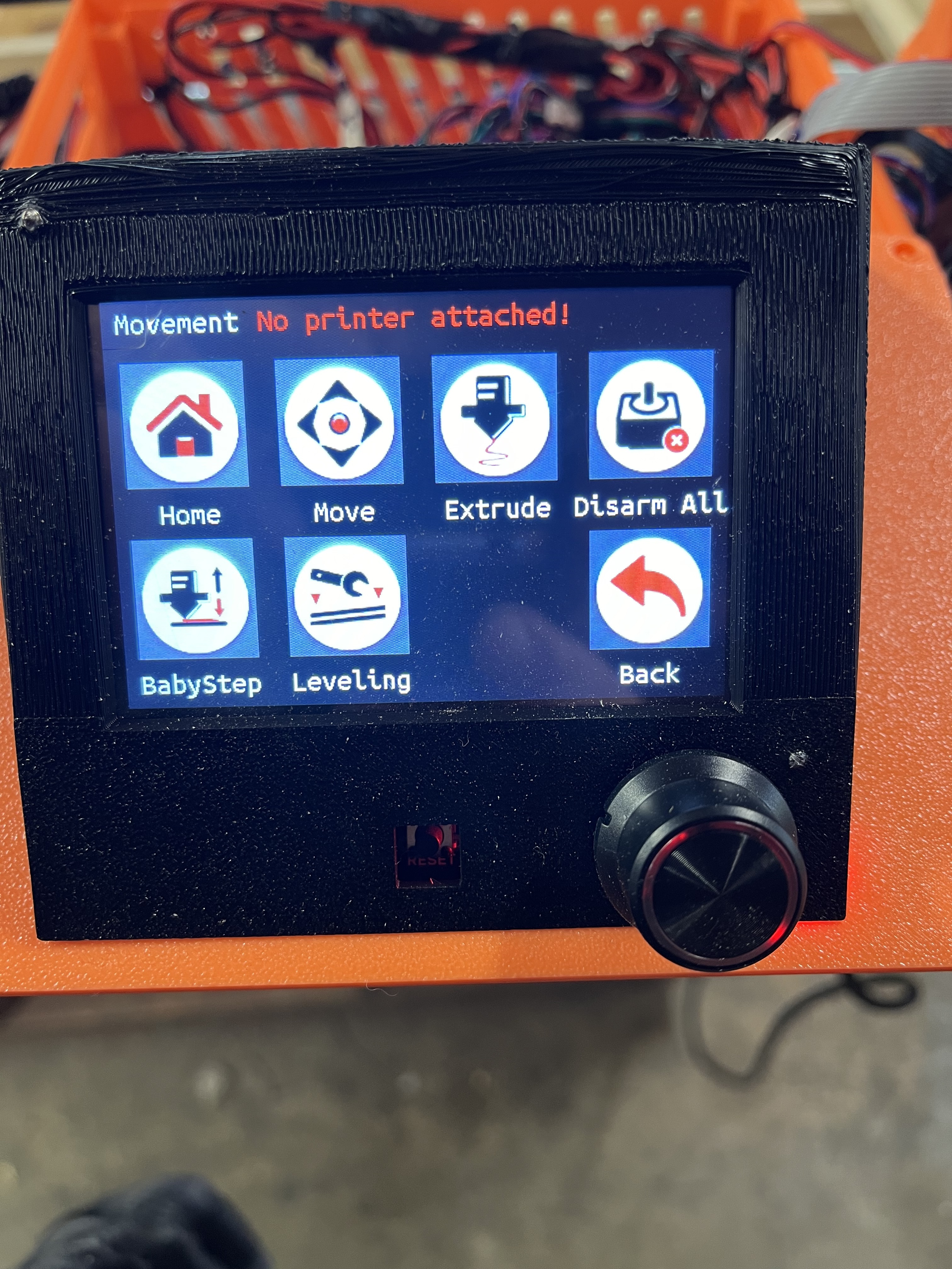

Ok got it to go into touch screen mode but when its there nothing works neither touch or knob. Says no printer attached. Also took a bit to get it into touch. In the screen with the two options (marlin or touch) I would select touch it would open touch then immediately go back to the two option screen. After doing that a few times I decided to be quick and touch an icon on the touch screen before it went back this kept the screen up but no touch or knob will respond.

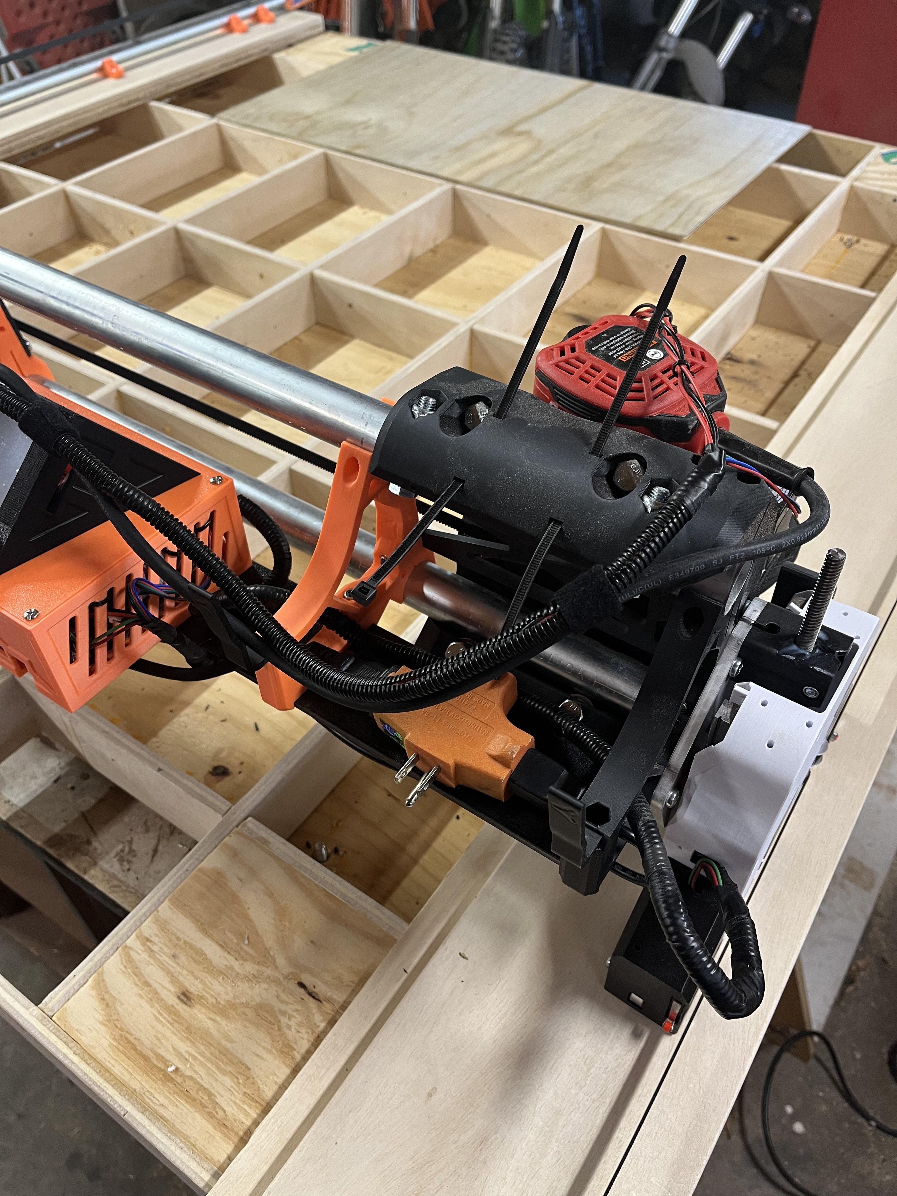

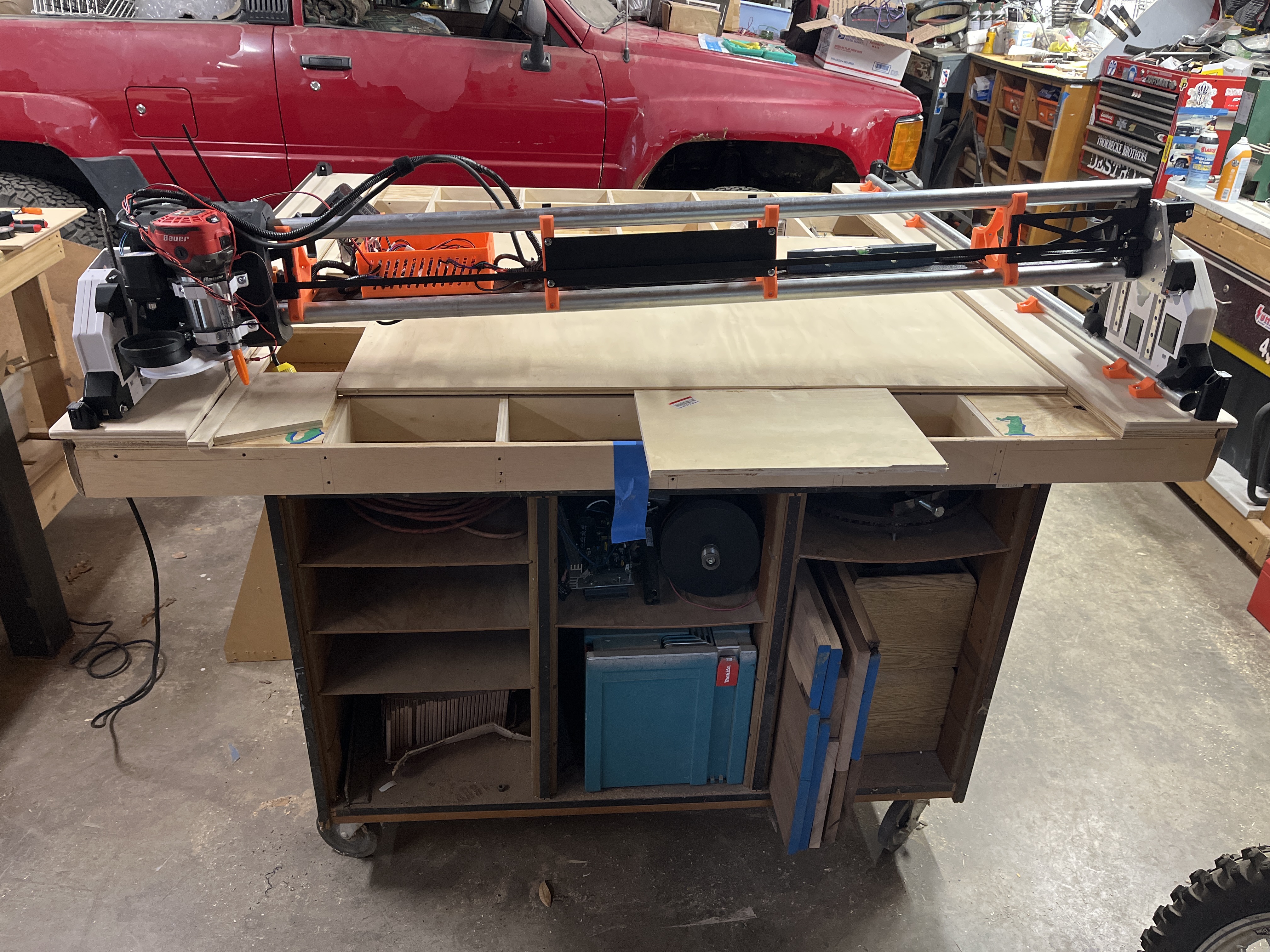

In pictures 1 and 2 I can see you have endstops on the ‘back’ of your trucks. You don’t need these and they shouldn’t be wired to the board - just confirm you haven’t.
Can you take your screen out of the case and try again - sometimes if the 3D print is a bit ticght it puts pressure on the screen and it thinks something is permanently being pressed.
Yes I got overzealous during the build and put an end stop in every spot before rereading they were not necessary. I just left them in place but they’re not connected to the board and never have been. I’ll try releasing the screen and see if that does it. I still have the protective film on it too.

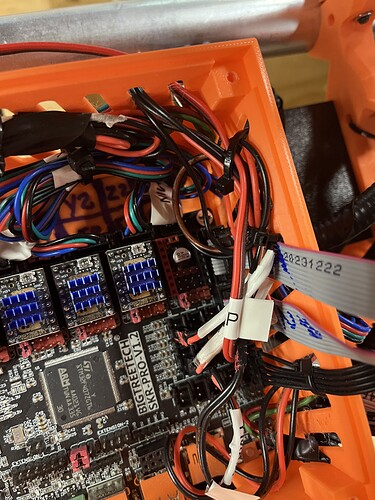

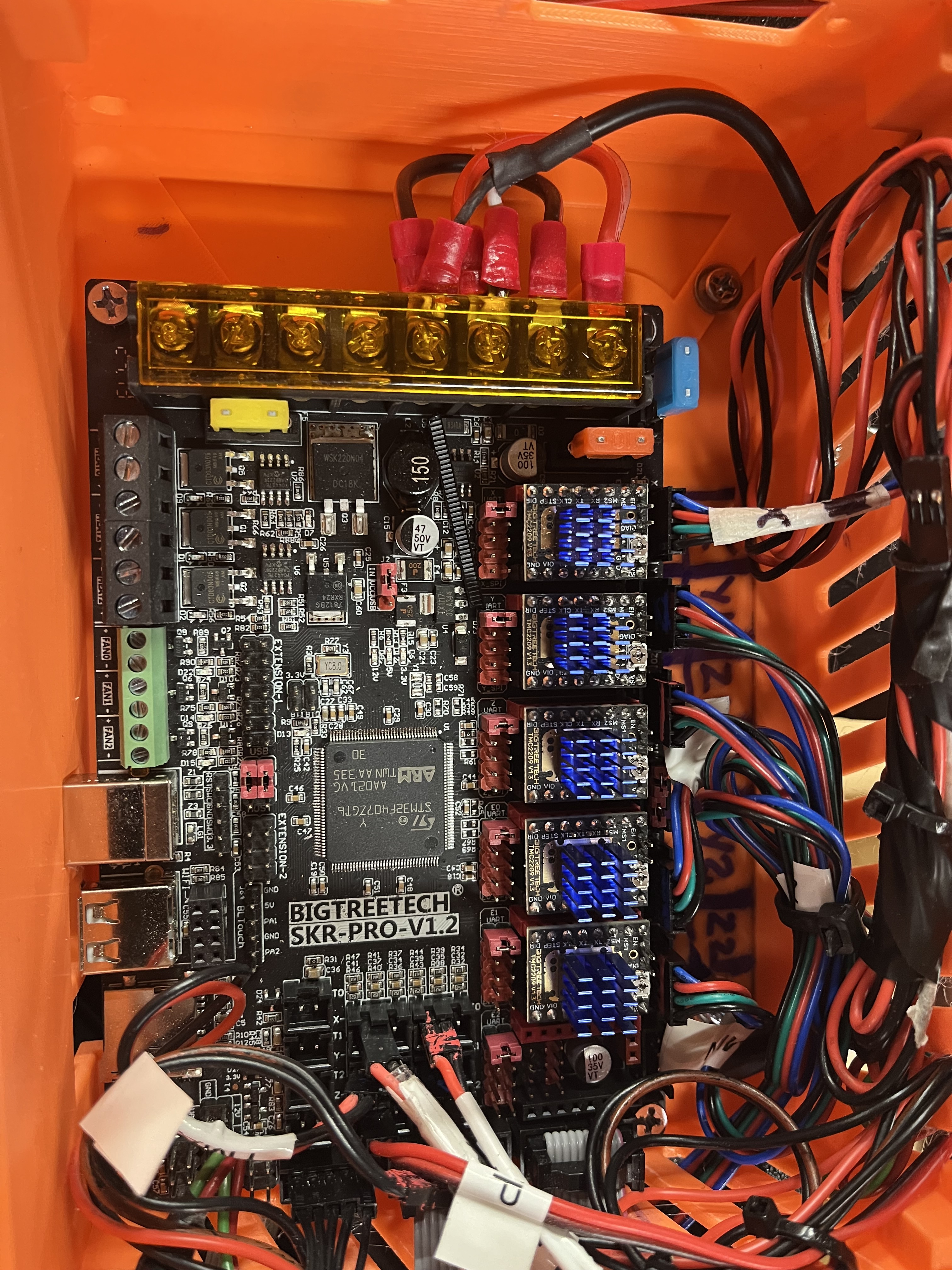

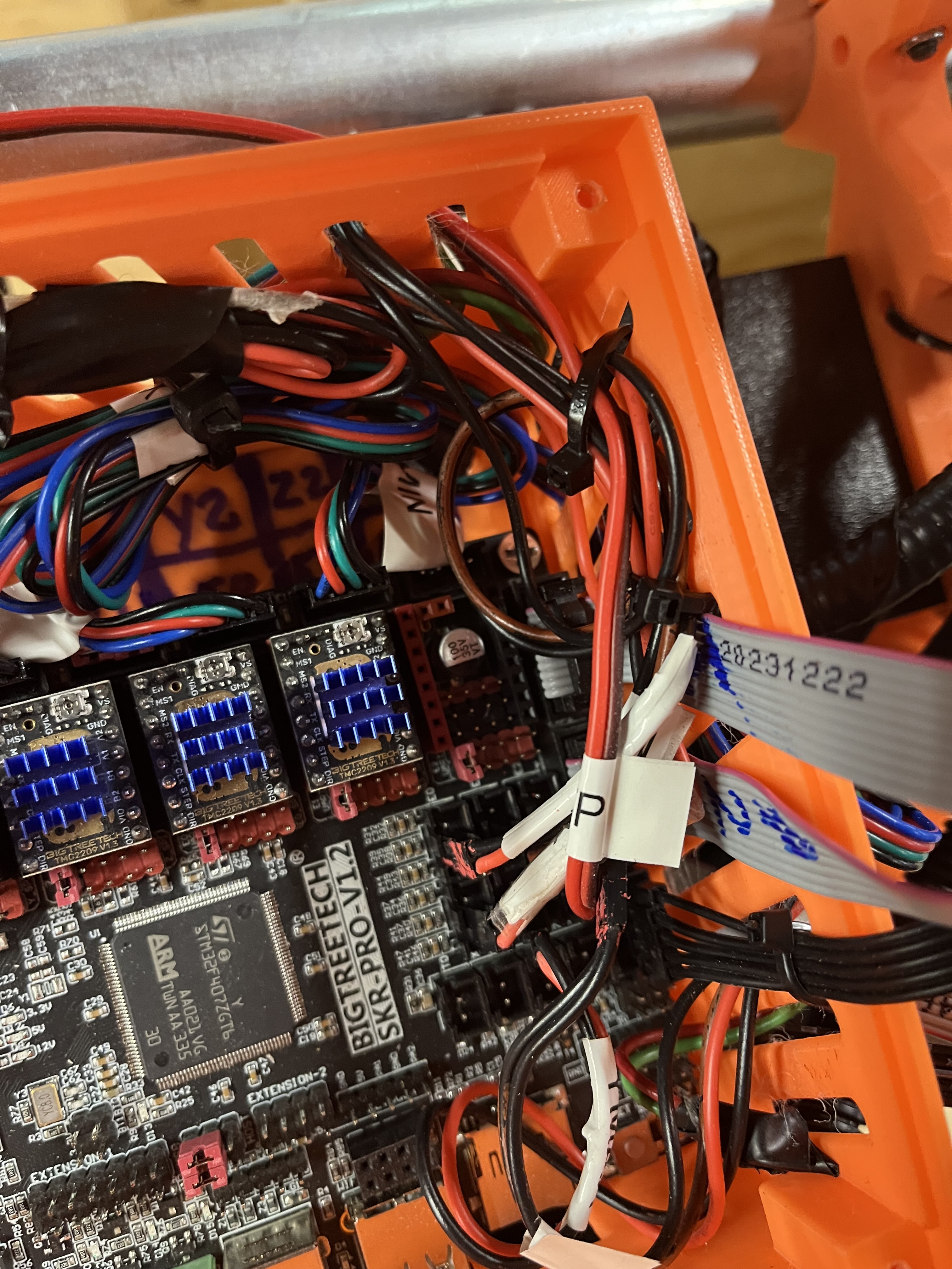

This brings up another question I need clarification on.On the motor and end stop terminals on the board it’s labeled y1 y2. I assume y1 is max y2 is min or am I wrong.
No Y1 is on the min (no rail) side and Y2 is on the max side, both front so zero on the Y axis.
Ok that could be one of my issues. I was assuming 1 was max 2 was min.
There are three cables connecting the display to the SKR Pro board. The smaller, usually black cable is used in touch mode. The two larger, usually gray cables are used for Marlin mode. Try unplugging and reseating both ends of the black cable. If the touch display has never worked, check the baud rate on the display settings. It shoudl be set to 250000.

As I understand it if I am looking at the front of the router or the side of the gantry the router is on then home would be where Y min and X min meet at the beginning of their lines. Other words Birds Eye view of the table it’s the lower left corner. And any movement from here X or Y would be positive numbers. Am I correct?
This response is very clear to me. You just put it exactly the way I needed to hear it. I just sent my previous reply before seeing your response. And I did read through your post on before making mine, it was helpful but I still had more questions.
Yes, this is correct.
Yes, this is how it was explained to me.
