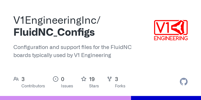

That reminds me that I was going to diff my config.yaml against the current ones since mine is based off an older revision. There’s been a few changes. I think in the current config, it homes X and Y at the same time too.
Git blame is a good way to see what changed when.
I had heard about “blame” and “blaming” but did not realize what it was!
It’s when someone tells you it’s your fault. :yum::sweat_smile:
Ha, well for my job, I usually use it to see what changed when but it does tell you who made the last change to each line of code. For me, it doesn’t really get used to blame someone. If a change broke something that made it through dev, review, and QA testing, we don’t normally mock the dev (sometimes in good fun or making fun of yourself).
