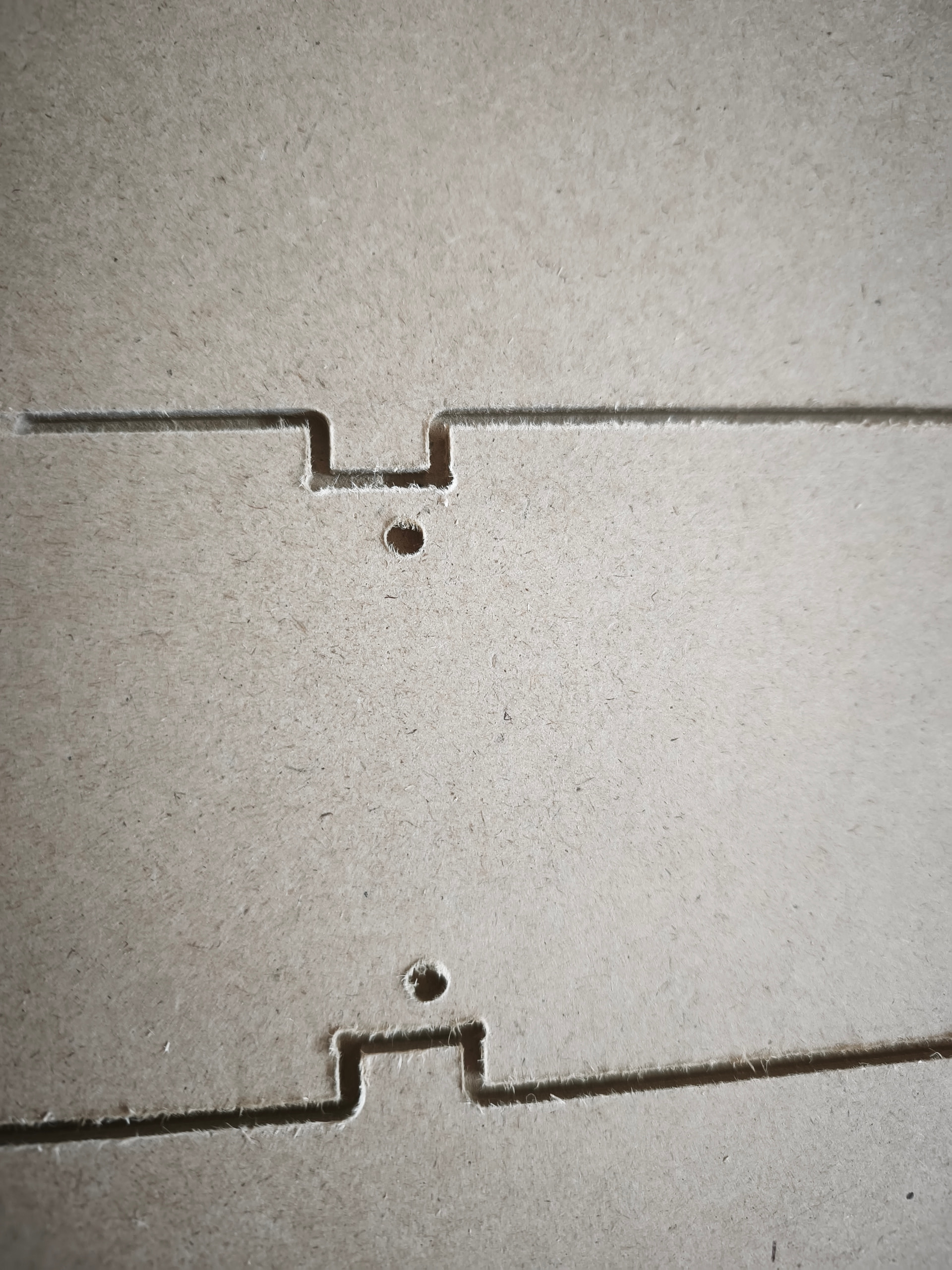

Hello everyone,
I am sure this has been discussed a thousand time, but I can’t happen to find this exact problem. While cutting the strut plates I realised the holes were way of (everything else seems fine).
What could be the problem?
Thanks in advance!
Marcel
Could be skipped steps between the hole cuts and the part cuts (assuming no tool change), or gantry moved during tool change and wasn’t re-homed before starting second set of cuts.
Are all the holes the same distance off or do they progressively get worse?
Are the holes correct in the CAD?
Thanks everybody! It was a simple mistake. I forgot to save macros…so my adjustments to the x and y axis weren’t saved…
