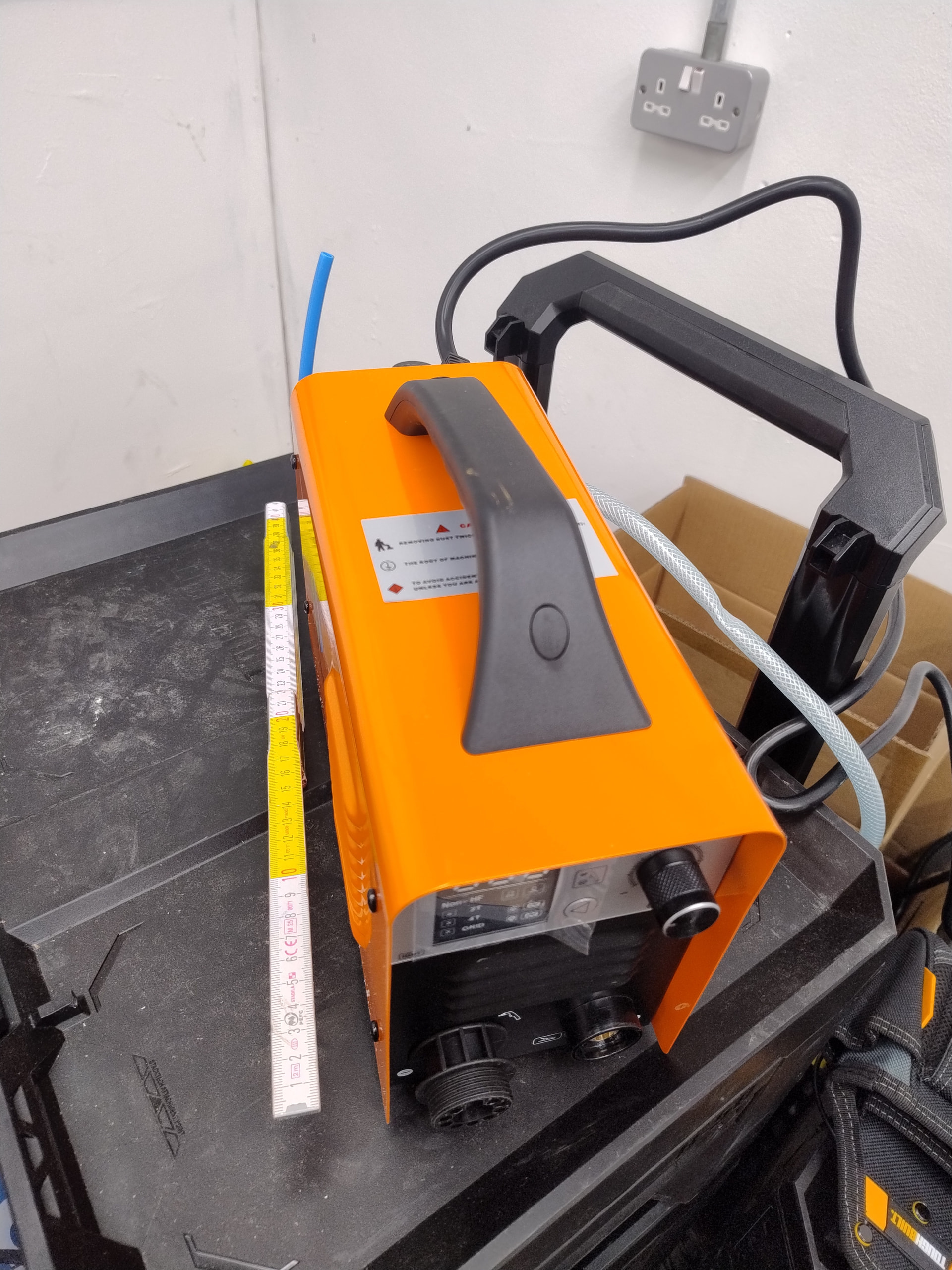

Had a very initial play with the Hitbox machines today. First impression… they’re hilariously tiny. Like, loaf of bread sized!! I didn’t have a banana for scale so an actual ruler will have to do, if you can read it with my crap photo.
Second impression … hmm, 2.5mmsq flex with a standard 13A plug (max is usually 1.5mmsq). Looks pretty good for a chinese british plug though, sleeving on the pins that should have sleeving, none on the one that shouldn’t, and a fuse carrier. Didn’t check if there’s a solid chunk of metal in place of a fuse however! I probably should.
But I’ll likely lop the plug off and replace it with a 16amp ceeform anyway, some british standard 13A plug & socket combinations have a habit of melting under sustained full load!
Both initially appeared dead - plugged in, switched on…faint click then … nothing. No life from the display or the torch. A bit of fiddling and one sprang to life, while the other is completely DOA as far as I can tell. Oh well, back to Ama-sin it goes!

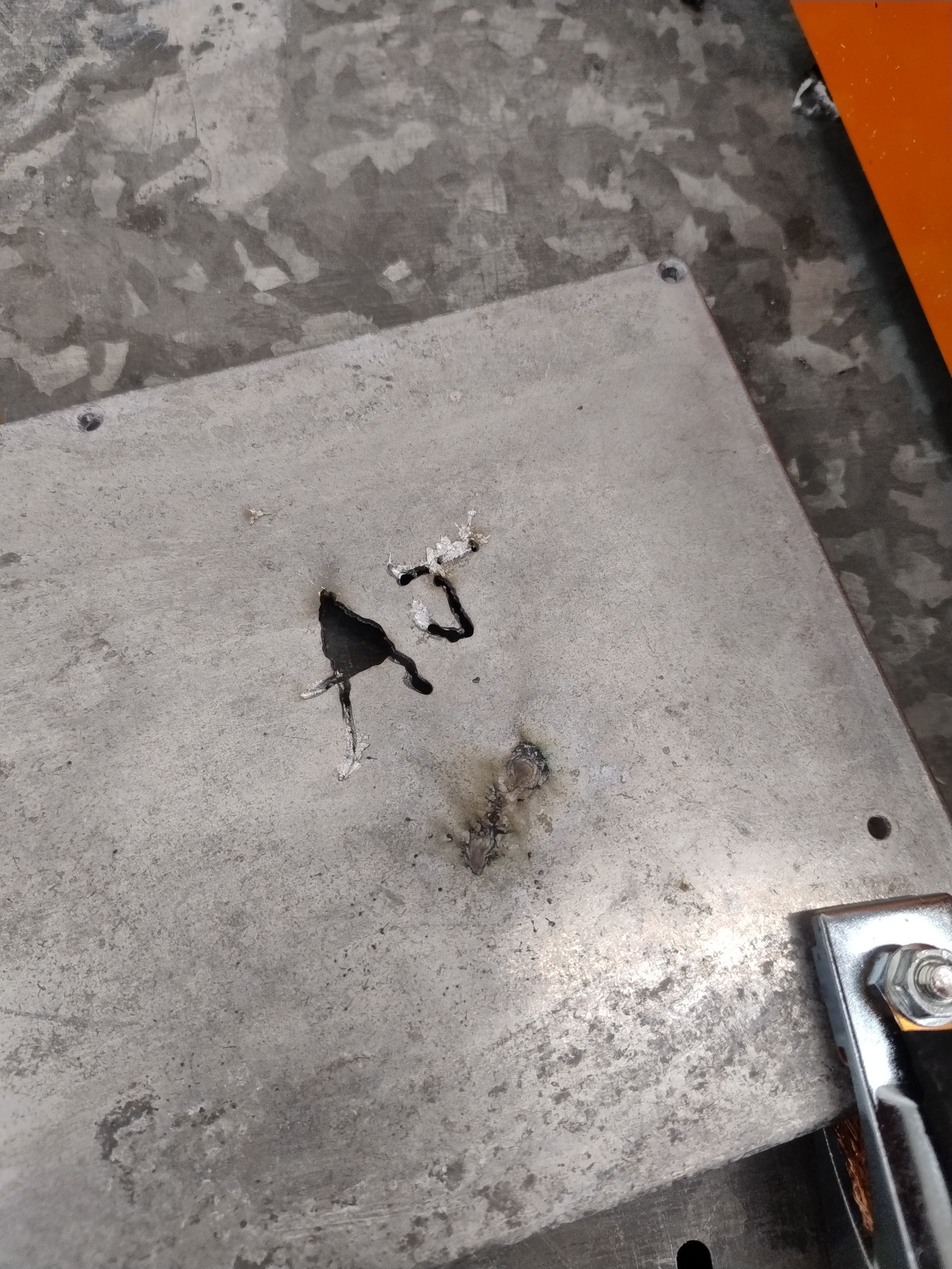

Test cuts on some scrap aluminium and steel suggest it does what it says on the tin. And you can really see why I need machines to do my dirty work given how wobbly my handwriting is (partly down to the shock of the thing working….)
No attempt made to dial cut settings in there, literally the first plasma cut I have ever made, I just wanted to see it cut something so I knew I didn’t have to return them both.
It claims to be able to cut up to 10mm steel. I didn’t have any on hand to test, but given the ease with which it blew through the thin stuff it might even be plausible
Duty cycle remains suspect, as does the ‘non HF’ claim. “Blowback” start normally has a sprung torch head, right? Nothing in the torch on this machine seems to be sprung. So vaguely suspecting that it might just be a regular HF start machine with a non-HF sticker on it…

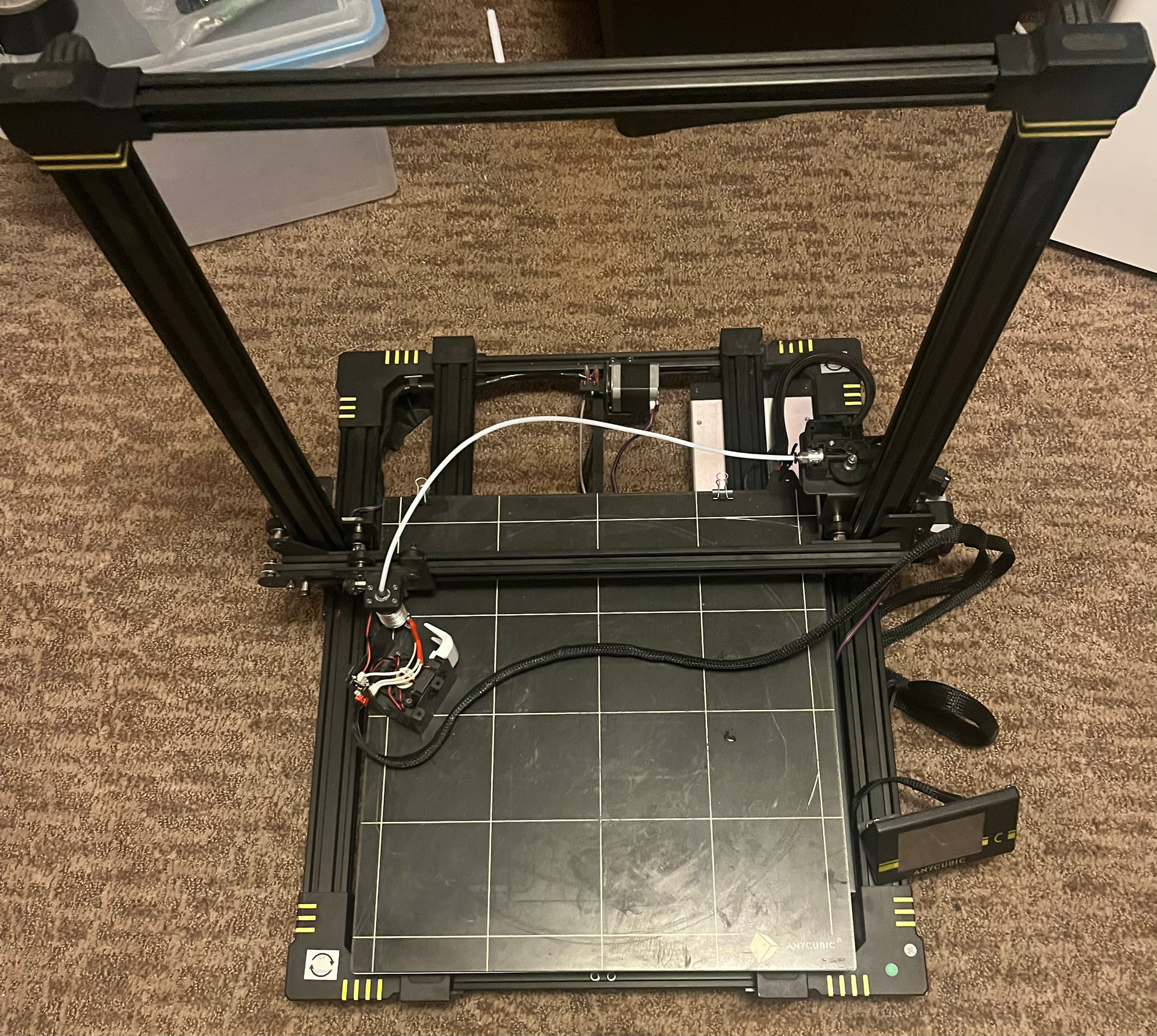

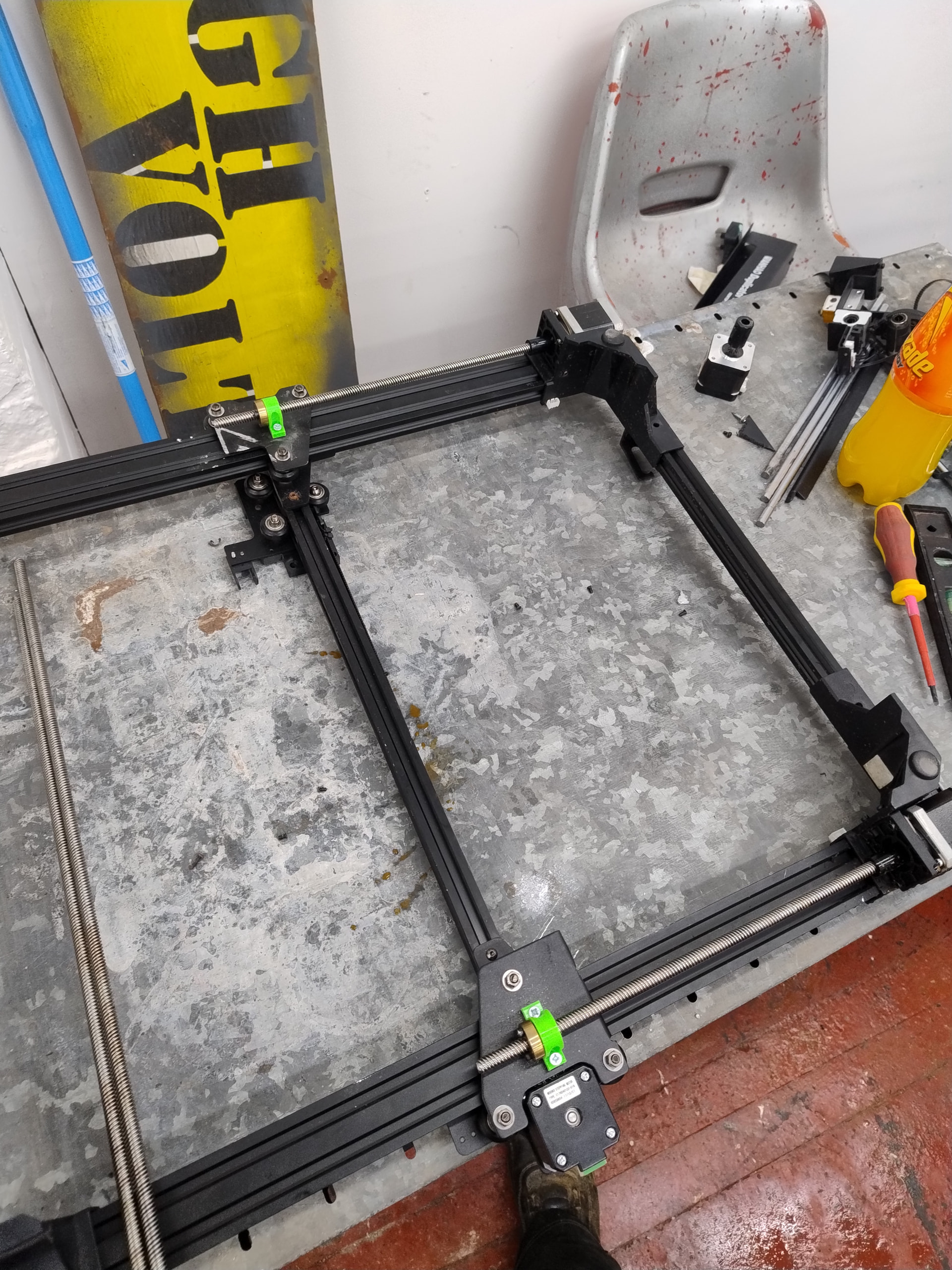

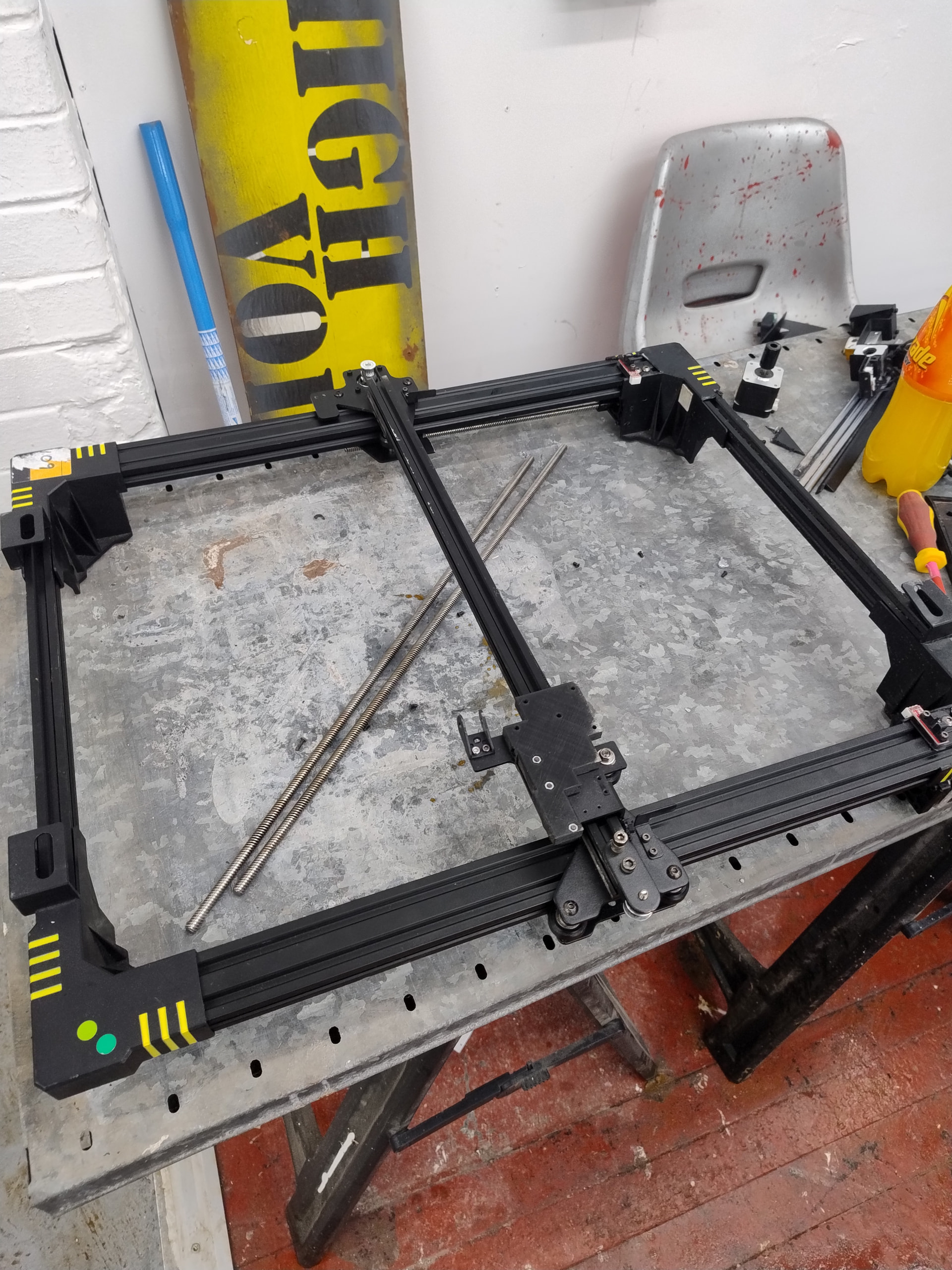

I’ve had an old Anycubic Chiron lying around for a long time with no extruder and a smashed heatbed (thanks UPS!), so I butchered that into a very basic 2 axis gantry.
I expect I may find that the leadscrew axis can’t move fast enough. But it was a very quick build out of stuff I had to hand, and will probably suffice for some test cuts.
