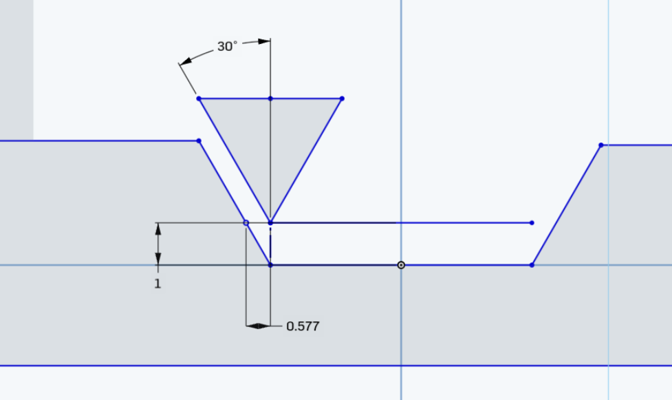

======================= Me again! ================================
That’s tons of detail that appears on a cursory glance to be quite reasonable… judging from what I’ve already gleaned from my own research. And all in mere seconds… just for the asking. I later gave the same v-carve inlay parameters to Gemini, asking how I would go about it in Estlcam… and again got a very informative response.
I’d never have been able to gather and collate that much information on my own… regardless of how long I researched it. Gemini seems pretty smart… and I won’t hesitate to ask it techical questions in the future. I’m old – and easily impressed by this new-fangled AI stuff… but it’s probably old hat to you younger guys. I’m beginning to wonder… could Gemini be my new BFF?
:wink: :flushed: :wink:
Seems good, but I am pretty sure prismatic overcut does not add a glue gap at the bottom, that’s why I went away from F-engrave. It just adds the gap at the top. I might be wrong though.
Herein lies the big difference.
Humans assess a confidence element by element of knowledge.
AI presently doesn’t have a way to state confidence, so instead it presents everything as correct even though it isn’t.
So, taking that wealth of output and overlaying which parts are correct and which parts are crap is the approach to getting good usable results from an AI.
It’s my understanding that the prismatic overcut in F-Engrave creates an offset that enlarges the inlay part so that it doesn’t bottom out in the pocket part … leaving the glue gap; i.e. 1 mm.
Gemini suggests setting this “prismatic overcut” is a “strategic setting” that can be used to leave both glue and surface gaps. I don’t quite understand what the “prismatic overcut” actually is but, using the screenshot above, I get the idea of a needed offset (why not 0.577mm?) of the bit for cutting the inlay part and see where some of the numbers come from…
  • A common strategy is to set Prismatic Overcut to a value that provides the desired fit. For a 1mm glue gap and 1mm surface gap, you’ll need the male plug to be 6mm - 1mm (glue) = 5mm deep where it meets the female walls, plus a bit more to ensure protrusion for sanding.
  • A good starting point for Prismatic Overcut (to achieve a glue gap) is often calculated as (Glue Gap) / tan(V-bit Angle / 2).
  • For a 60-degree V-bit: 1mm / tan(30 degrees) = 1mm / 0.577 = 1.73mm (approximately). So, set Prismatic Overcut to around 1.73mm.
  • For a 90-degree V-bit: 1mm / tan(45 degrees) = 1mm / 1 = 1mm. So, set Prismatic Overcut to around 1mm.
  • This Prismatic Overcut also contributes to how much the male plug protrudes (your surface gap). You want it to protrude by at least your 1mm surface gap. If your Cut Depth Limit for both male and female is 6mm, and your Prismatic Overcut creates a 1mm glue gap, the male part will inherently extend beyond the original surface of the female, allowing for sanding.
I haven’t actually cut an inlay yet using this… but I’m gonna try it with my next attempt.
:man_shrugging:
Yes, and it does produce the surface gap, but not the glue gap as far as I know.
