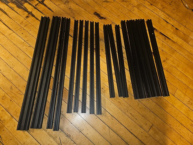

So, left to right:
  • 4 frame uprights, 550mm long for a 300mm usable Z. 2 × 2020 and 2×2040
  • 5 X axis cross pieces at 475mm for 300mm usable Z. After playing with the CAD, I did not like what changing usable X and Y did to the bed mounts, so I guess I can give a bit of that up. 300mm out to be enough…
  • 3 × Z rail mount uprights at 390mm, for 350mm Z linear rails.
  • 6 × Y rails at 428mm. Again should be for 300mm usable.
  • I did not yet cut the pieces for the bed mount. That may require some additional thinking.
I slipped with the uprights, and one of the 2020 pieces is about .5mm short, so I will need to hide that or else it will make me crazy (crazier? :rofl:)
So last time I cut extrusion, I used a push fence on the table saw, and didn’t like it. So I went and bought a miter box and a handsaw, figured “good enough.” Then I brought jt home, and put it (I thought) away in the shop. Think I could find it when the extrusion order came in? :rofl: NOPE!
So today, I figured “screw it.” I can find the receipt, so I figured I’d buy another one, and when the first one turns up, use the extended return window to return the missing one.
Then, in the store, there’s a 7.25" sliding compound miter saw sitting there less than 1/2 price. I don’t normally buy the brand, but this is not likely to be a heavily used tool, so I guess it doesn’t have to be Makita. So… now I have a compound miter saw.
Anyway, given the tool, I was able to make quite accurate cuts for the extrusion, so there’s not much gap for adjustment in there, but there is some, like .5mm or so, lol.
I will need to saw off 25mm from the one MGN12H rail, I guess. I have 5 × 350mm rails and 1 × 400mm rails, which ought to give me a 300mm cube build volume.
I went 25mm wider with my frame to give me a little room on each side of the bed. This also made it to where I didn’t have to cut the X rail either. Gave me room for a nozzle brush on the side of a 300x300 bed.
And I did 25mm more in X, 50mm more in Y
Yeah, I’d planned to do +25X and +50Y, but it makes the machine a really tight fit in its intended home, too. NBD if it was going to take the v3 spot over, but that space will be something else.
So I’ll return the 2 400mm Y rails I bought… after I cut down the X rail, lol.
