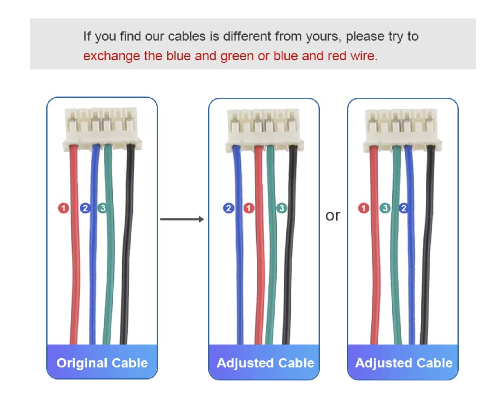

I’m working on my first CNC build (LR4) and have loved every minute of it so far! I’ve now assembled everything and started testing today.
The problem I’m having is that all the steppers lock up when connected to the Jackpot 3 board. I’m assuming the issue is the same across all axes, so I’m concentrating on troubleshooting the X-axis first, hopefully applying the same fix to the others.
I can get the X-axis to jog, but the movement isn’t smooth.

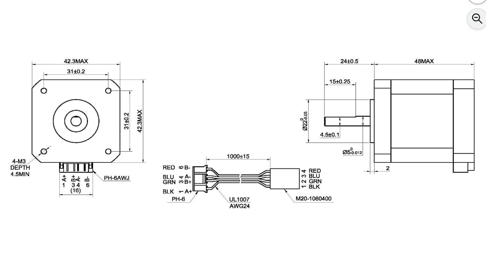

These are the stepper motors I’m using: Amazon.co.uk .
I’ve noticed that they’re rated at 2A, while my .yaml file is currently set to 0.8000. Could this be the cause of the problem, or should I be looking elsewhere?
Any advice would be greatly appreciated!

One is that the steppers you are using have 1.3 Ohm coils, where the recommended one is 1.8.
Your config looks like it has the default drive current, which should be OK even with the lower coil resistances.
First off, can you run the $SS command in your terminal window, and copy/paste the results here in the forum? Use the preformatted text option on the forum editor toolbar to format the text. That icon looks like this: </>
Next, turn off your machine and very slowly move your X axis by hand. You don’t want to move it rapidly because the motors become generators when off and the EMF from them can damage your board. Does your X axis move freely (again SLOWLY by hand) from one side of the beam to the other?
Have you tried rearranging the wires like it says on the description? Be sure and power off the Jackpot before unplugging and plugging back in the steppers.
I did! The last option matches the Jackpot 3 pins. This is stepper config.

Problem solved! It was my mistake, I made a crossover connection and failed to them in the correct order. The x axis glides along now. Thanks for all the speedy replies.
