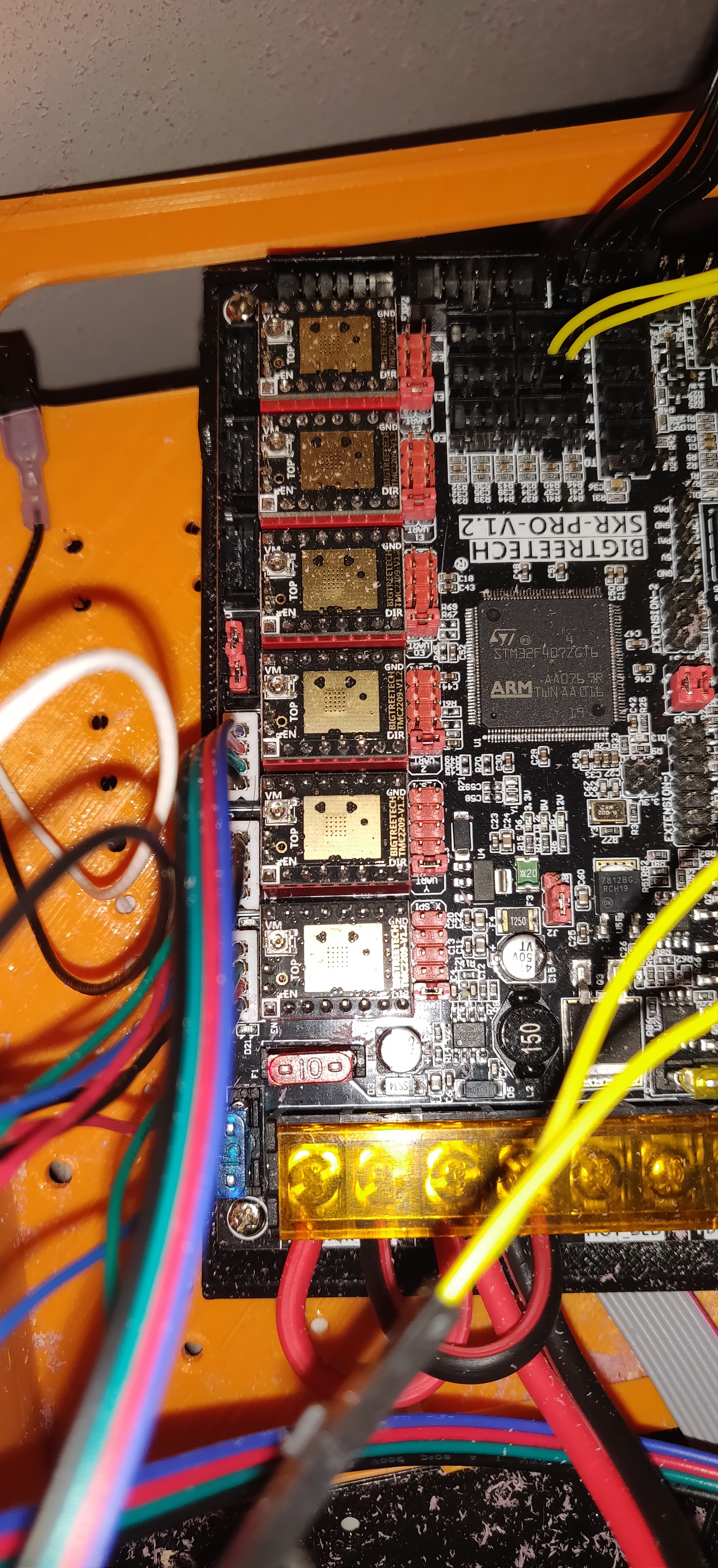

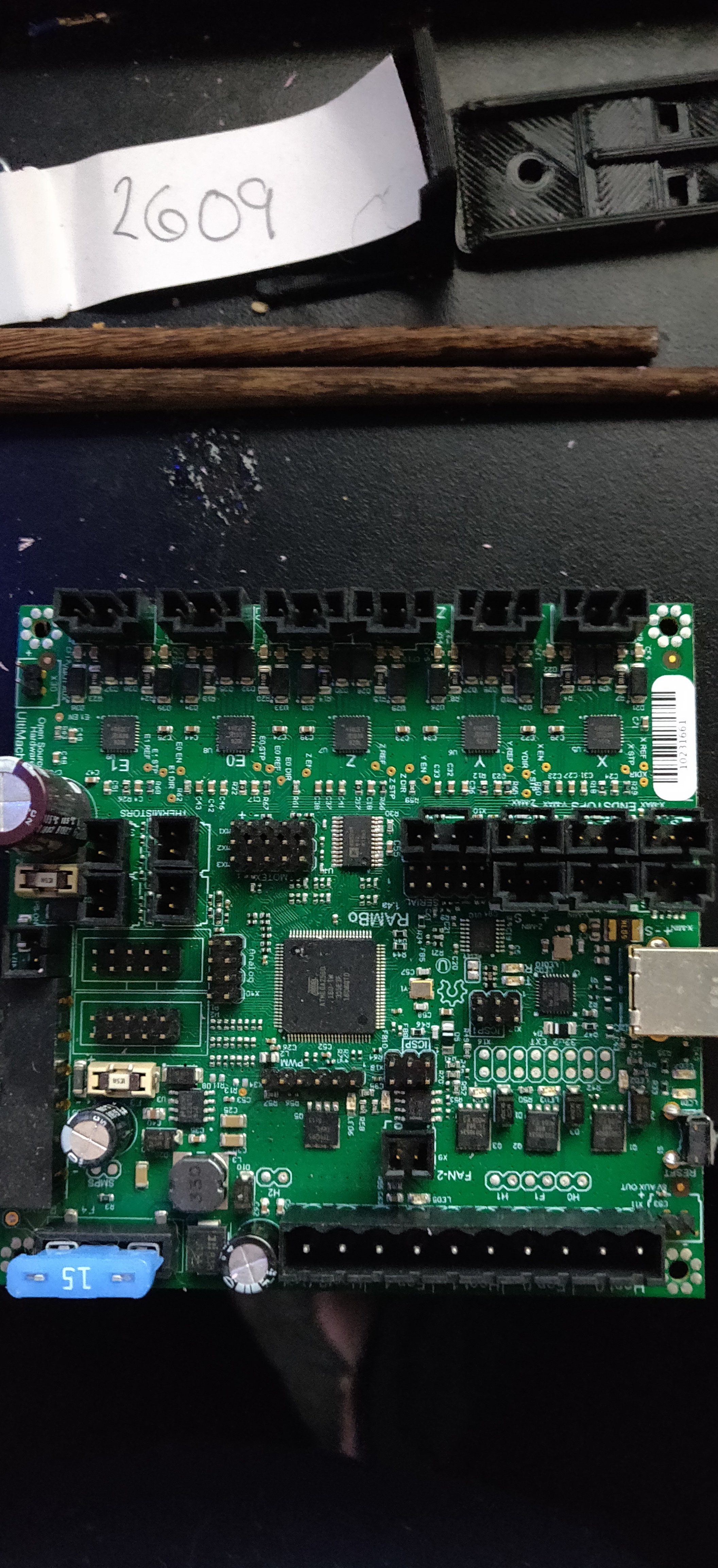

the drivers arent really external per say. they plug into the board. if one goes bad you can easily replace it. with the rambo they are built into the board. if 1 goes bad its harder to replace for the common person.
Wiring wise it is the same between the rambo and the skr
small squares near the top are rambo drivers
shiny parts down the side are skr drivers
That is really helpful. Is tehre a way to see complete diagram of the wiring for each board? Right from powersupply to the board then to the motors?
red and black wires at the bottom are straight from the power supply. the three white plugs on the side go to the steppers. they are fairly easy to set up. most problems come when setting up duel endstops(which are not need at all)

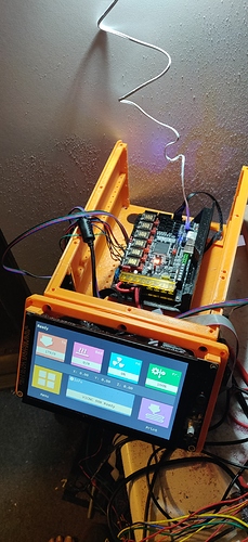

There is also now the GTR board that claims to be an upgrade from the skr pro… looks beastly… I was thinking of picking one up for my next 3dp. 6 on board drivers and an expansion board for 5 more… thats a lot of filament choices right there.
Would you have a link to that please? Since I haven’t made a purchase yet, it’ll be nice to pickup something that i won’t have to upgrade in near future. Thank you in advance.
Also, would i need external drivers with this controller? Would you know?
Its like the skr pro, it takes “extrrnal” plug-in drivers
Here is a link that includes the gtr, touch screen, 6 drivers, and expander board… though I can’t think of why you would need the expander on a cnc.
Dual endstops so that would be X, X2, Y, Y2 now say you want a 2nd spindle or a laser that is Z and W… then throw on a Rotary or two and now you are up to 8. Even more if you do a 4th/5th type rotary. Or you could have say 4 heads on a machine and each be independently driven with different tools :slight_smile:
