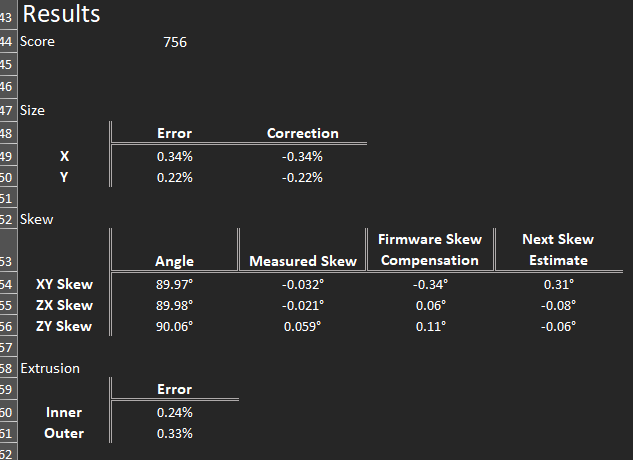

Printed a 3rd lantern last night, just measured it with a more accurate caliper:
That’s a lot better there! At least its doing something now. I would make those corrections it calls for and run one more. But really what you have there is plenty acceptable
