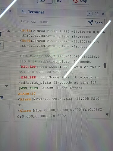

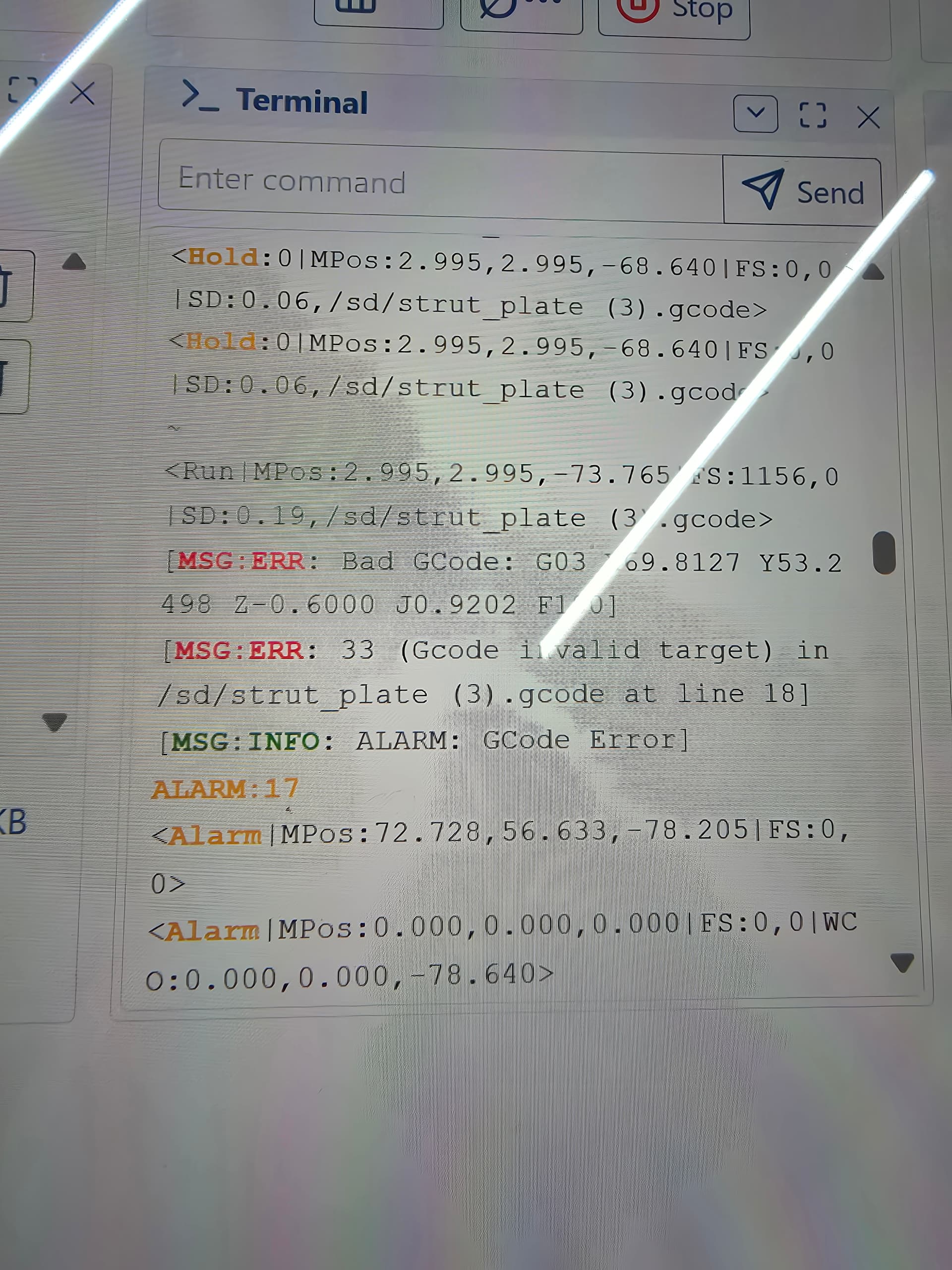

I just went through all the estlcam basics and everything seems fine. I load it to the sd card and run the gcode. It goes through the probing gcode and then when it goes to cut the first hole it alarms.
Says bad gcode G03 X69.8127 y53.2498 Z-0.6000 J0.9202 F180
MSG:ERR: 33 (Gcode invalid target) in /sd/strut_plate (3).gcode at line 18
Here is the gcode

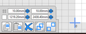

With that said, it ran the crown code just fine but it wont run my code. I have verified all my settings in estlcam.
I cannot get the strut plate gcode to run

What size hole are you drilling?
Per the FluidNC WIKI, (assuming you are using FluidNC). Supported Gcodes | Wiki.js
When using a G03 command, If impossible to fit an arc to the points provided, you will get an error:33 [MSG:ERR: Gcode invalid target]
If your mill is larger than the hole that would be a problem.

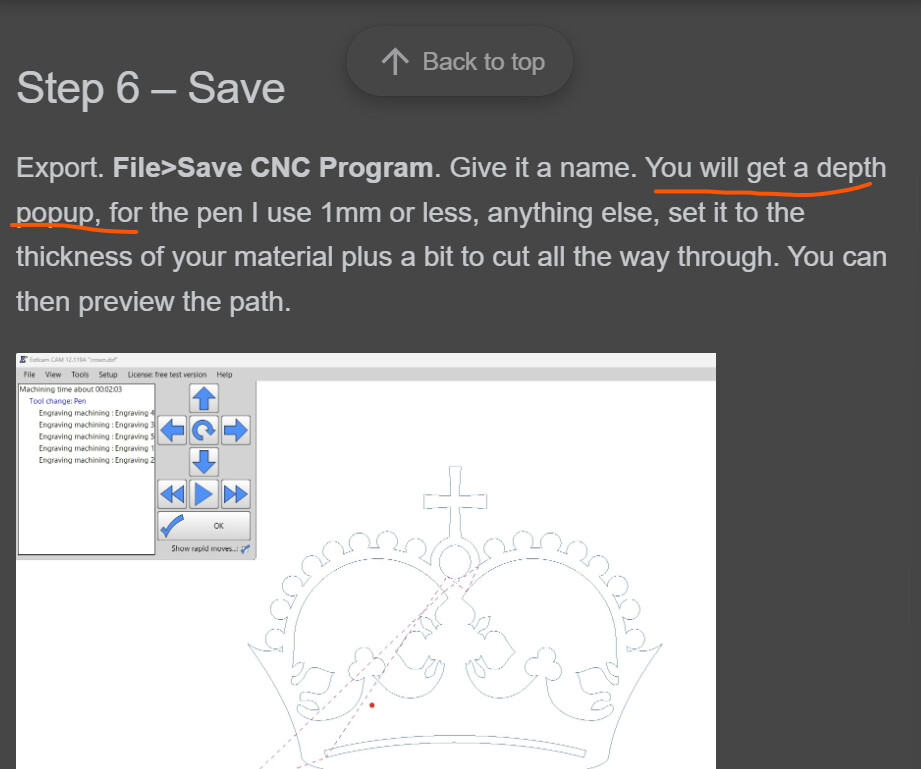

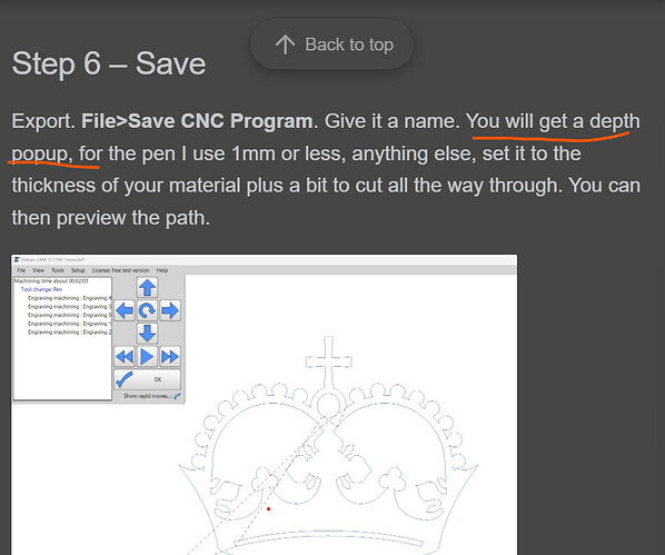

On the website EstlCAM Setup page, Step 6 it says when you “Save CNC Program” you should get a depth popup? I dont get this. Should I be getting this popup?

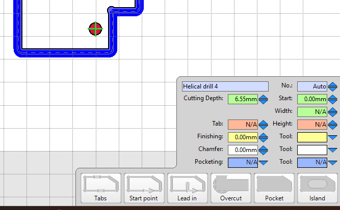

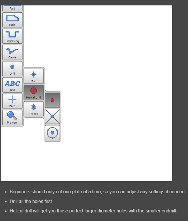

On the LowRider CNC V4 build page towards the bottom it goes through how to setup the cam software to cut the strut plates, it says to use Helical Drill. My end mill is only 3.17mm (1/8).

15
You will only get that if you didnt specify a cut depth when you set up the CAM. You have that set already at 6.55mm so you wont get the pop up

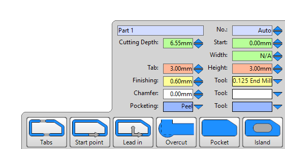

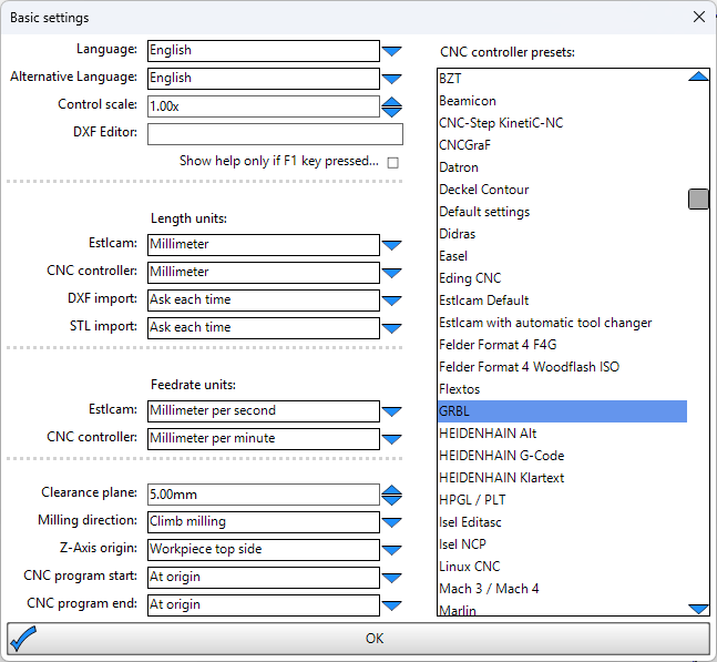

Maybe its something to do with this?
Tokoloshe
(Philipp)
January 18, 2026, 11:45pm
17
I can’t see anything that sticks out to me, but I am using a different processor… Need to wait for one of them FluidNC boys…

18
I cut struts all the time using helical drilling with zero issues. I have no idea why he is getting this error

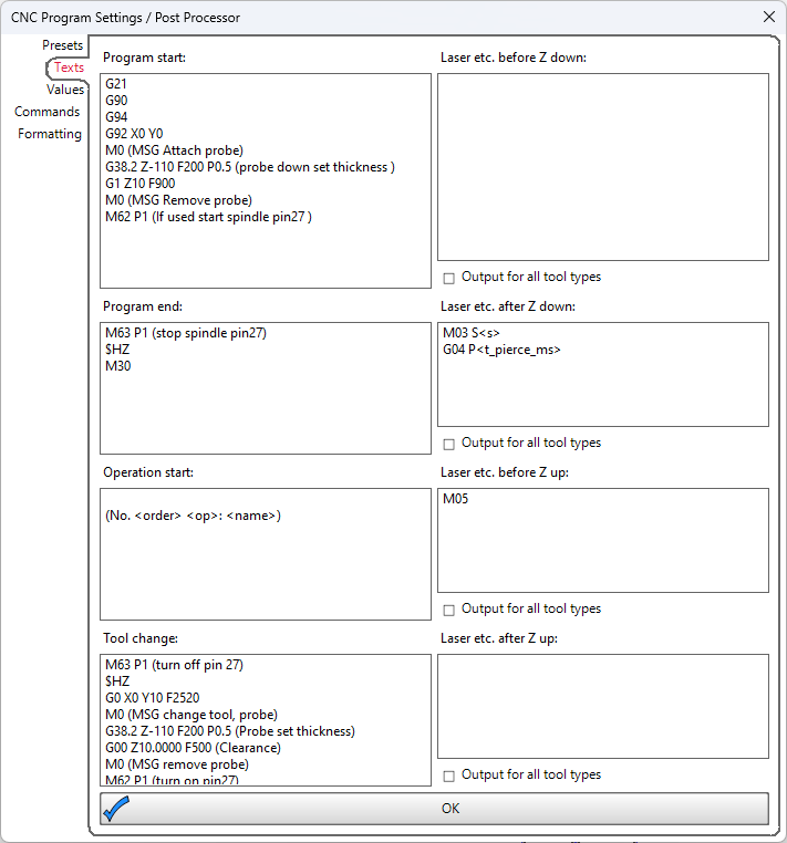

I added the material dimensions and tried to cut again with the same errors

20
Did you change the yaml or add soft limits ?
