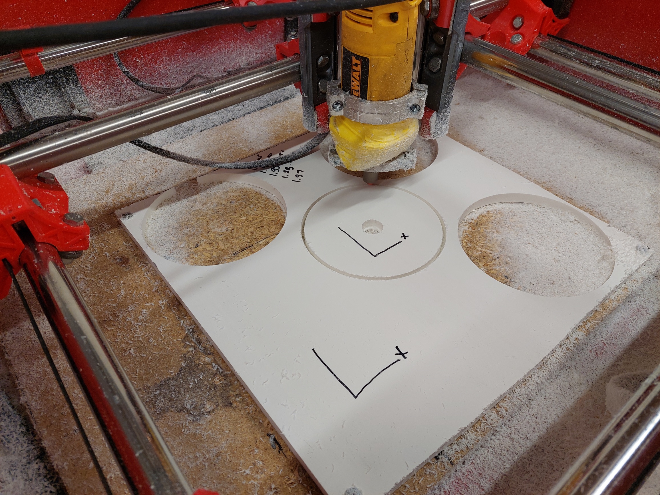

I did that last night. Here are some photos. I can read down to 0.2mm with my “glasses”, Seems to work very well and I ordered some additional 24" scales on Amazon to see marks better. BUT after squaring it all up I cut another circle and it was all funky. I am still investigating and will post results soon.
I discovered at least one of my problems after 4 hours of trying to square it down to 0.2mm. I could get within 1mm on the diagonals then I would make 1 more minor change and get a random answer on the diagonals either better or worse. Adding more confusion it would usually repeat. A couple times I got it down to 0.5mm. Then I cut another circle with it 1.5mm out of round. After pulling my hair out for hours I believe my limit switches are not repeating. It is the only thing it could be after I finally observed it change a couple of times on the repeat.

Ok a lot to unpack today. Spent many hours playing with squaring up. The good news is I swapped out my limit switches and the measurements started looking like I expected. I used my new 24" scales ordered of Amazon and quickly squared it up to maybe 0.75mm or so. Each M665 movement gave me what I was expecting for a change. Then I swapped to cutting circles again. The first looked ok but was flat on the bottom and about 1mm out of round. So I started thinking about what could cause that. My trucks are rather tight and my first thought was with the twist imposed by the squaring, they are even more bound…my machine is quite a bit of unsquare in idle position. So I started loosening up the trucks and core bearings until they were just barely touching the rails. And I reset all the bearing tension with motors engaged and M666 offset in. Every change I made gave a better result. So then I began adjusting offset again based on my cut circle results. I started with .020" out of round and ended AT 0.005" OUT OF ROUND!. With a 1.35mm offset in Y axis. So what next? I kept adjusting the offset just to see how low I could go. And things started getting worse. Sometimes the flat spot would come back sort of randomly. So I kept playing with bearing tension but still kept getting the random flat spot, usually near the bottom. So I gave up and went back to my 1.35mm offset but could not duplicate the 0.005" out of round. I ended up at 0.008" out of round, which I know is not bad, but I fear it will not always repeat and may jump back to 1/2 mm.
Anyway here are some pics. First is my dual scale setup.
Then my new limit switch clamps with covers to keep out debris.
A shot of the circle cuts.
And my 0.005 circle next to my 0.008 circle.
And an example of how things can jump out drastically with.a flat spot. You can see the out of roundness I you look closely. All the numbers are thousands of inch.
