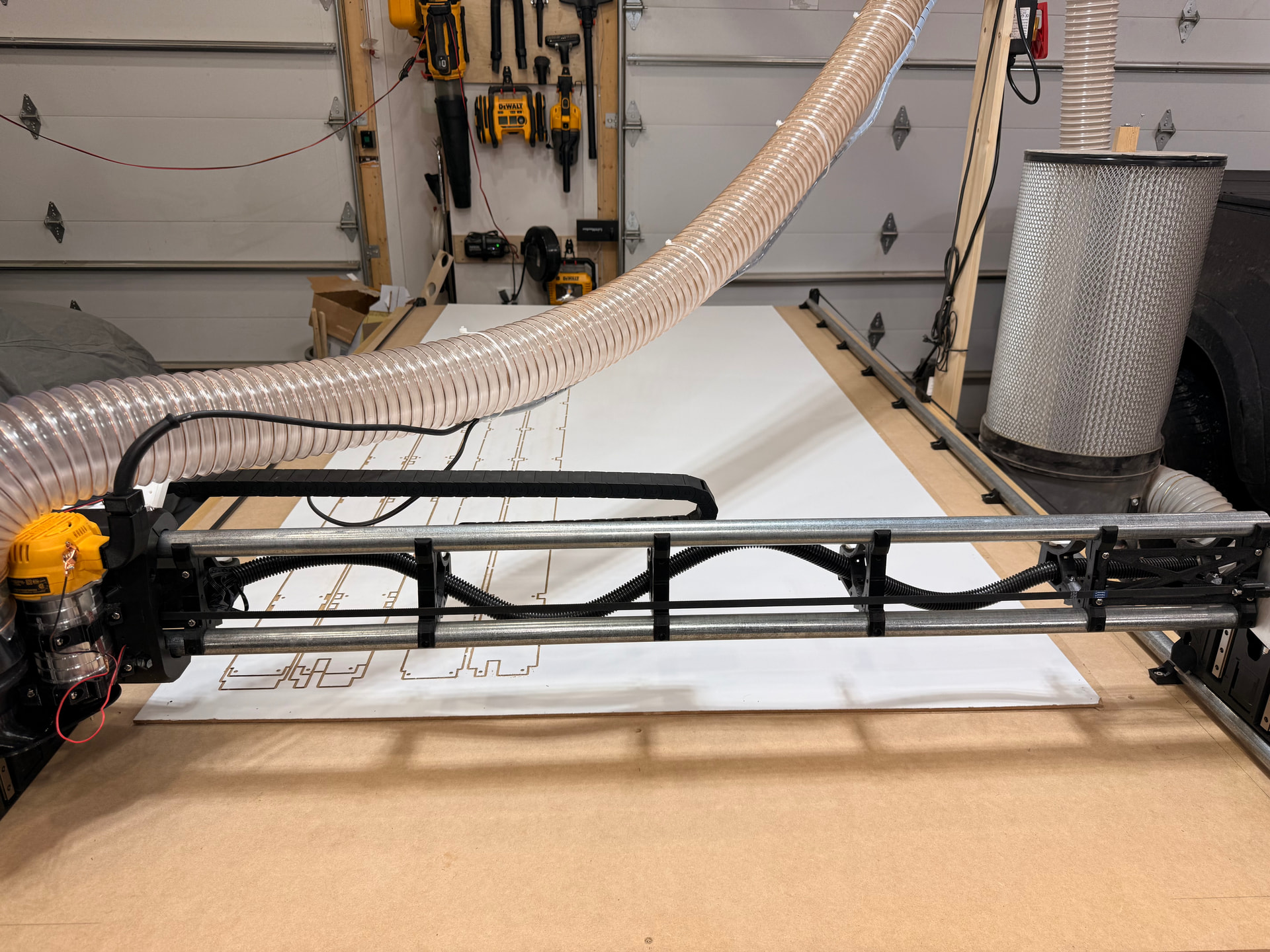

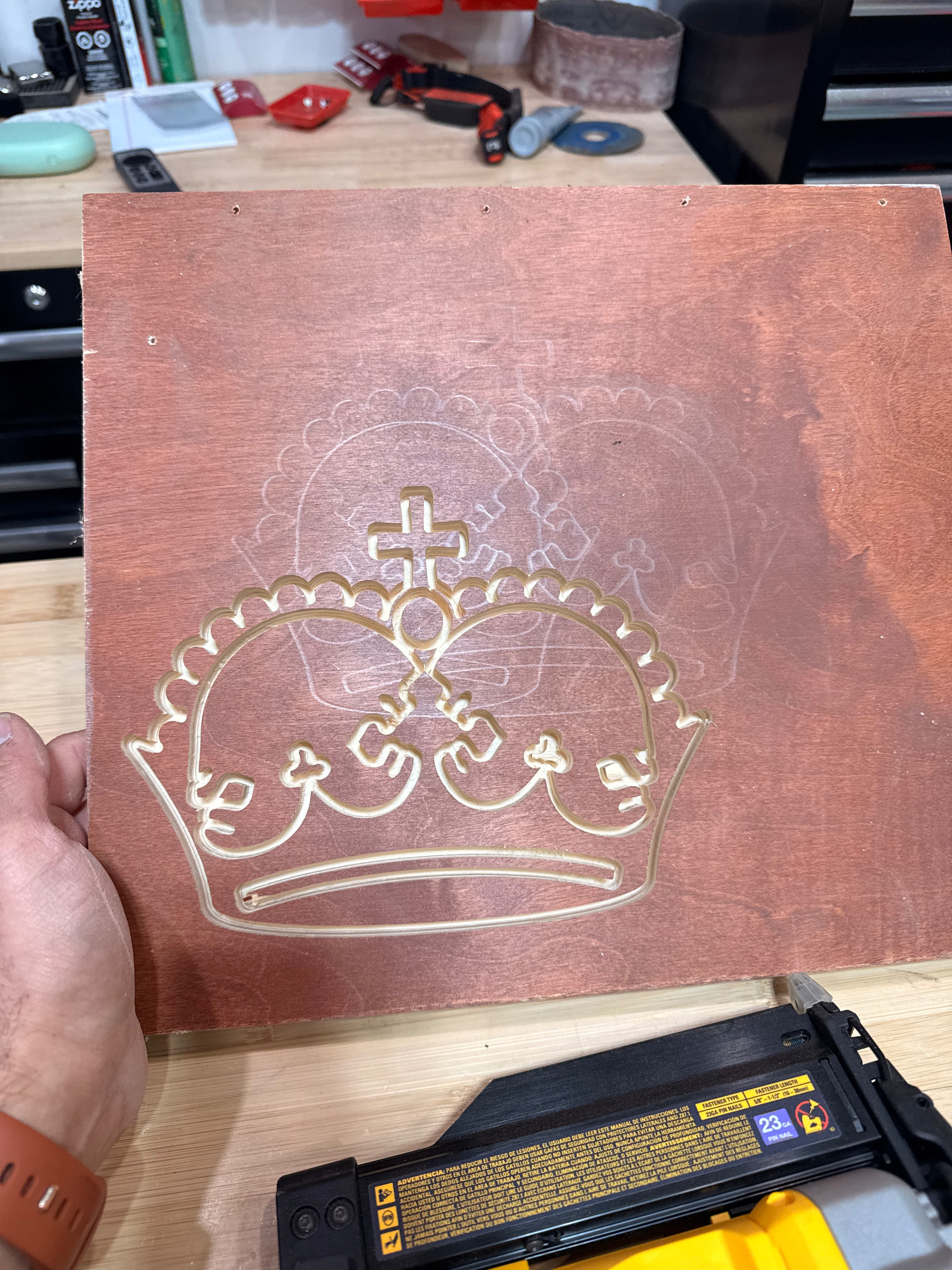

I finally built the machine and ran the crown test file (although I didn’t pay close attention to the cutting depth since I was excited to just see the machine do something, lol).
I’m now having difficulty cutting all the way through my hardboard I want to use for the strut plates, as you can see in the photos, I’ve tried three times using guidance I have found in the forum but still have no luck cutting through the piece. The hardboard is 3/16” or 4.76mm thick.

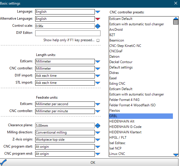

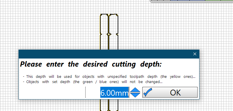

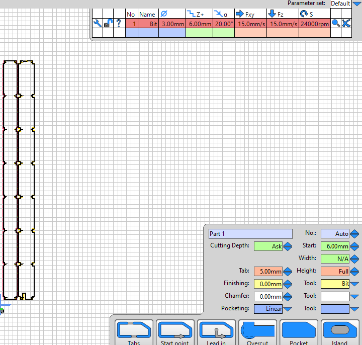

My first two attempts used the “machine bed” for the z-axis origin, then I found guidance on setting the z-axis origin to “workpiece top side”. So, I set the bit depth to 6mm, the start at 6mm, and the desired cutting depth to 6mm, hoping to cut a bit into my spoil board, but it’s still not going through. I’m frustrated with myself since I don’t remember if I placed the touch plate on the workpiece or the spoil board on the third attempt. The first two attempts I definitely put the touch plate on the workpiece.
Please refer to the screenshots attached of my settings. I have a feeling this is a simple fix as I have some wrong parameters, but I thought I’d check with the community before I waste a whole sheet of hardboard.

First of all: you don’t set the “Start”. It starts 6mm below 0 then normally.
Second: Are you sure you set 0 correctly with the touchplate? It rather seems that it does not set 0 correctly.

  1. Are you referring to the “Start” field in the part window where I set it to 6mm?
  2. I’m thinking not. What I did was:
    • place the touchplate under the bit,
    • then pressed start in FluidNC
    • then the bit lowered, touched the plate, and raised
    • then I pressed start again and the machine ran the gcode
What am I missing in terms of setting the touch plate?

  1. Use shallow DOC of 1mm (or 2mm if you’re feeling brave…) until your Ply/MDF/hardboard Struts are cut and installed. Only use deeper DOC (Depth of Cut per pass) like 6mm after installing permanent Struts.
  2. Yep.
  • Set “Desired Cut Depth” to the ACTUAL caliper measured thickness of your workpiece stock material plus extra 1mm to help account for uneven table and/or gantry leveling.

Thank you all for your assistance and input here. I finally figured out the issue and feel like such a noob… the problem was the router wasn’t fully seated in the holder! I’m running the strut plates now!
What a relief!
