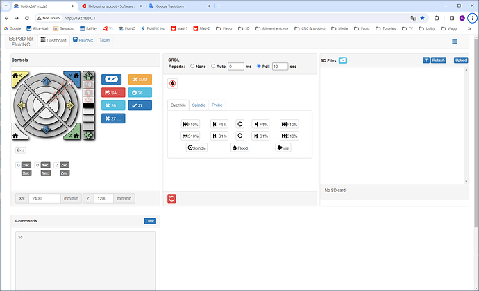

I recently received the Jackpot card (Europe purchase group 2)
I tried to follow the instructions in the documentation and various posts. I came to this visualization:
I can’t figure out how to get buttons for single movements (X, Y and Z) and other useful ones like “probe” “home” etc

The wheel on the left side is for jogging individual axis. The center is the smallest movements and the outside is larger movements. Z is on the vertical bar of buttons. The buttons with the houses home the machine on individual axis or all of them.
If those aren’t moving the machine, then look in the Commands window for a log message to tell you why.
Macros can be set for unique things. I haven’t set them up myself. I think they should be set if you use Ryan’s config.
Thanks for the help, now that you told me I see it’s intuitive, but for a seventy-six year old it needed a push.
