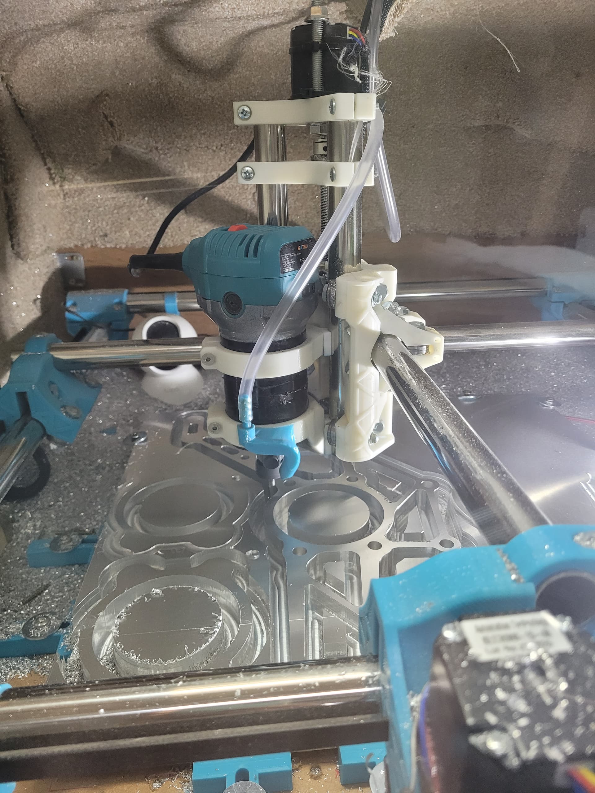

Hi, I built an MPCNC a few years ago and have been using it for mostly cutting aluminium parts (pics below). Last week I had an operator/programmer disaster and the tool crashed into something hard it wasn’t supposed to, I quickly hit the power button at the wall to turn it off, but when trying to turn back on i get nothing. Tried replacing powersupply and all fuses on the control board, nothing. I assume i need a new board :frowning:
The current board is an ultimachine 1.4 with LCD. I bought it with the full V1E mpcnc kit. I live in the UK and it doesn’t seem very easy or cost effective to try and get an exact replacement shipped over, and it seems like things have moved on a bit since i built my machine.
Any ideas guys ? i’m not an expert in cnc control board options, looking for advice on whatever is going to be easiest plug and play option here to swap out the old one for a new one.
Image of the machine hard at work before it died for your interest;

Milling aluminum with your MPCNC! Those parts look great. I haven’t tried aluminum with my MPCNC.

I just wanted to say holy crap nice cuts in the aluminum wow !!!
I really wanted to eventually be able to do bellhousing adapters for engine swaps with mines.
All things aside I like my skrpro but it does seem like ppl have started to use the new jackpot stuff.
Noone can ever say that you can’t mill aluminium with an MPCNC and a Katsu router now. Wow.

Great looking machine and parts.
