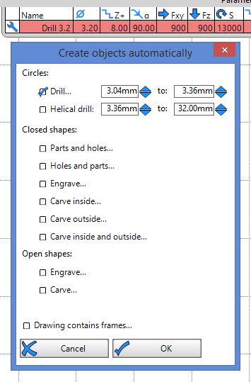

I’ve only been using esltcam for a few days, so I’m not very proficient. i have a file for cnc cutting, it has about 400+ holes lol; so I can’t select every hole. can anyone help me how to select multiple holes at once? Thank you so much and have a nice day!

If you select Automatic Functions then create objects automatically, I choose drill, that will create a tool path for each hole, then click and drag around your holes to select them to view the properties, choose pocket like @mordiev said if you want to set the pocked depth rather than cut through.
Thanks everyone, I got it done, it’s in automatic functions. That’s great, thanks so much!

There is a drop-down at the top that says something like “create toolpaths automatically”.
I guess it might not be able to automate multiple drill holes. I can get the automatic function to make the holes by milling. But not just plunge a drill, it always plunge, and then circumference milling action….

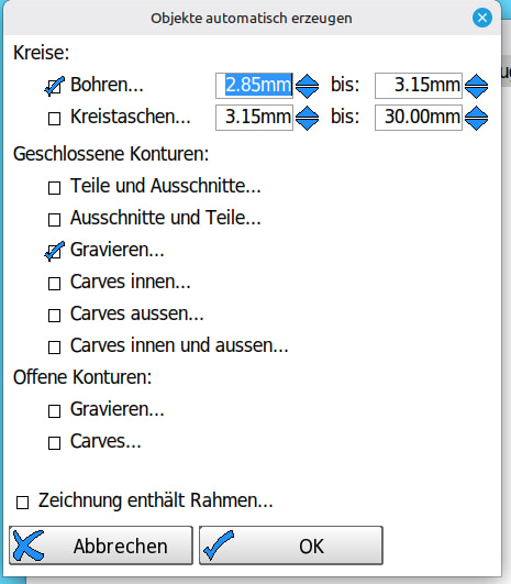

You can define the sizes that are going to be drilled and that are going to be cleared helically, first two options.
To drill holes only select the Drill option (which will never do any circumference/helical milling). I only use it to drill holes with PCB drill bits, using it with regular drill (much less milling) bits produces crap holes.
All drawing holes within the default/set range (e.g. 3.04-3.36) will get a drill path. While v12.155 remembering which options are checked is a good thing, the range of the first selected drill bit is also remembered/not updated when another drill bit is selected (a bug). The workaround is to manually set an appropriate range.
