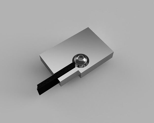

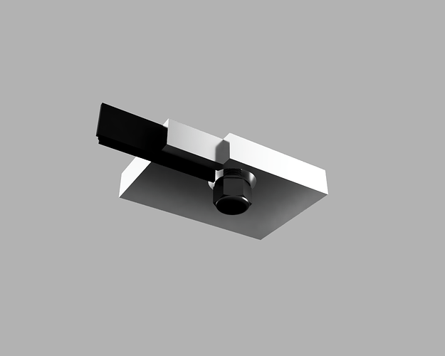

Alright. This is an idea I had for the belt clamping mechanism. It’s partially based on something Aza mentioned.

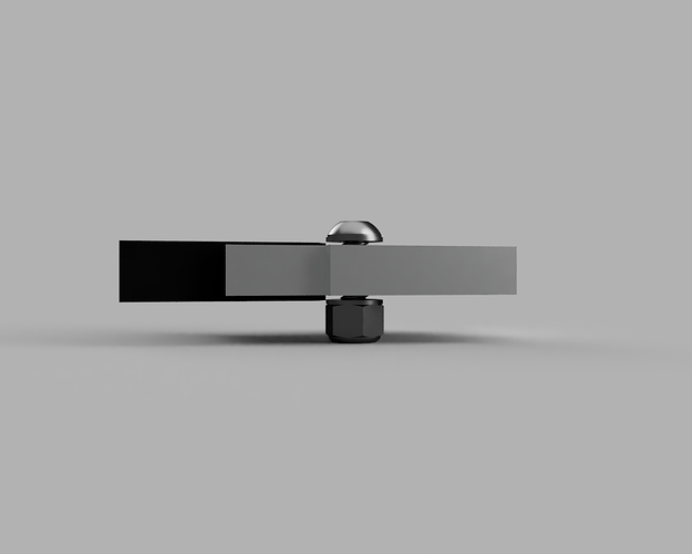

The idea would be to loop the belt back on itself through a groove. An M3 bolt would be pushed through the hole left by the belt. Washers and a locknut would then be used to slightly squeeze the belt, locking everything in place. The gap in the metal plate that the belt slides through could be loose enough to not have to really fight the belt getting it in there because the bolt squeezing everything is the real holding mechanism.
The part, as designed, is in 5mm plate. Hole size could be adjusted. I was originally going to try this on my design for the current core, but didn’t take it all the way and ended up going the other route.
You’ll have to pretend that the 2 belts are connected through a loop. I didn’t want to try to figure out how to modify the McMaster-Carr part to make it do that.
Thank you super clear now.

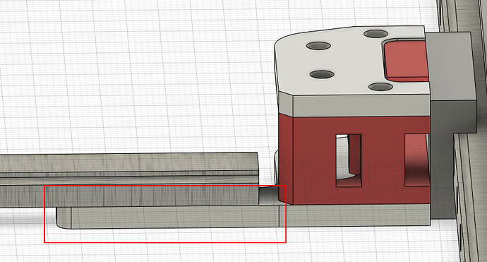

Okay, I see what you are saying for the two plates, they are needed, unless it is offset even more. With the bed floating and all the room we have (~4" on all sides). I think it would be nice to do just one plate in this case. That just means the bed is slightly more asymmetric, it does not waste any X rail room.
I have seen those belt clamps.
The distances are tiny so far it feels great.
That red part was just a minimal example. If can be attached to the bearings itself (without the plate, which kinda seems better) or with the plate and longer M3’s.
Yup, I should have read ahead. That last answer covers this. A one or two piece single printed part…oh I have an idea…is better than adding a metal plate for the sake of adding a metal plate.

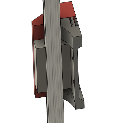

If you were to use printed only this whole assembly would be one part. That would mean that red upright at the end of the rail is supporting it and is only 1.5mm from the end. I will say judging by the printed vs plate option for the LR3 XZ…no one will print it.
This part is only fighting gravity, from both ends, front to back is where the mass is multiplied by acceleration.
One side of the balls is going to be forced down, the other is going to be pulled up in either orientation. Ideally we could put the extruder on top of the bearing but the direct drive hot ends are just not long enough for this.

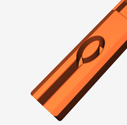

From the top and in between the two parts. This method does not require it to be pulled into place so getting tension right is a non issue. Because it wastes none of the adjustability. With a two part design, the belts are locked in and can not come out.
My reasoning for them being in a printed part is milling that tight of a tolerance ~2.1mm or so slot in metal would not be easy or cheap.

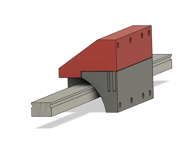

So here is a more complete thought on the core I had .
To get to the belts the top would need to come off, rare but might happen. The bottom half stays in place with the lower extruder screws. To the top comes off with two extruder screws and two bearing block screws.
With a generic block like this the holes can be moved or we can add a bunch of common hole locations to the one block.
The belts will come in and wrap a round a post like the previous reply, and one could go all the way through if we think that is easier?
For smaller hot end and extruder two piece systems the mass can be moved even further towards the center after the belts get terminated. This is probably nice to have to add some stepper cooling on the one piece extruders as well.

Vertical means a single plate with holes that will need to be added (if you are machining the plates yourself that is no issue, If I offer plate sets you are hand drilling), offsetting the extruder is fine so all the screws can be accessed. It also means we lose the flat XY plate connection. Most likely a purchased belt clamp part.
Horizontal means, a printed part. That printed part would also need to be modified for any extruder that does not already have holes included. We get to keep the XY plate mount and the belts will get integrated in.
So it seems pretty close. To me the major factor is that plate, it sounds like you two are a bit more concerned with the extruder mount?
It is a close one. Everyone, feel free to weigh in. It is close, they both have advantages and disadvantages. Which do you prefer? If you are making one what seems like they way you want to mount your extruder and rail?
The belt slots are not set in stone, they can currently still move in or out, or wider apart, maybe even closer. So don’t worry about the part that looks thin, I just eyeballed it.
