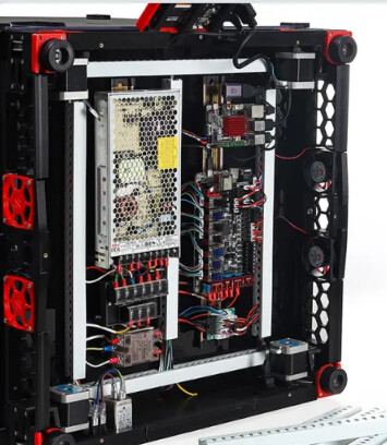

I hate bottom mount electronics. I like the clean look of the din rail mounted electronics in the Voron.
I almost certainly would make an extra side or back chamber to house my electronics, so I can access them, even if it is currently printing, as well as easily cool them
Eating with family, so briefly… As you know my electronics sneak in under the Bed. Works, keeps back and sides clean, but not as accessible as side/back mounting builds. So…
Thoughts on CNC’d sheet metal or ACP based electronics enclosure that neatly folds into dimensions that fit inside the USPS box you normally ship. Ideally enclosure snuggly fits like a glove in your shipping box with the hardware packed within. Was thinking about this with quick connects for my build but never made happen.
That picture is exactly what I was thinking, which is the bottom LOL
I have din rail coming for my E5+ conversion so I will get to see first hand how that goes. All of my printers except the V4 have bottom mounted electronics and I cant say that’s ever been a real issue
Exactly there is currently a ton of room 3+" on two sides and 4" on the third. I am far more concerned with minimizing that.

I think the original comment was meant to show that this is a great example of how to do the electronics, aside from the fact that it’s in the worst possible place for accessibility.
If this were a product, I’d say bottom mount is great. Given that this is DIY, I’d personally prefer to err on the side of accessibility. Then again, my solution to damn near everything is ‘get the scope’, so I’m probably not a reliable data point.
Yes, in my mind, my wiring always looks like this. In reality, not so much
Oh I know. I was just messing with Mike
I don’t disagree. I was thinking do a bottom and mount the din rail facing up. Then have a false bottom to that which would be what is seen as the bottom of the printer from inside. Mostly I’m just thinking out loud
This is my current thinking as well. I have built tons of equipment with DIN rail mounting and various cable trays and terminal blocks/boards to tidy things up. It makes maintenance and upgrades so much easier in my opinion.

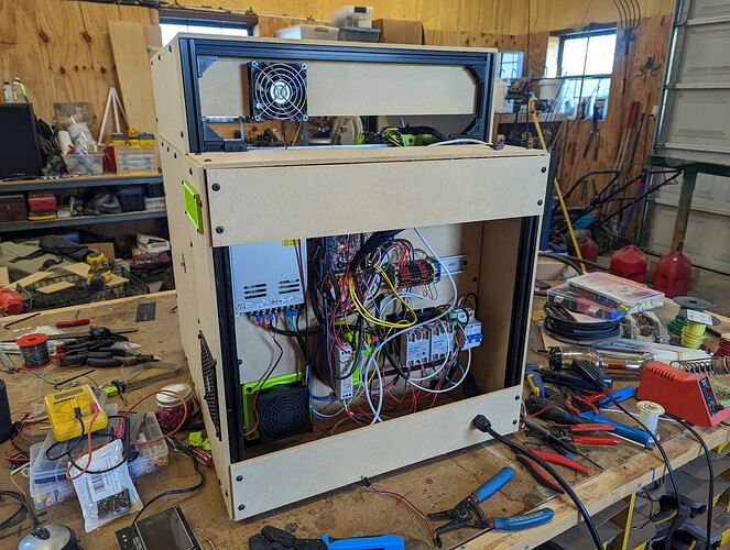

Slotted ducting and extra length on cables like that photo is how the industrial world goes around. Just stuff it all in, cram the cap on and call it a day. I’ve shipped more than a few products using that approach.
Having a nice flat accessible space for like that on one side or the back would be the ideal from a maintainability/troubleshooting perspective, for sure. I don’t really know how that lines up with other constraints, of course.

With the goal of an eventual full enclosure, the electronics on my v4 are on the outside ( left) and some are din rail mounted. The vision was to put them under the bed, but after working around the moving bed and cleaning up under the bed area, and realizing that all the standard cable lengths would require extensions (partly because of the 400 mm z), I don’t want the electronics down below. An air filtration for abs printing and space heater could go down there, but for now it is dead space. I added 3 inches for that and 3 inches up top for a future lid that could allow the filament feed tube to move with the gantry.
Since I may not be able to keep up with this in real time, I would like to ask about the possibility of shrinking the dead space around the bed inside the frame. If it isn’t possible, then some false wall ideas would be helpful to better use the space for electronics and filament. Optionally enclosing and heating that inside area won’t be used for housing electronics or filament on my machine, so minimizing it would be ideal. Standard cable routing and bundling would be useful to aid with enclosing the top. The sides are pretty easy to cover and help greatly with racking and flex.
