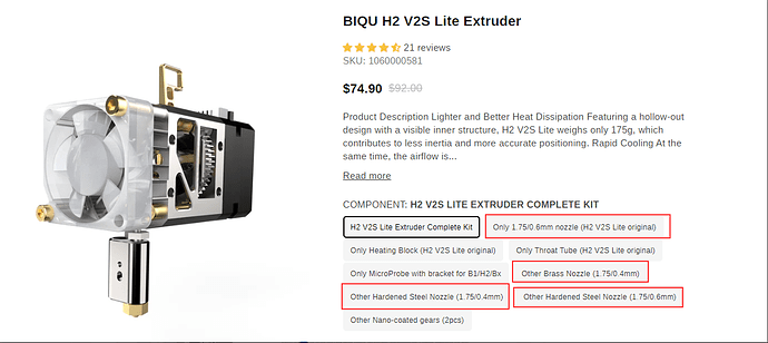

They do sell 0.4mm nozzles on their site now, as well as hardened steel ones in 0.4 and 0.6
The video you linked previously said the nozzles in the book are listed as M4 nozzles.
Quick search I found these: Phaetus XG Brass Nozzles
I don’t know if those are the same, but it calls them M4…

Looks like I bought the wrong extruder. I just got the v2s. Oh well. It’s going on an older bed slinger, so probably wouldn’t get very fast anyways.
So does the s in v2s mean slow?
I see a lite upgrade in my future…
I have no idea. I didn’t really do any research and just grabbed this one. I really need to learn to read more or I would have grabbed the lite instead. I bought mine on amazon, so I could take it off the printer and return it.
same. I bought it because it was small and budget friendly. I’m past the return window. It is working great though, but my goals of speed may not be realized with it, however after looking at Ryan’s work with it, there is plenty of headroom before it runs out of capability from where it is currently operating.

It appears that the only difference between the two is the heater. most of the high flow systems have a longer heat tube… I wonder if that part can be swapped and get the right heater for it to go high flow.
I know I have found the parts to change over the lite to a standard volcano nozzle which includes a new throat and hotend. It might work on the standard h2 V2s but I’m not sure and don’t have one to be able to test it.
